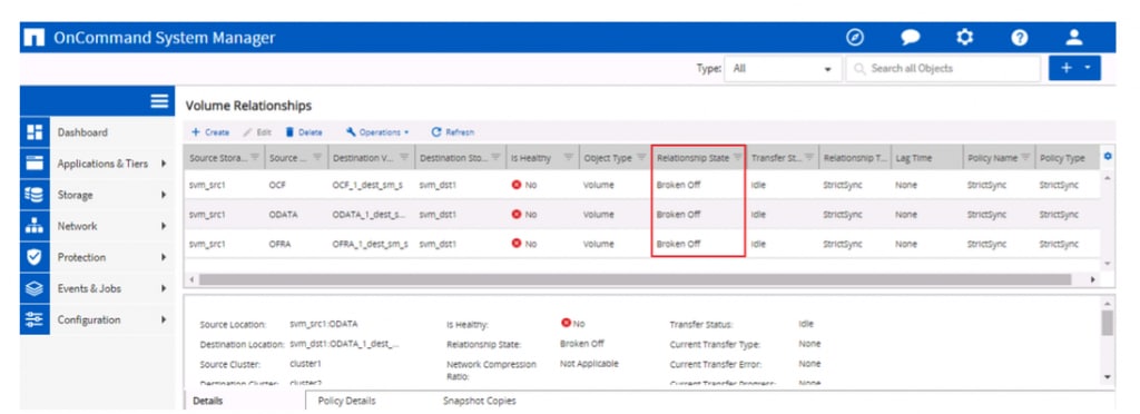

As part of the failover process, the Relationship State of the SnapMirror relationship is Broken Off, as the following screenshot of the NetApp ONTAP® System Manager (formerly OnCommand® System Manager) Volume Relationships dialog box shows in destination cluster.

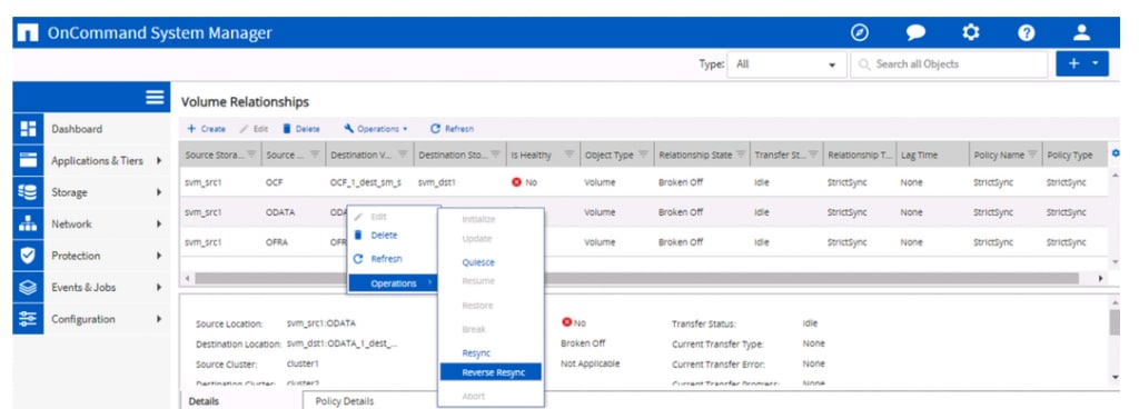

2. In ONTAP System Manager on destination cluster in DR site, confirm that for the cluster, Protection > Volume Relationships > Relationship State for the SnapMirror Synchronous relationship shows as Broken Off.
3. Highlight the relationship and select Operations > Reverse Resync. This option resynchronizes your system without the baseline transfer.

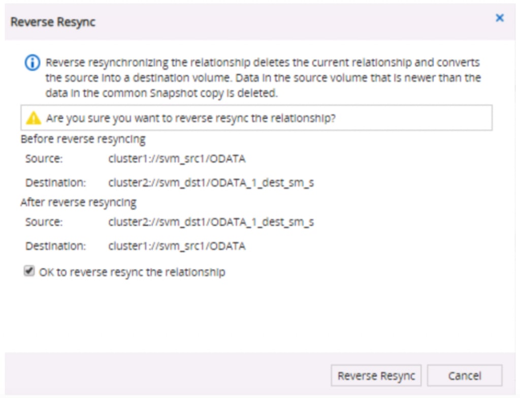

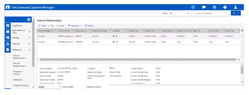

4. In the dialog box, select the checkbox for OK to Reverse Resync the Relationship. Then click Reverse Resync.5. The Reverse Resync operation resynchronizes the changes in stored data from your secondary to your primary storage system. The protection relationship will now appear on source cluster with source and destination volumes interchanged as follows:6. You need to then configure the volume for data access. NAS clients and SAN hosts can access the data from the reactivated source volume on your primary storage system as follows:
