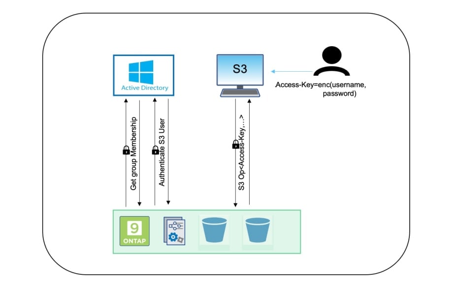

With ONTAP 9.14.1, there’s no need to create and manage local S3 users; they can use existing AD credentials, username and password, for authentication. The application can present encoded AD credentials as Access Key ID in the prescribed format. ONTAP uses the provided credentials to authenticate a user with Active Directory using LDAP fast bind mode. With fast bind functionality, ONTAP sends user credentials to the LDAP server through a secure connection. The LDAP server then validates these credentials and tells ONTAP whether the request is from a valid user.

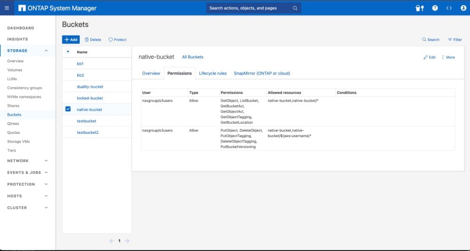

To enhance access control and manage permissions effectively, you can now specify an Active Directory group in the bucket policy. This integration allows you to leverage the existing AD infrastructure to grant or deny access to S3 resources based on group membership. By associating AD groups with S3 bucket policies, you can streamline user management, simplify access control, and make sure that users have the appropriate level of control, while maintaining a centralized and organized approach to permission management.
