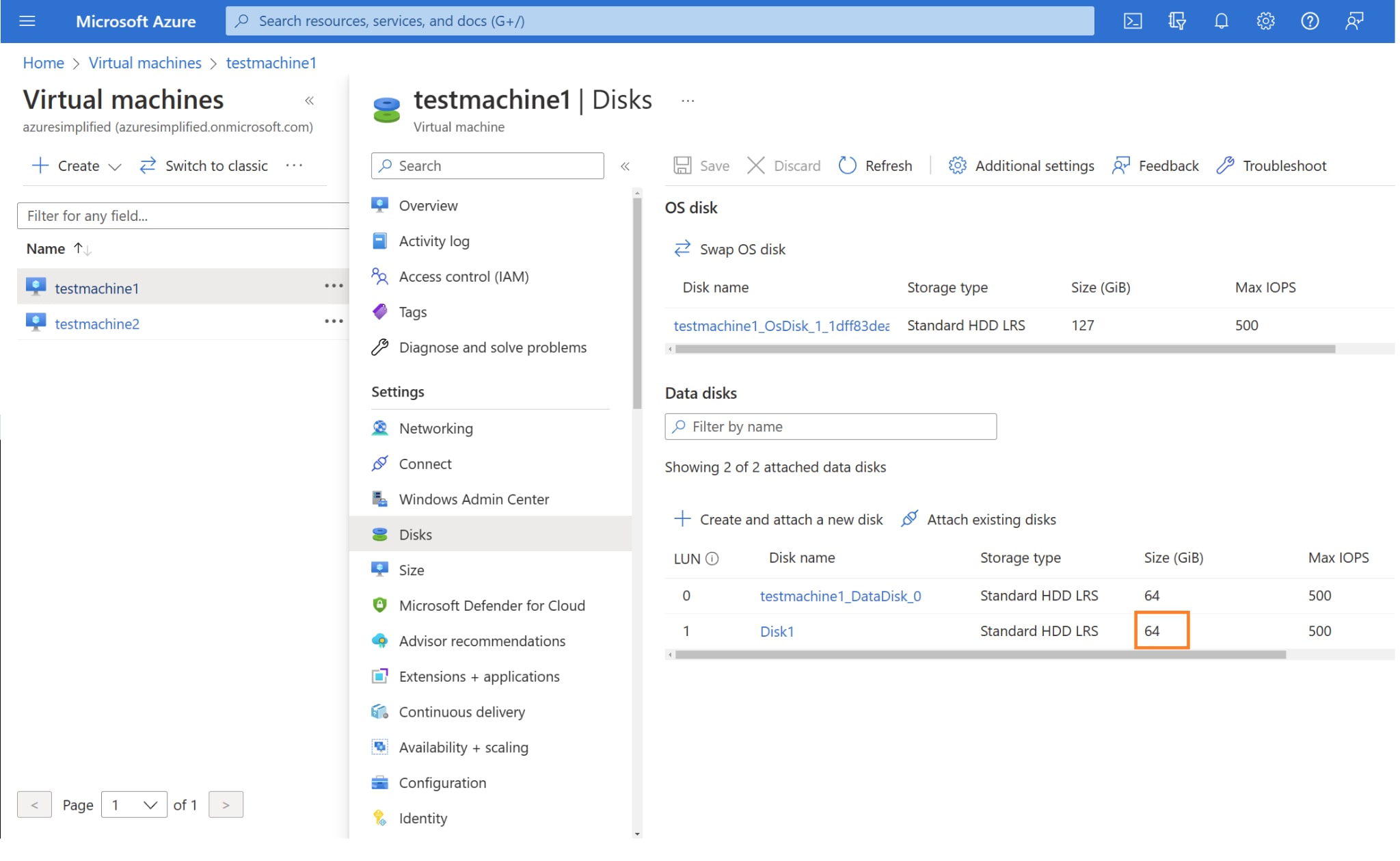

  4. To confirm the disk resize, browse to the Virtual machine -> Settings-> Disk. You will see that the disk size is updated to 64 GB.

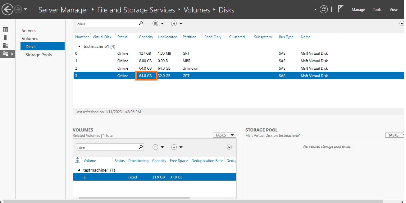

  1. Connect to the machine using the Remote Desktop Protocol (RDP). Open Server Manager-> File and Storage Services->Volumes->Disks. You can see that the disk has a capacity of 64 GB.

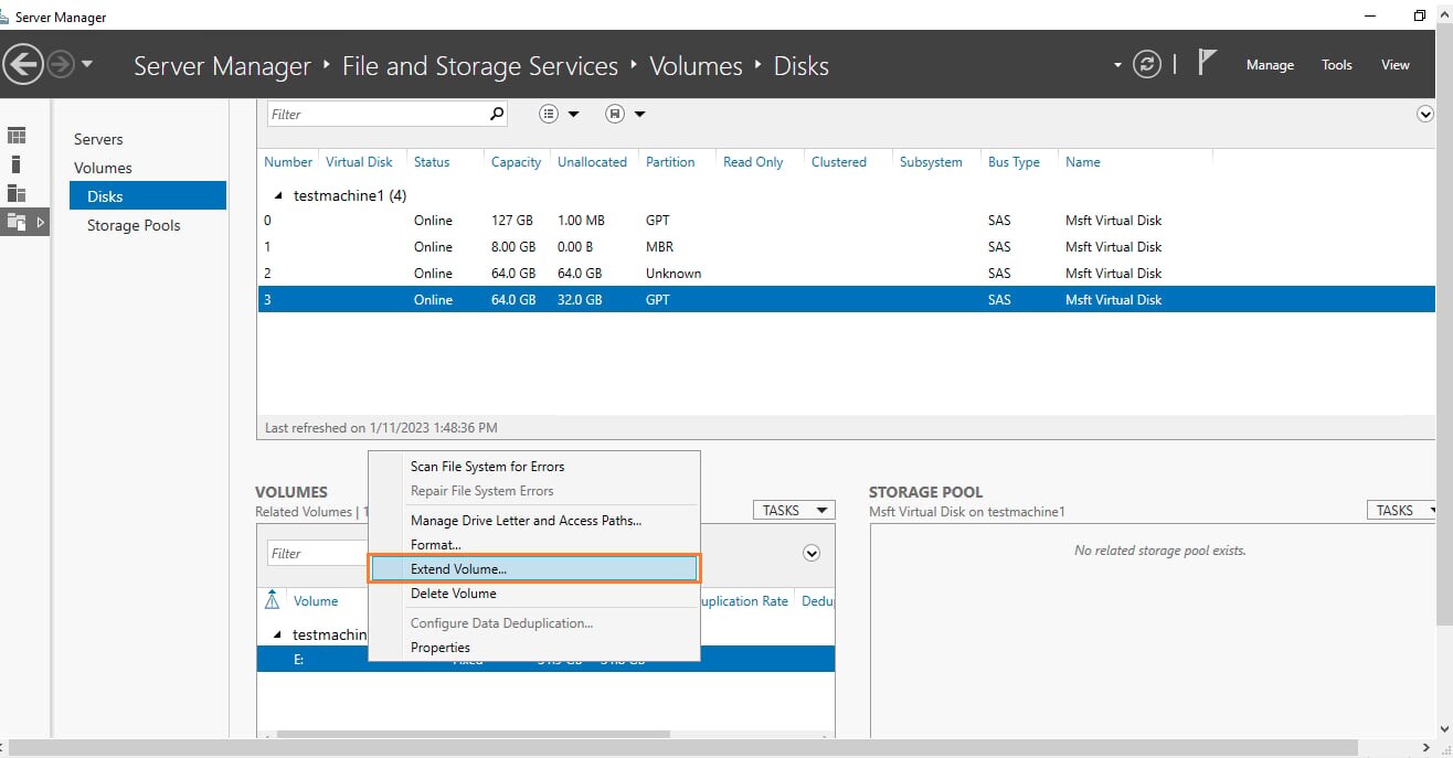

  2. Right click on the data disk drive and select “Extend Volume” to continue.

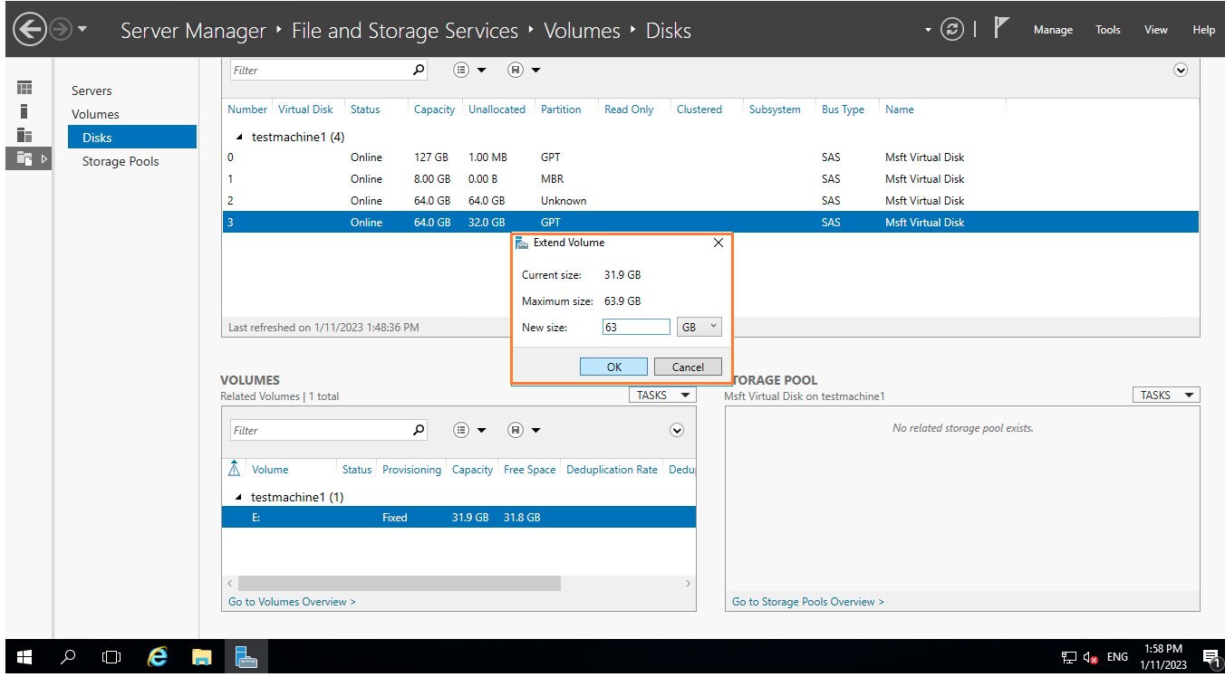

  3. Add the new size of the disk and click the “OK” button.
    Add New Disk Size
  4. You can see that the drive size has increased in the operating system and is available to use.

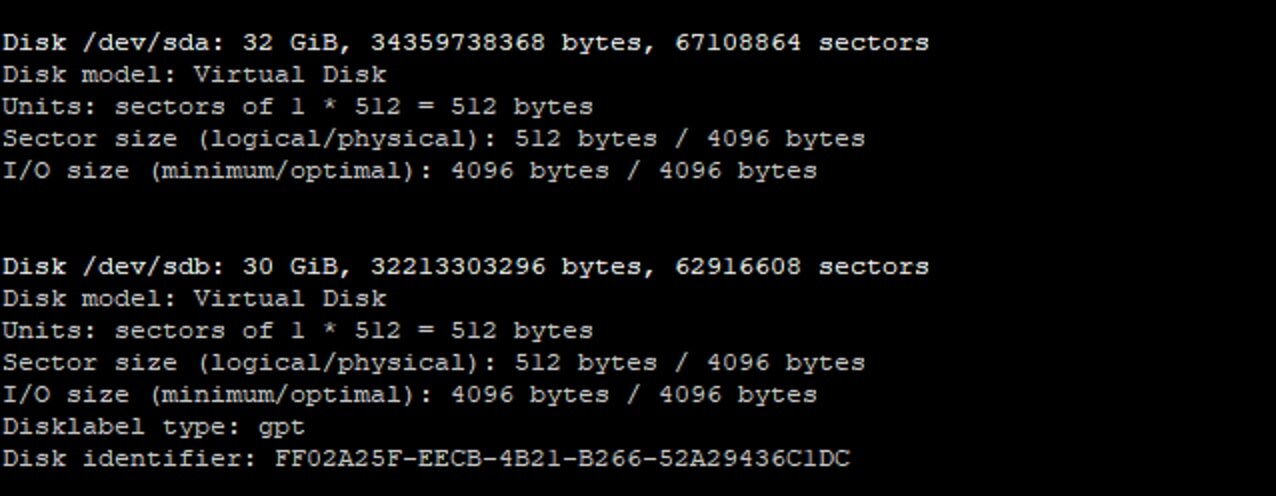

  1. Check the available disks of the Linux machines using the following command:
    sudo fdisk -l
    Check available disks

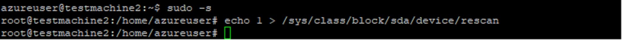

  2. Once the disk size is updated using the steps discussed in the section above, you can run the following command to rescan the disk:
    #sudo -s#echo 1 > /sys/class/block/sda/device/rescan
    Rescan Disk
