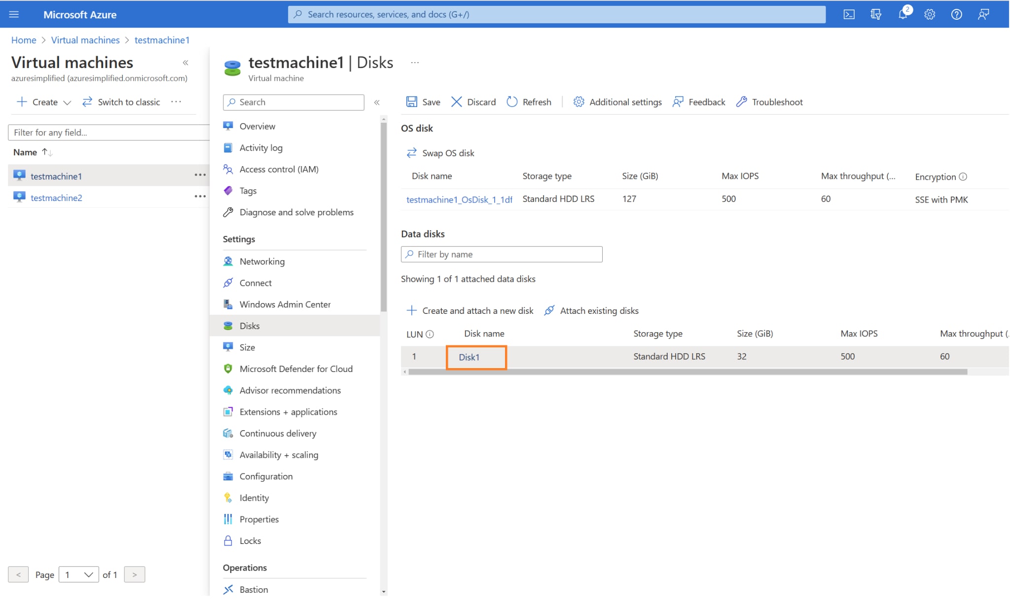

  1. In the Azure Portal, browse to Settings->Disks and click on the disk that you want to resize.
Azure disk resize

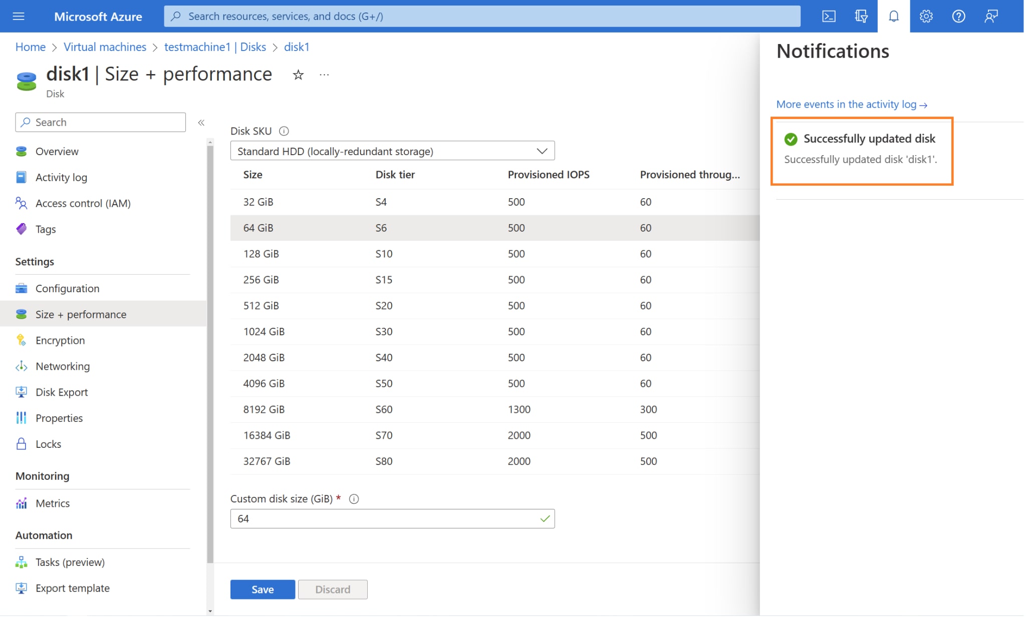

  • When the disk details window appears, click on Settings->Size+Performance. Select the new size of the disk and click on save. In this demo, we are selecting 64 GB as the new size of the disk.
    Note: You can also type in a custom disk size, if you need less than 64 GB, but do note that charges will be incurred for the predefined disk SKU size irrespective of the custom size being used.
  • Size Performance
  • Once the resizing is complete, you will receive a pop-up notification.
  • Size Performance Popup Notification

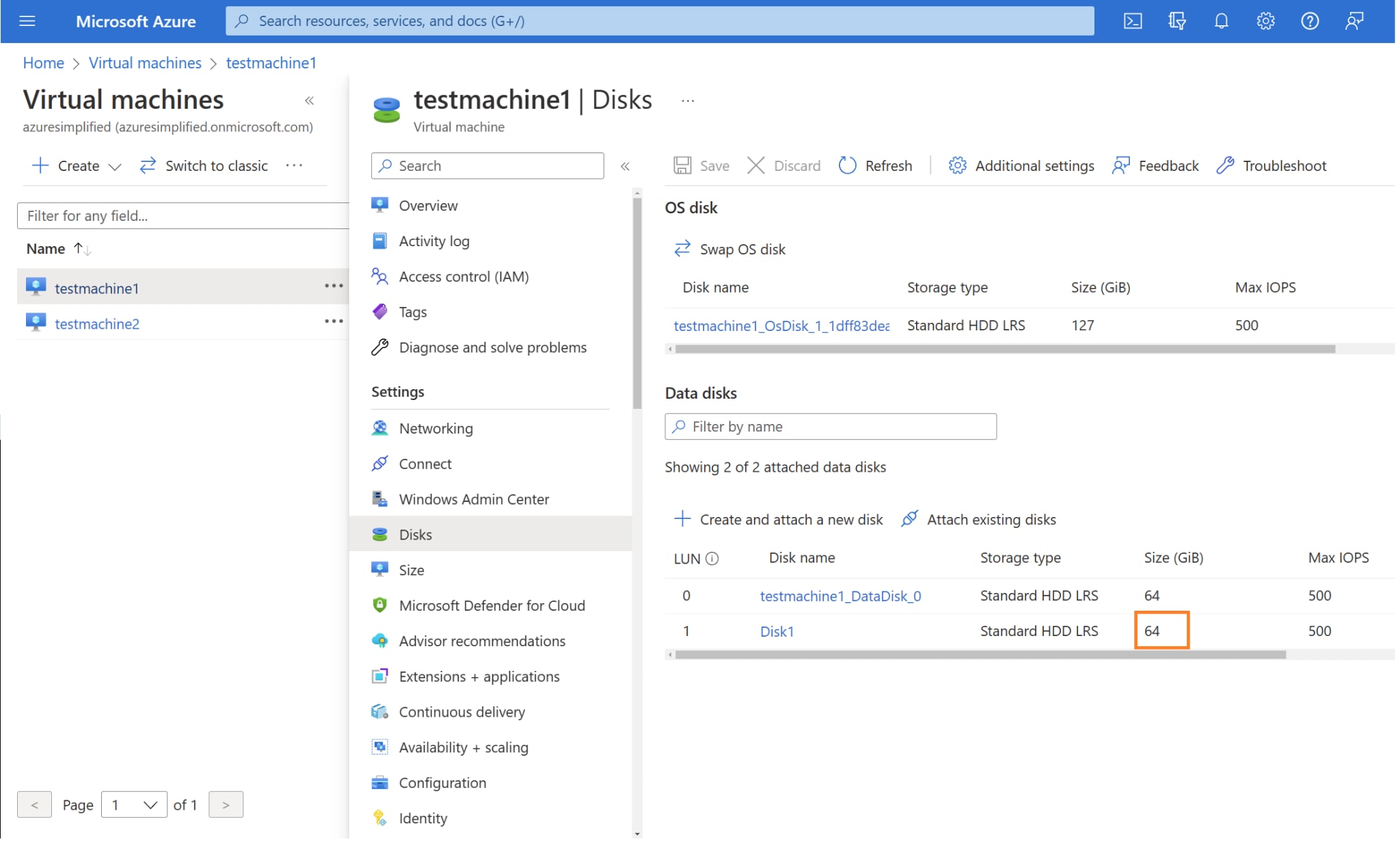

  • To confirm the disk resize, browse to the Virtual machine -> Settings-> Disk. You will see that the disk size is updated to 64 GB.
  • Virtual machine settings

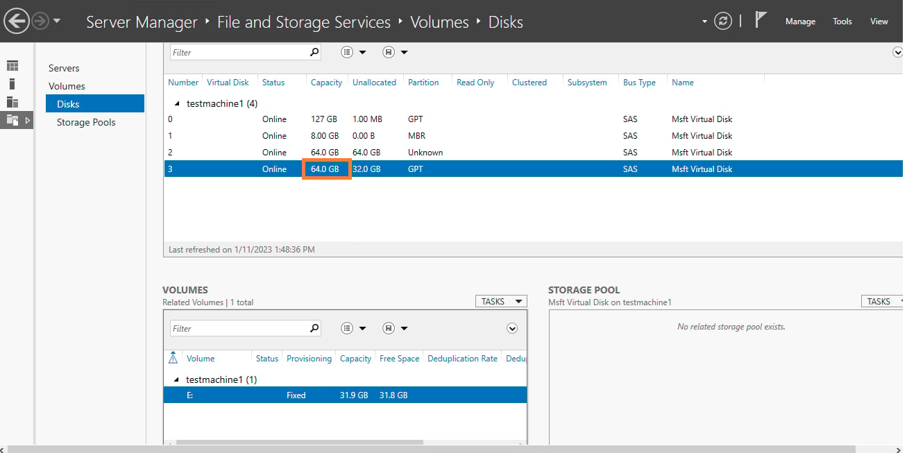

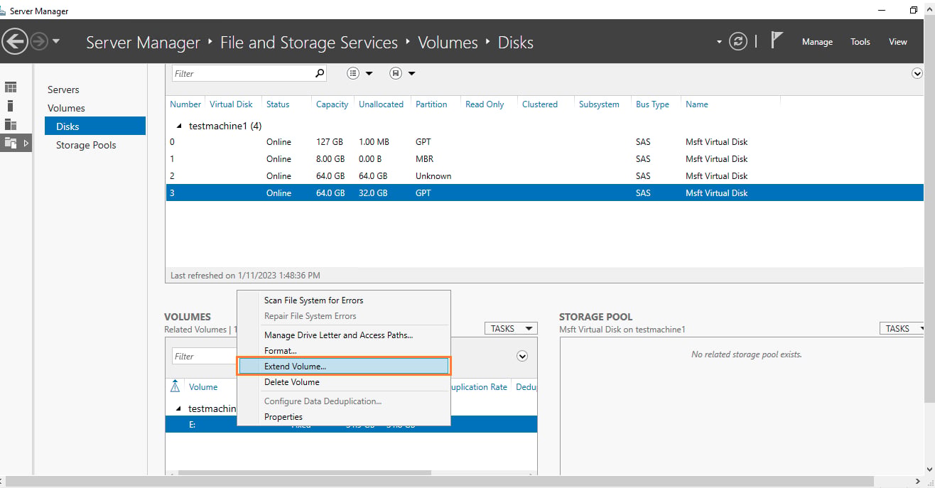

    1. Connect to the machine using the Remote Desktop Protocol (RDP). Open Server Manager-> File and Storage Services->Volumes->Disks. You can see that the disk has a capacity of 64 GB.
    Remote-Desktop-Protocol-(RDP)

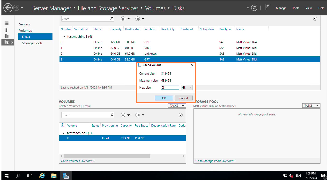

  • Right click on the data disk drive and select “Extend Volume” to continue.
  • Extend Volume
  • Add the new size of the disk and click the “OK” button.
  • Add New Disk Size

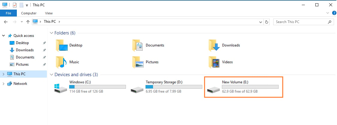

  • You can see that the drive size has increased in the operating system and is available to use.
  • Drive Size Increased

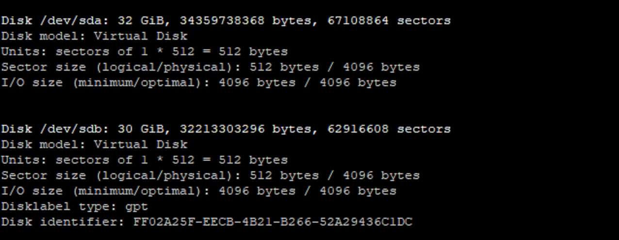

    1. Check the available disks of the Linux machines using the following command:
      sudo fdisk -l
    Check available disks

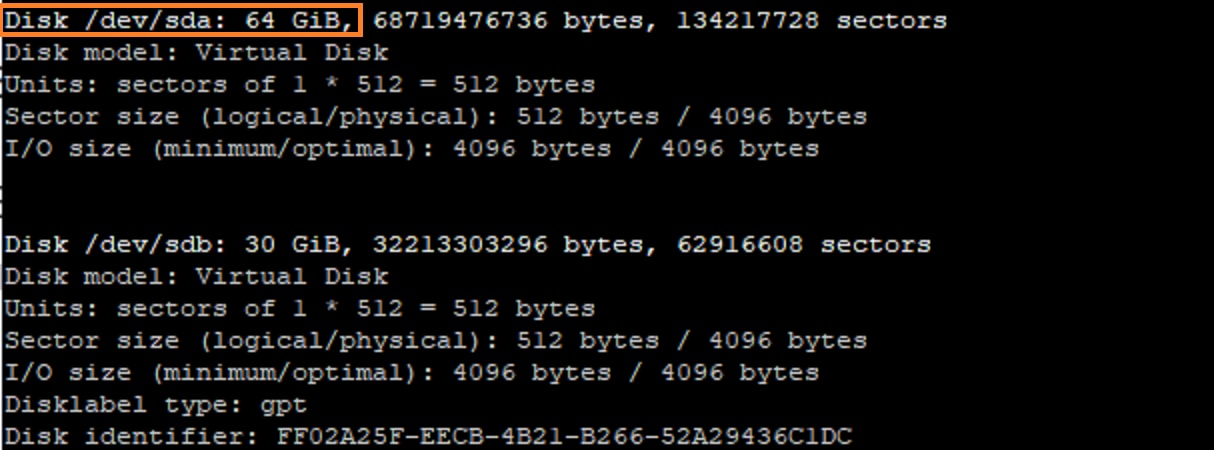

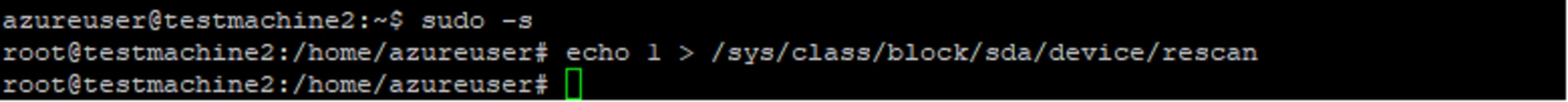

  • Once the disk size is updated using the steps discussed in the section above, you can run the following command to rescan the disk:
    #sudo -s#echo 1 > /sys/class/block/sda/device/rescan
  • Rescan Disk
  • You can see that the disk size has increased from 32 GB to 64 GB in the operating system.
  • Disk Size Increased
