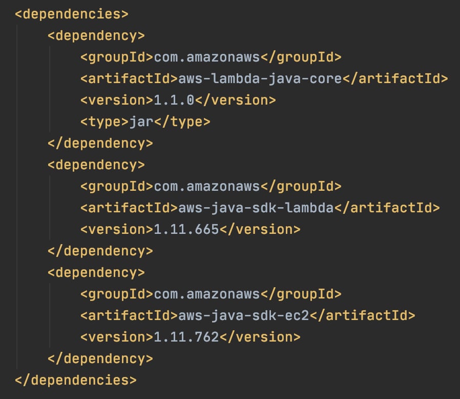

1. Before starting with the code, make sure you include the AWS EC2 Java dependency in the pom.xml file.
The dependencies in the Lambda function.Fig. 1: The dependencies in the Lambda function.
2. Once you have the dependency added and resolved, the AWS SDK for Java will be added to the project. This will allow you to create an EC2 client instance which will be used to get the list of unused volumes and also to remove these volumes.

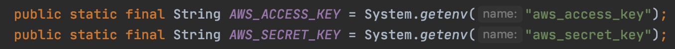

3. Next, configure the credentials for the EC2 client instance. There are two options for how to do this. Ideally, during development, the credential will be read from the system’s environment, as environment variables. The code for this is as follows:
Code snippet to get AWS access credentials from the environment.Fig. 2: Code snippet to get AWS access credentials from the environment.
There are two environment variables here. One of them is AWS_ACCESS_KEY and the other is for AWS_SECRET_KEY. This is good enough during development, but when you are deploying this to production as a Lambda function, you need to create an IAM role which will have the necessary permissions to run the Lambda function and not be using these credentials.

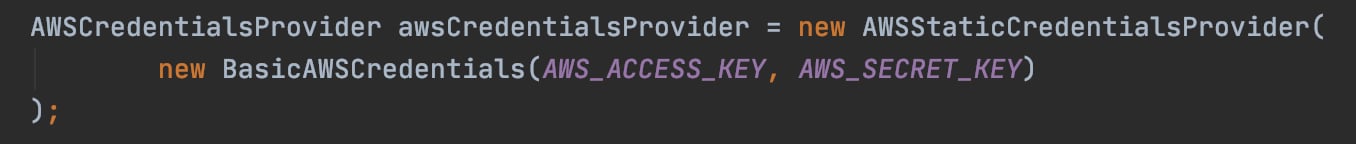

4. Next, create an instance of the AWSCredentialsProvider class to use as the credential provider:
Code snippet to create an instance of the AWSCredentialsProvider class.Fig. 3: Code snippet to create an instance of the AWSCredentialsProvider class.
This is also required only in the development phase, not for the production setup.

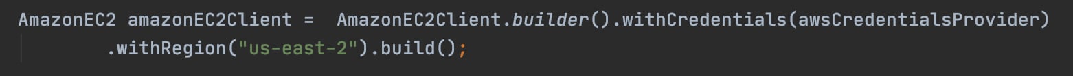

5. Using this credential provider, create an instance of the Amazon EC2 class:
Code snippet to create an Amazon EC2 client.Fig 4: Code snippet to create an Amazon EC2 client.
Make sure you change the region in the code snippet above to match your setup.

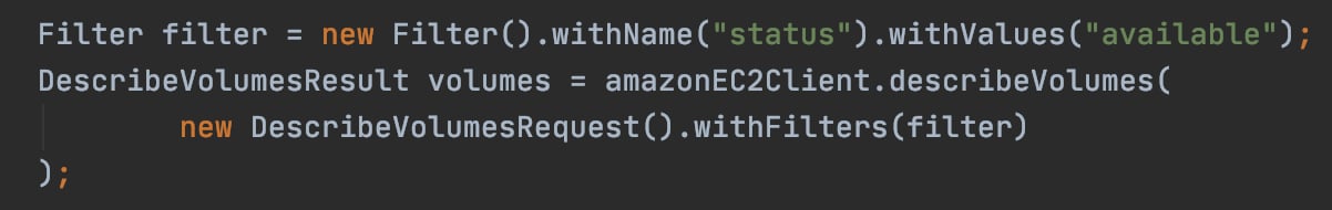

6. Using this amazonEC2Client, get the list of all the volumes that are unused. To do this, first create a filter so that the query returns only the volumes that are unused. For this filter, use the status field, the value of which will be available for unused volumes.
7. Next, call the describeVolumes() method on the amazonEC2Client object to get the list of volumes:
Code snippet to get the list of unused EBS volumes.Fig. 5: Code snippet to get the list of unused EBS volumes.

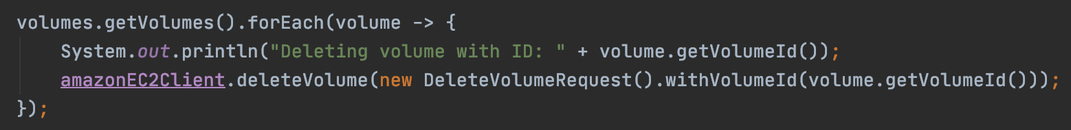

8. Next, loop through the result and just remove the volumes one by one:
Code snippet to delete a volume from the list.Fig. 6: Code snippet to delete a volume from the list.

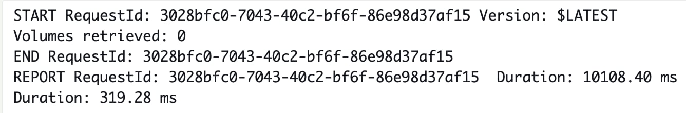

9. The code snippet above will also print out a list of IDs of all the volumes that were removed.
Output of the Lambda function after deleting two unused EBS volumes.Fig. 7: Output of the Lambda function after deleting two unused EBS volumes.
As you see, the Lambda function was able to fetch the list of unused EBS volumes, and the list contained two volumes. For debugging purposes, the Lambda function will print the ID of each volume before deleting that volume. You can modify the code to log any error that the function could encounter while trying to delete the volume. That would further help in debugging in case of failure.

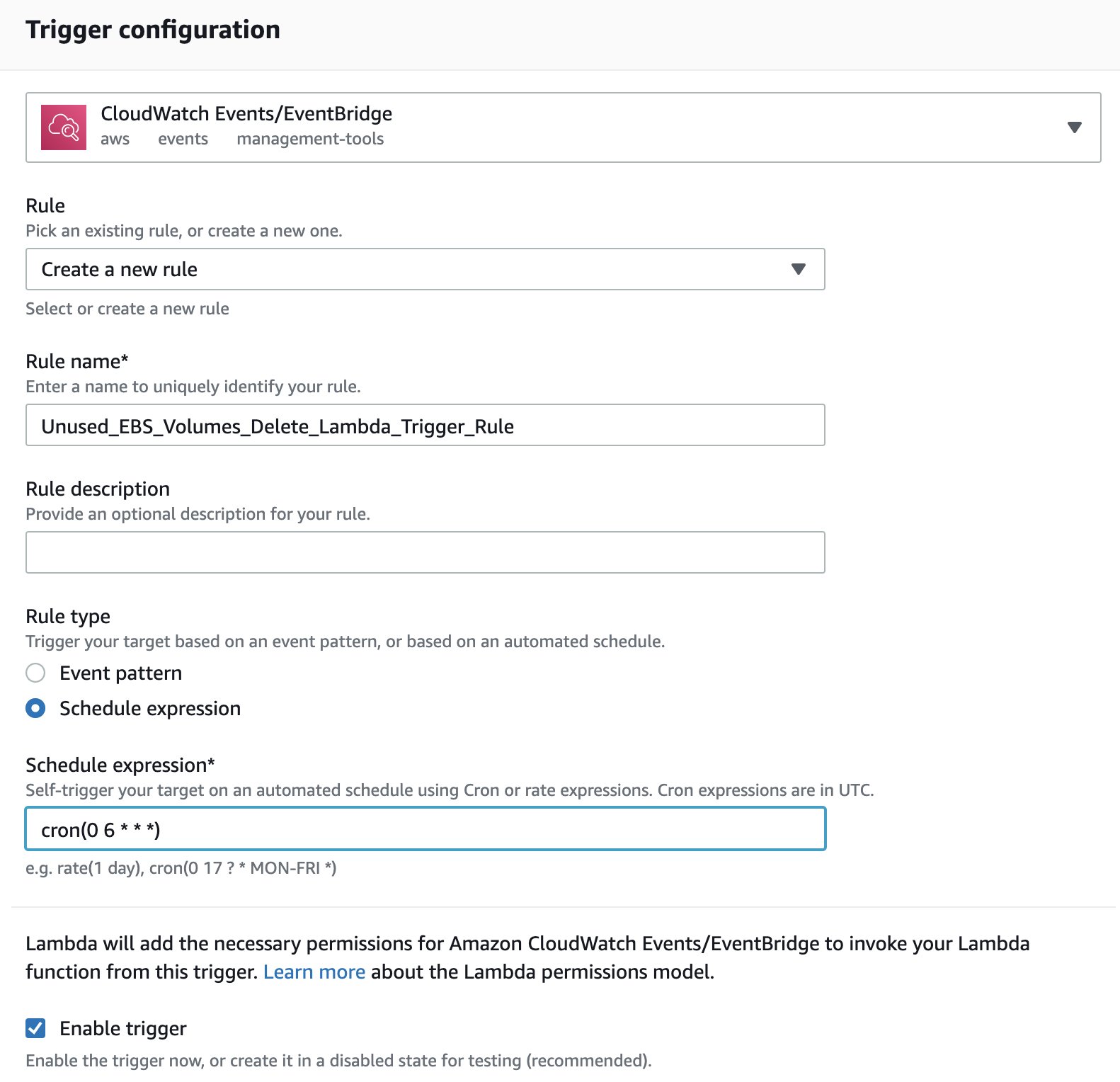

1. From the Configuration tab in the Lambda function page, click the “Add Trigger” button.
2. Select the “CloudWatch Events/EventBridge” option, as shown in the screenshot below.
CloudWatch Event Trigger configuration example.Fig. 8: CloudWatch Event Trigger configuration example.
3. From here, you can create a new rule with a schedule of your choice. As you can see from the screenshot, there’s an option in the Rule type section where you can provide a cron expression, based on which the Lambda function will be triggered.
4. For example, suppose that you want to trigger the Lambda function every morning at 6. To do this, the cron expression will be cron(0 6 * * *). Similarly, you can specify any cron expression which suits your business needs. And if a cron is not something you’re comfortable with, you can use the rate() function to trigger the Lambda function every day. For example, rate(1 day) will trigger the Lambda function every day.
5. Make sure the “Enable trigger” checkbox is checked before you save this trigger.
Once you do that, you will be all set. The Lambda will trigger automatically thanks to CloudWatch based on whichever parameters you defined.
