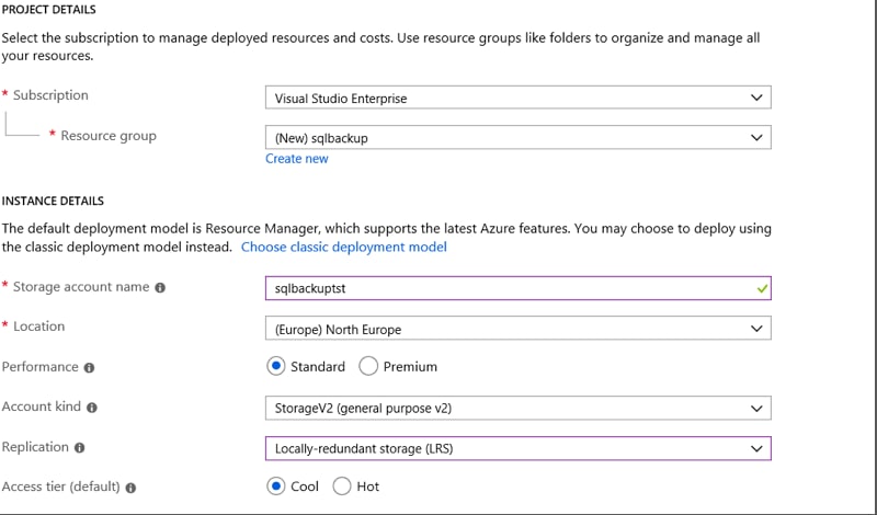

From the Azure management portal, go to “Create a Resource,” then select “Storage,” and then “Storage account.” Provide details such as resource group name, storage account name, and location based on your preference. Optimal settings for account type, replication, and access tier can be configured as shown below. When you’re done, click “Next.”
Backups 1

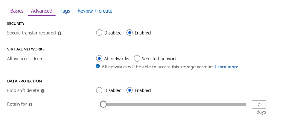

In the advanced section, configure the settings as you can see in the image below. Blob soft delete is enabled to ensure protection against accidental deletion of backup data from the storage account.
Backups 2

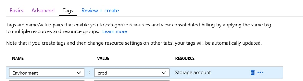

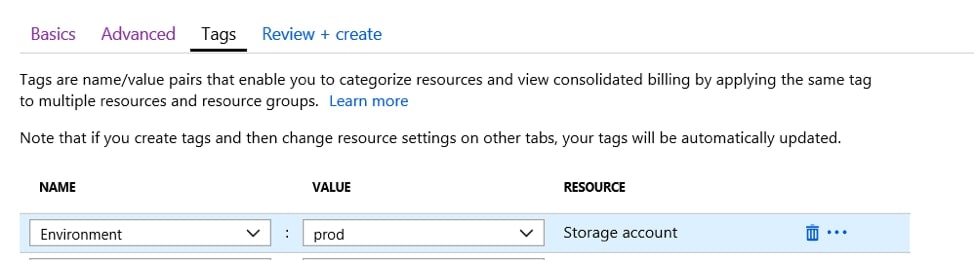

In the next step, add any tags that are relevant to your environment, as shown in the sample below.
Backups 3

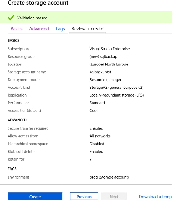

Review the settings and proceed to create the storage account.
backups 4

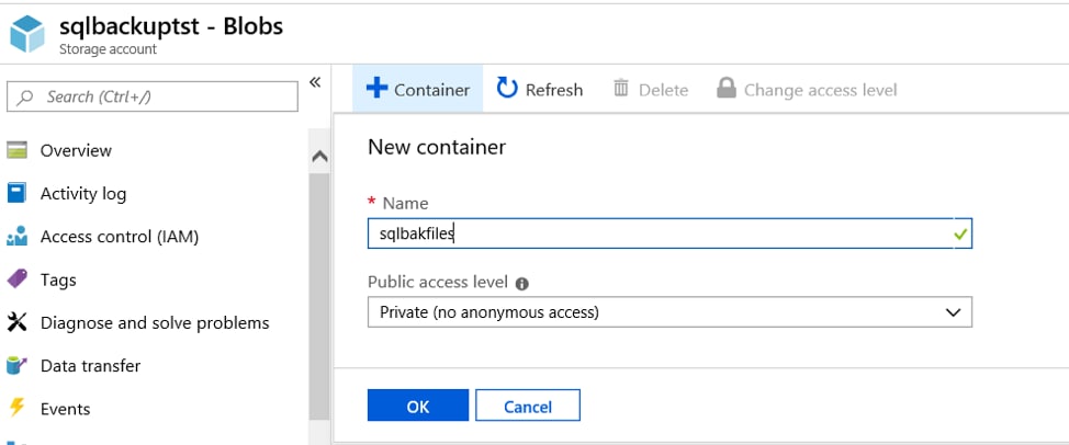

 Once the storage volume is created, provision a container for storing the backup data. From the storage account, click on “+Container.” Provide a name for the container and set its access level to private.
backups 5

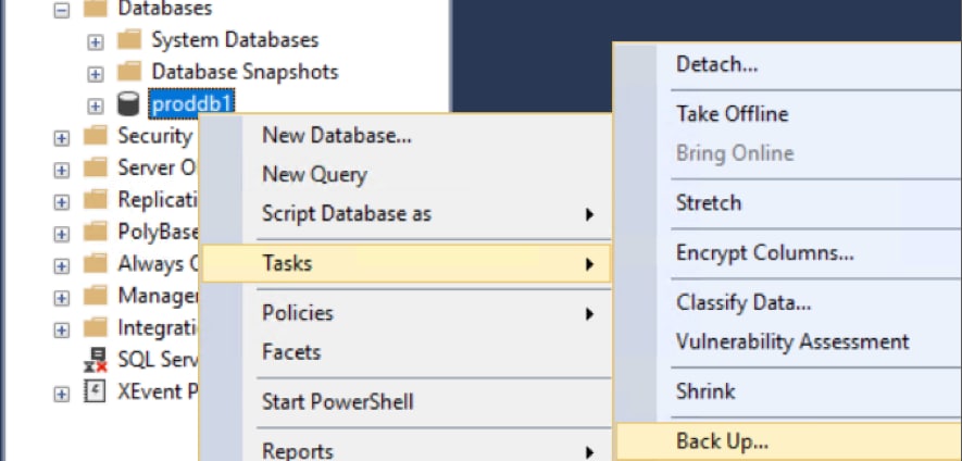

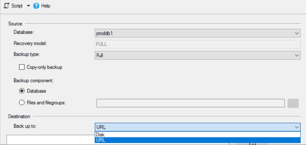

The following steps will show you how to back up a database. Use SQL management studio to connect to your SQL server. Right click on the DB to be backed up. Select “Tasks” and then choose ”Back Up”.
backups 6

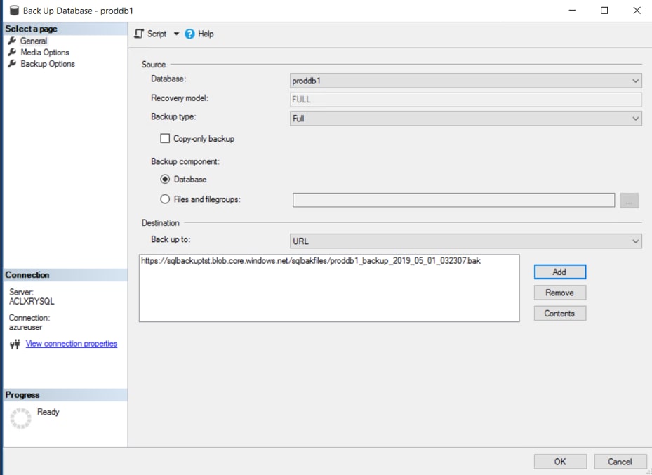

In the General page, select destination as “URL” from the drop-down menu.
backups 7

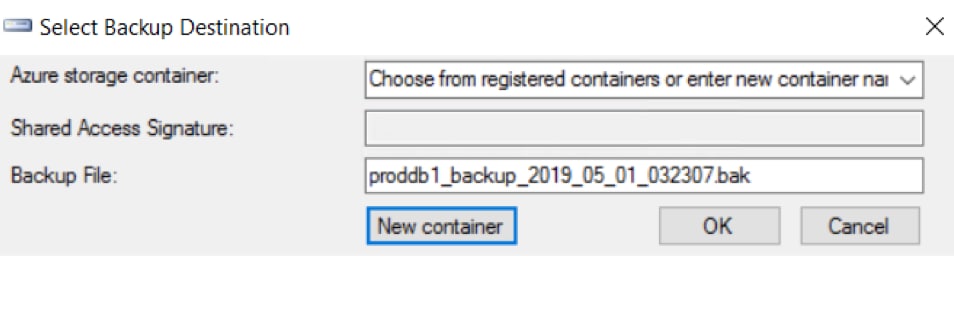

Click on “new container.”
backups 8

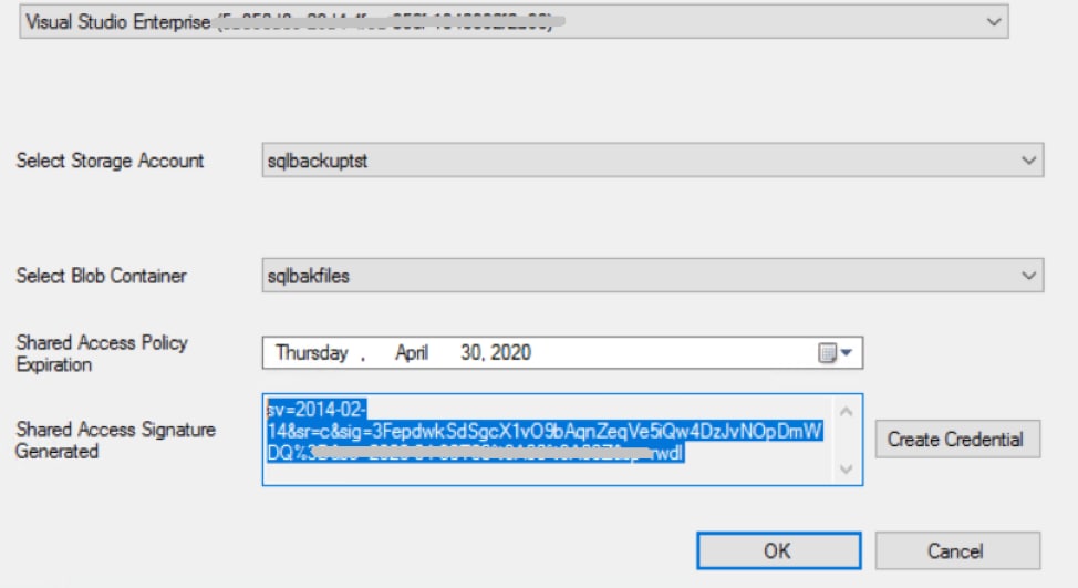

You will get a prompt to sign into your Azure subscription. Select the container we had created earlier and create a credential. Click “OK” to proceed.
backups 9
The backup URL will be listed in the wizard now. Click on “OK” to start the backup.
backups 11

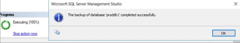

Once the backup is completed successfully, the following message will be displayed:
backups 12

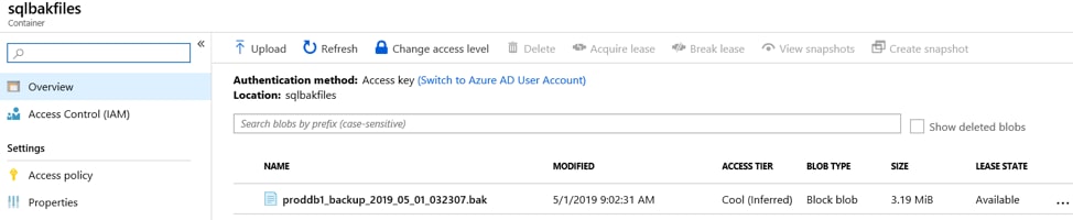

From the Azure portal, if you browse from the storage account to the container name, you can see the backup file has been uploaded:
backups 13
