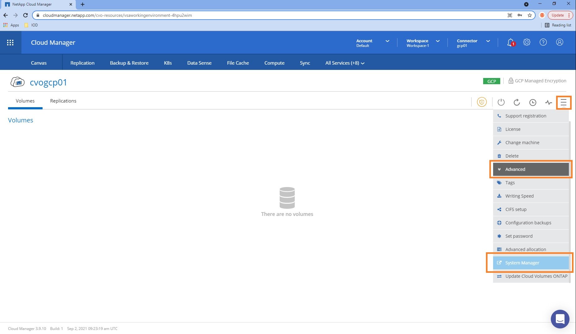

1.1 Head to Cloud Manager, which is the starting destination for all your cloud-based NetApp activities and services. On the Canvas starting page, find and select your preferred Cloud Volumes ONTAP instance.
1.2 In the Cloud Volumes ONTAP page, select the burger icon menu to the upper right, as indicated in the screenshot below.
From the drop-down menu that’s presented, select the “Advanced” option. From the options presented, select “System Manager” to open NetApp System Manager view.
OCCM Canvass

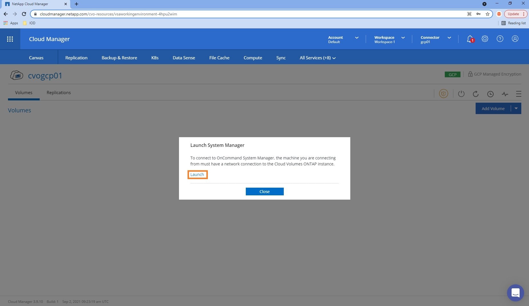

1.3 In the pop-up box, click on “Launch.” Make sure that networking connectivity is in place between your on-prem and cloud-based ONTAP instances.
System manager

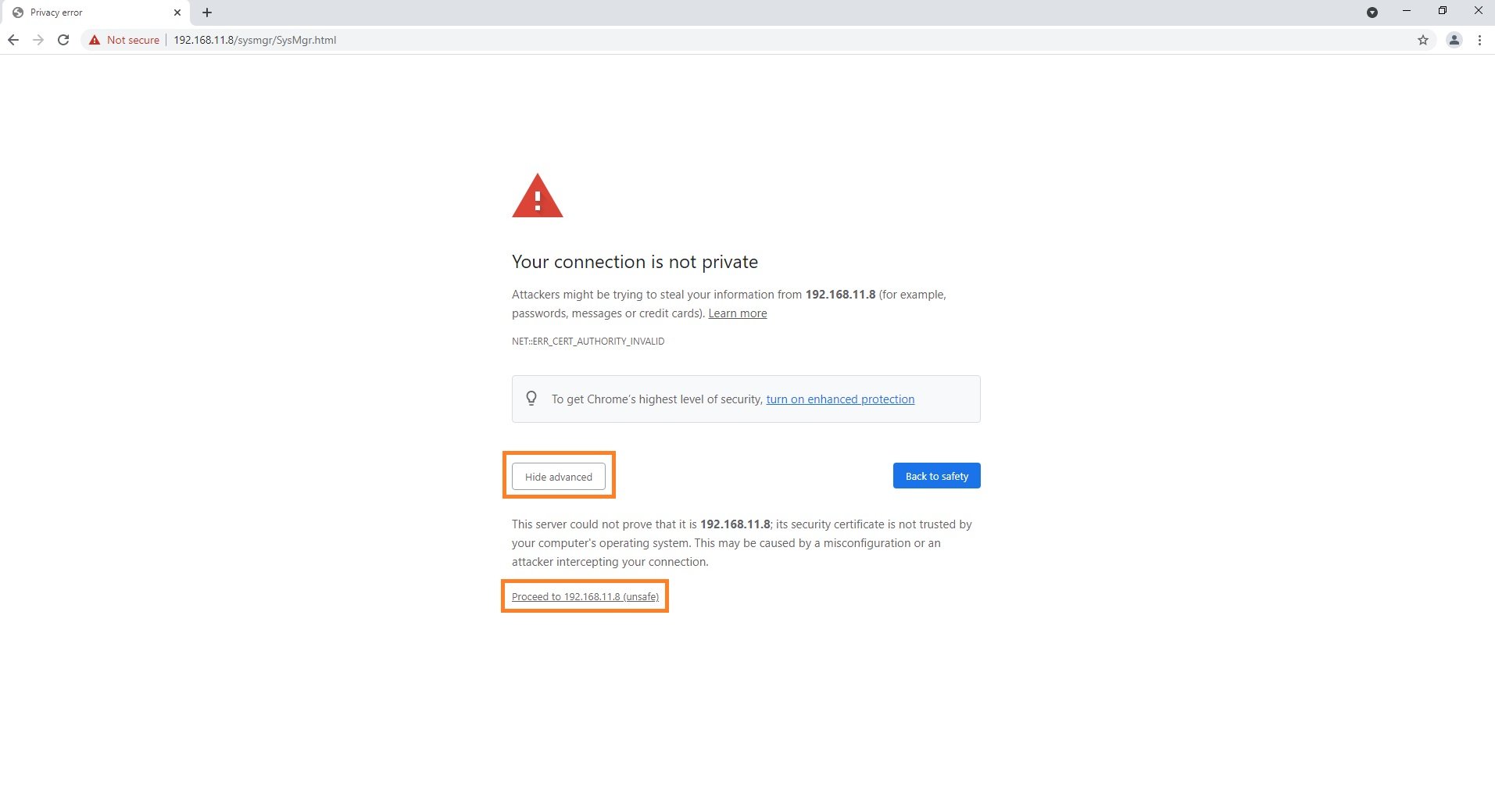

1.4 You may be alerted to an insecure connection because of default SSL certificates. Just click “Proceed” as shown below.
System manager-overlay

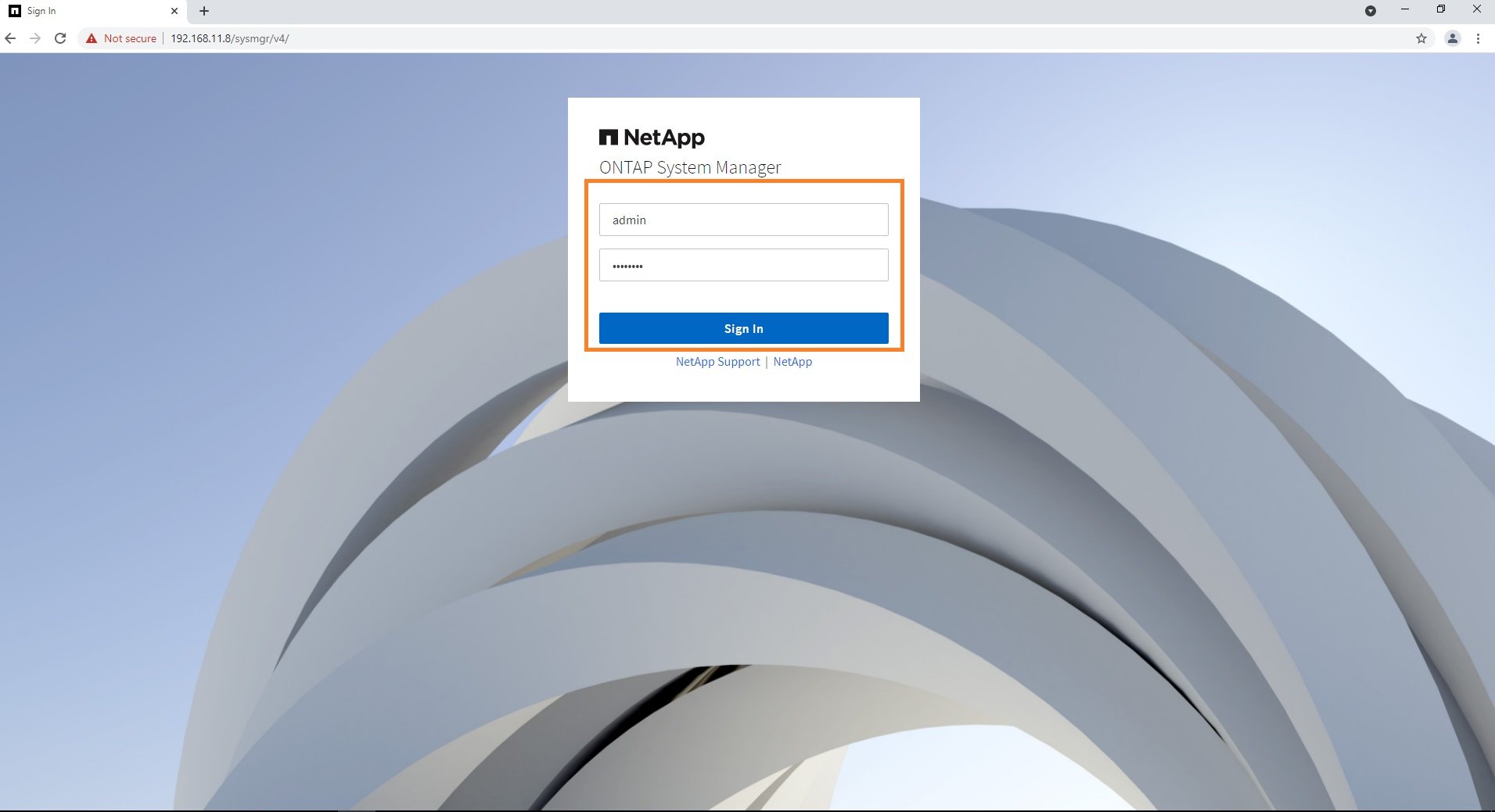

1.5 You will be brought to the login page for System Manager. Sign in with the appropriate credentials.
System manager_not_found

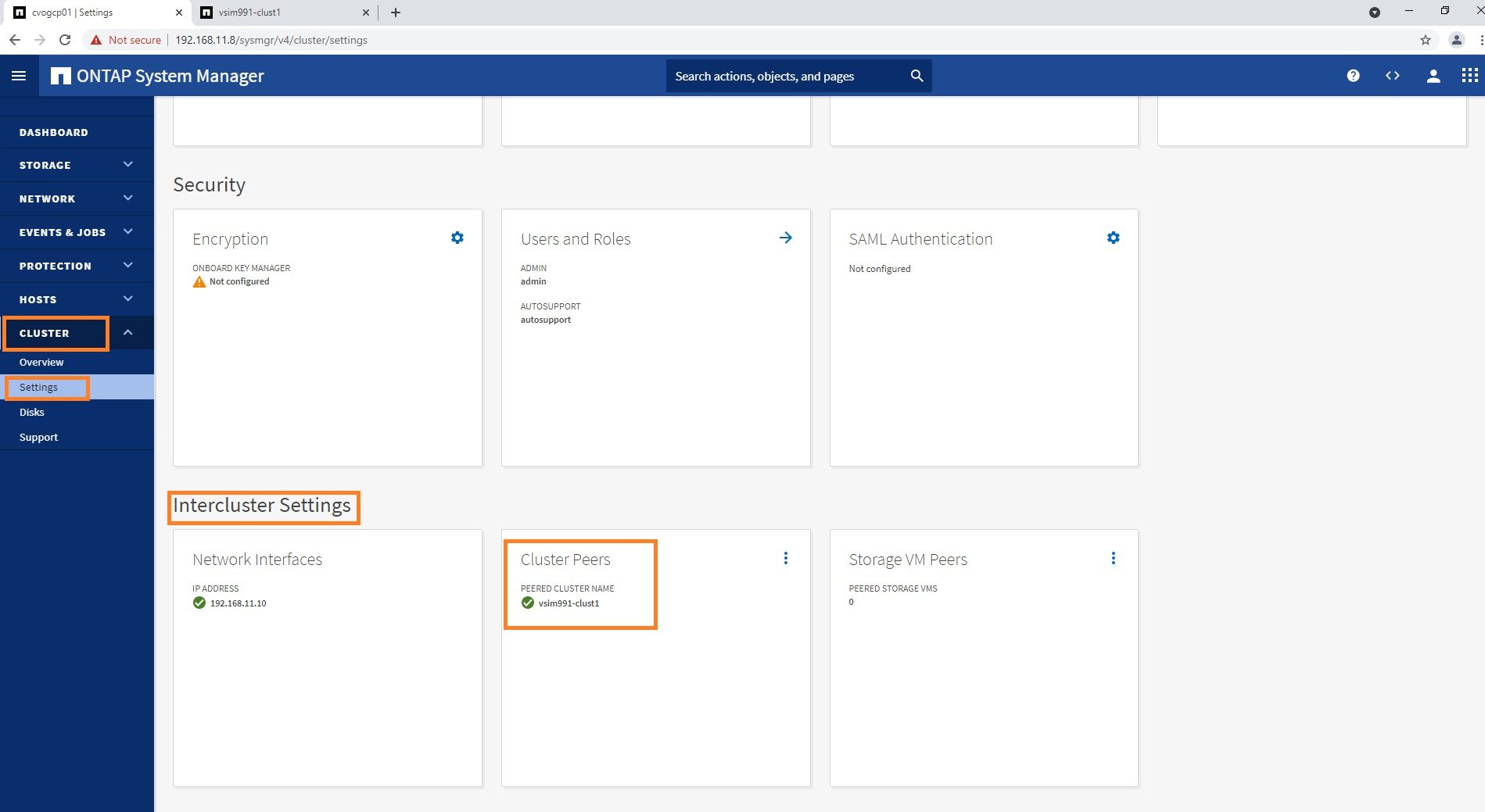

1.6 When ONTAP System Manager opens, head to the menu on the left-hand side. Find the “Cluster” option and click on it. In the submenu presented, select “Settings”.
System manager login

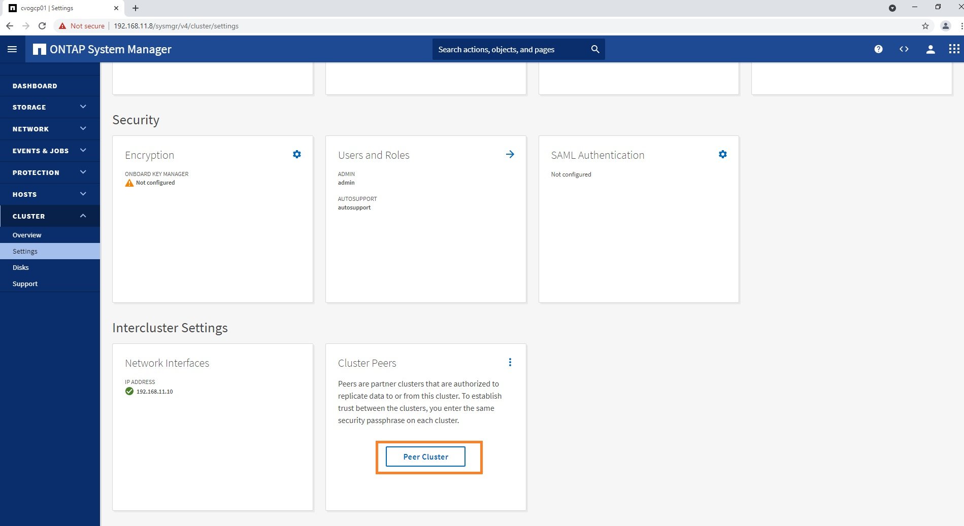

1.7 You’ll now be on the Settings screen. At the bottom of the page, you’ll find an option for “Intercluster Settings.” To start setting up the peering relationship, click the button labeled “Peer Cluster.”
Cluster peer

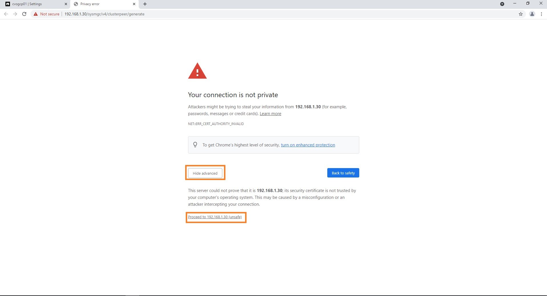

1.10 You may again be asked to confirm an insecure connection. Like before, click “Proceed.”
9 - Cluster peer

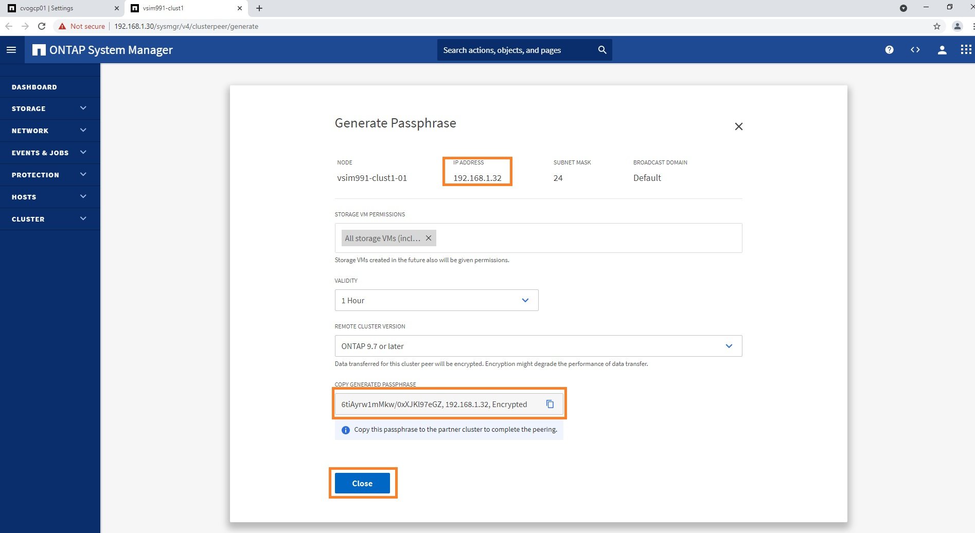

1.12 In the System Manager view for the on-prem instance, copy down both the Cluster Management LIF IP and the passphrase generated by System Manager.
You’re going to need both of these numbers in the proceeding steps.

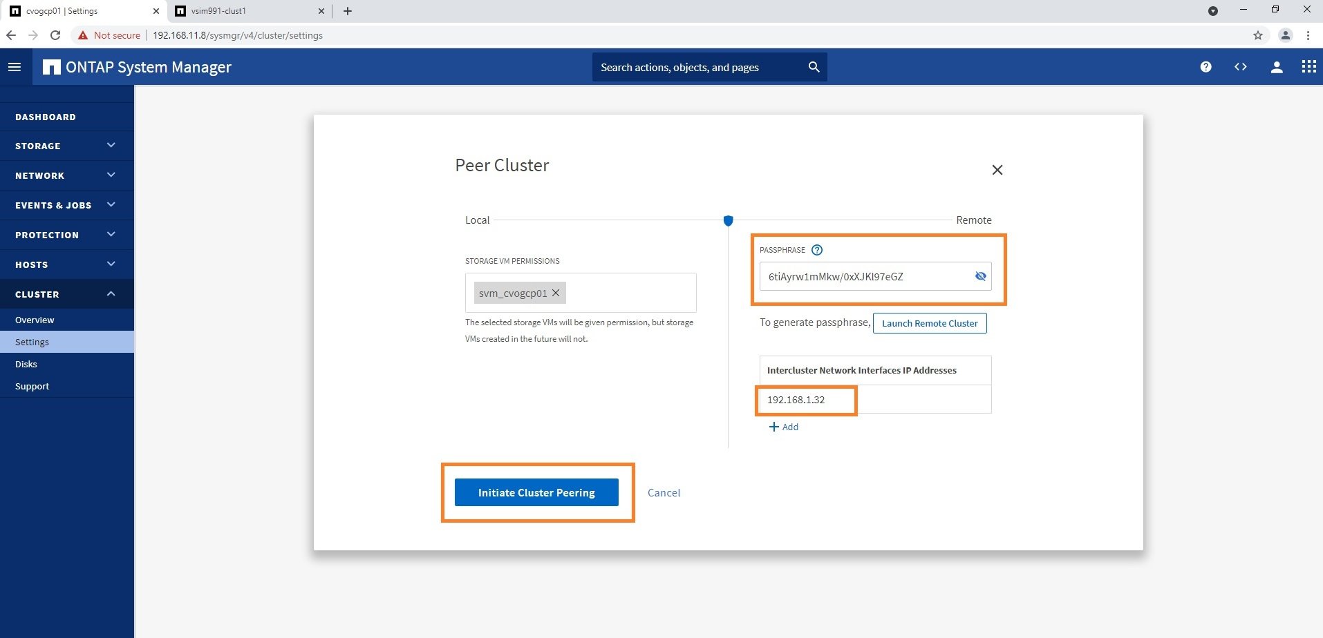

1.13 Go back to the System Manager view of the Cloud Volumes ONTAP instance. Enter the passphrase that was generated in the previous step.
You will also add or verify the IP address for the intercluster network interface. When you’re done, click the “Initiate Cluster Peering” button.

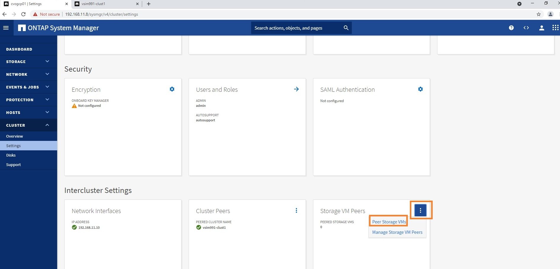

2.1 In the Settings panel of Systems Manager, head down to “Intercluster Settings” and find the one for “Storage VM Peers.”
Open up the menu by clicking the three vertical dots, then select “Peer Storage VMs.”
14 - Cluster peer

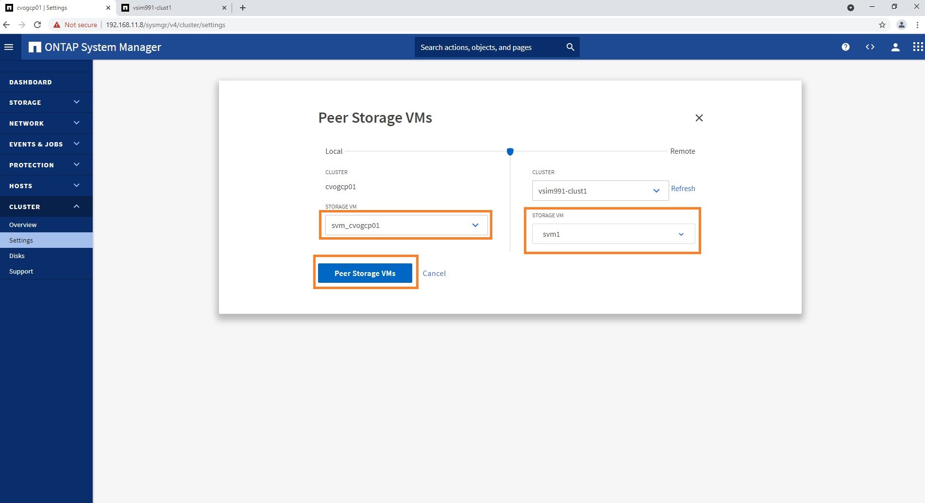

2.2 Find and select the VM names for the cloud-based and on-prem ONTAP instances from the available options that drop down. Next, click “Peer Storage VMs.”
15 - Cluster peer

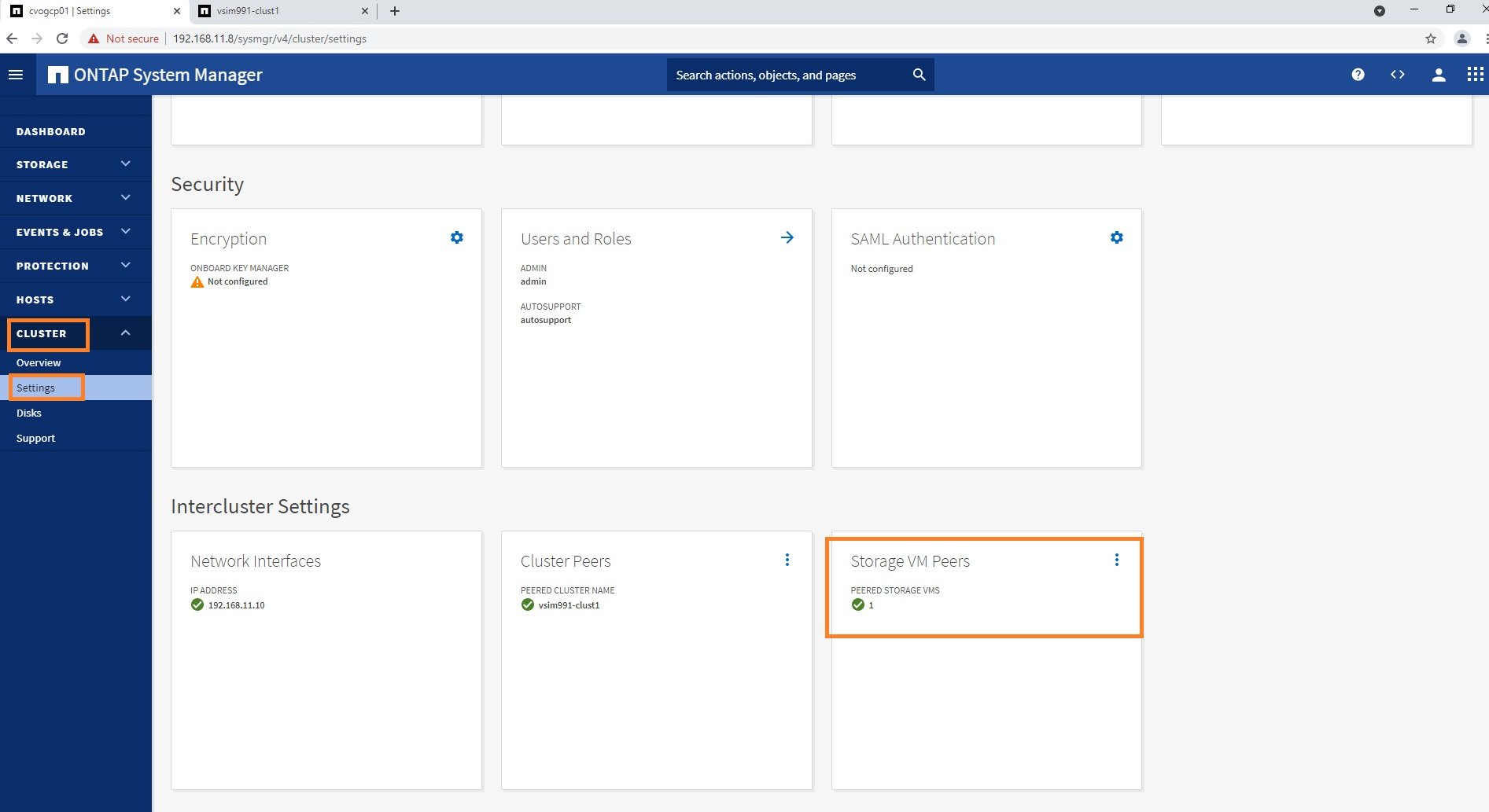

2.3 To confirm that the storage has been peered, go to the System Manger menu on the right and select Cluster, then Settings, and then Intercluster Settings.
You will see a checkmark under the Storage VM Peers option.
16 - Cluster peer

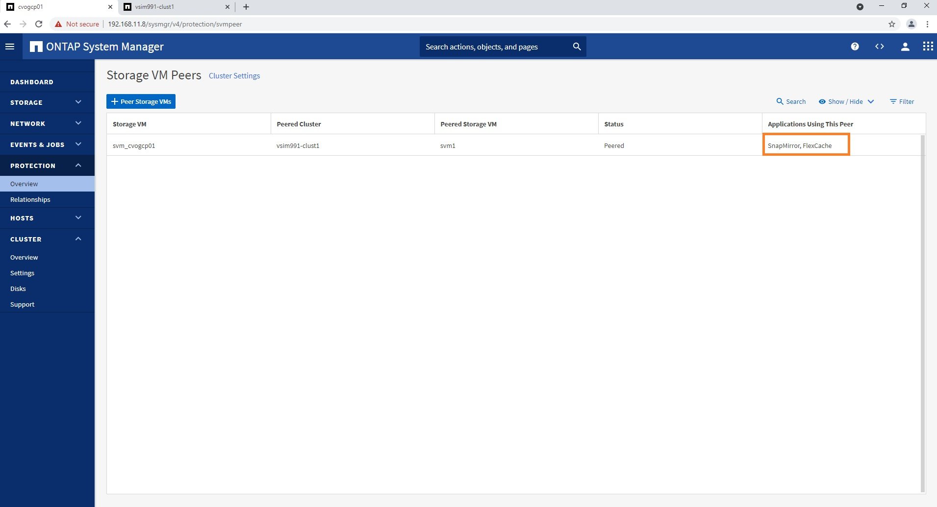

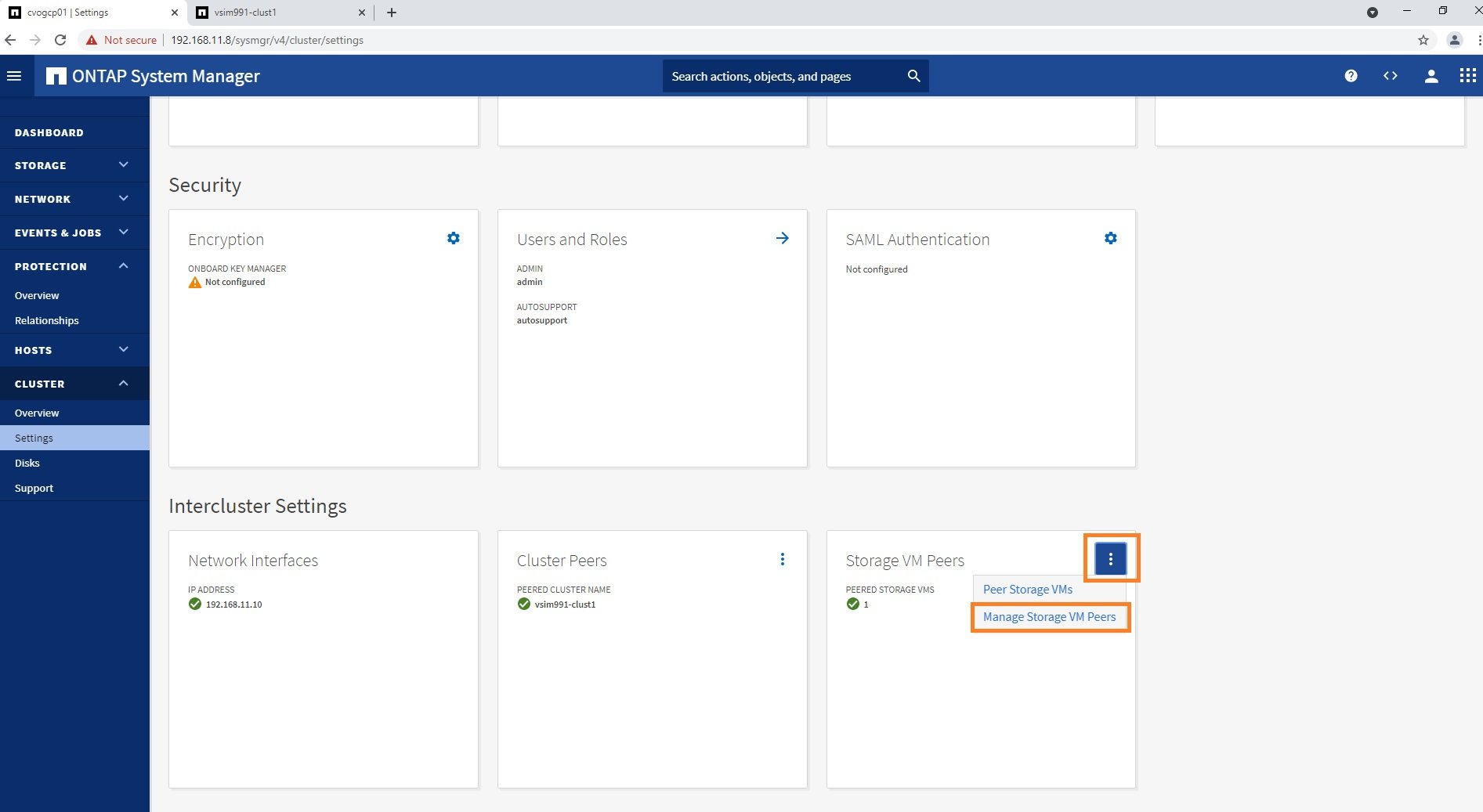

3.1 Go to System Manager’s Settings page. Under “Intercluster Settings,” find the “Storage VM Peers” option.
Use the three vertical dots to expand the menu options and choose “Manage Storage VM Peers.”
17 - Cluster peer
3.2 You will now be situated in the Storage VM Peers screen. As shown below, you can verify your FlexCache volume is listed as a valid application for SVM peering.
18 - Cluster peer

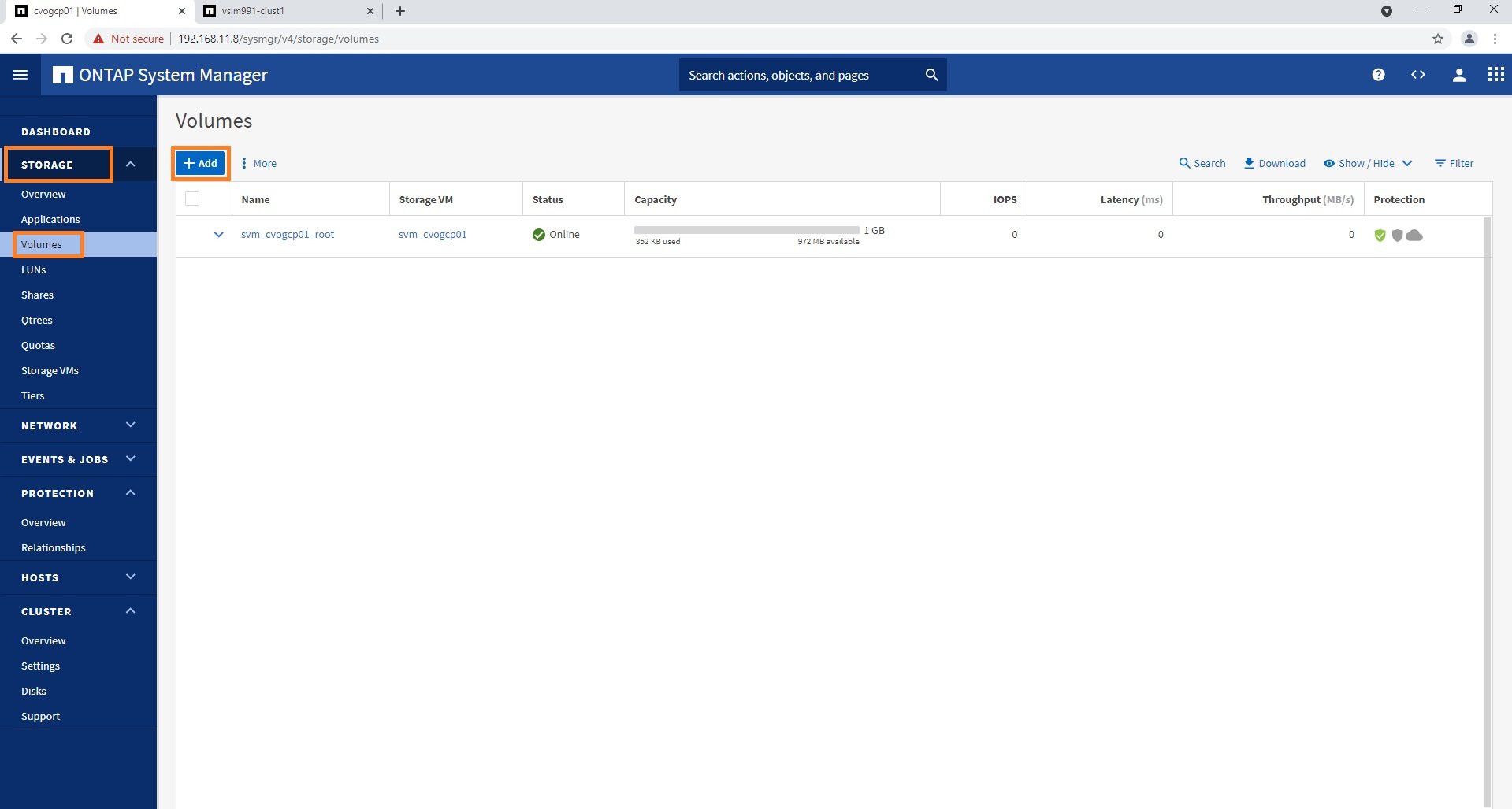

4.1 In the Cloud Volumes ONTAP System Manager, click on “Storage” on the menu to the left.
Select “Volumes” from the options in the expanded menu.
19 - Cluster peer

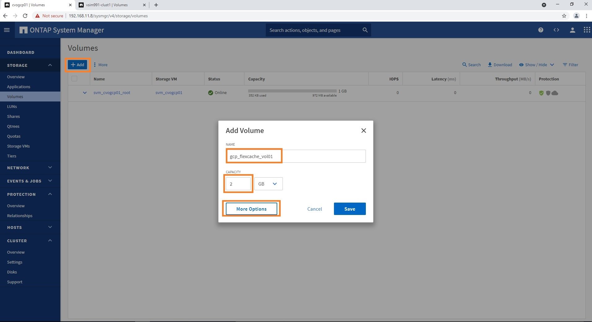

4.2 In the Add Volume pop-up window, click “+Add.” Name your FlexCache volume in the appropriate field. Your volume size should be in line with the sizing considerations that were covered in the prerequisites covered above.
When all the information is entered, click “More Options” to proceed.
20 - FC vol

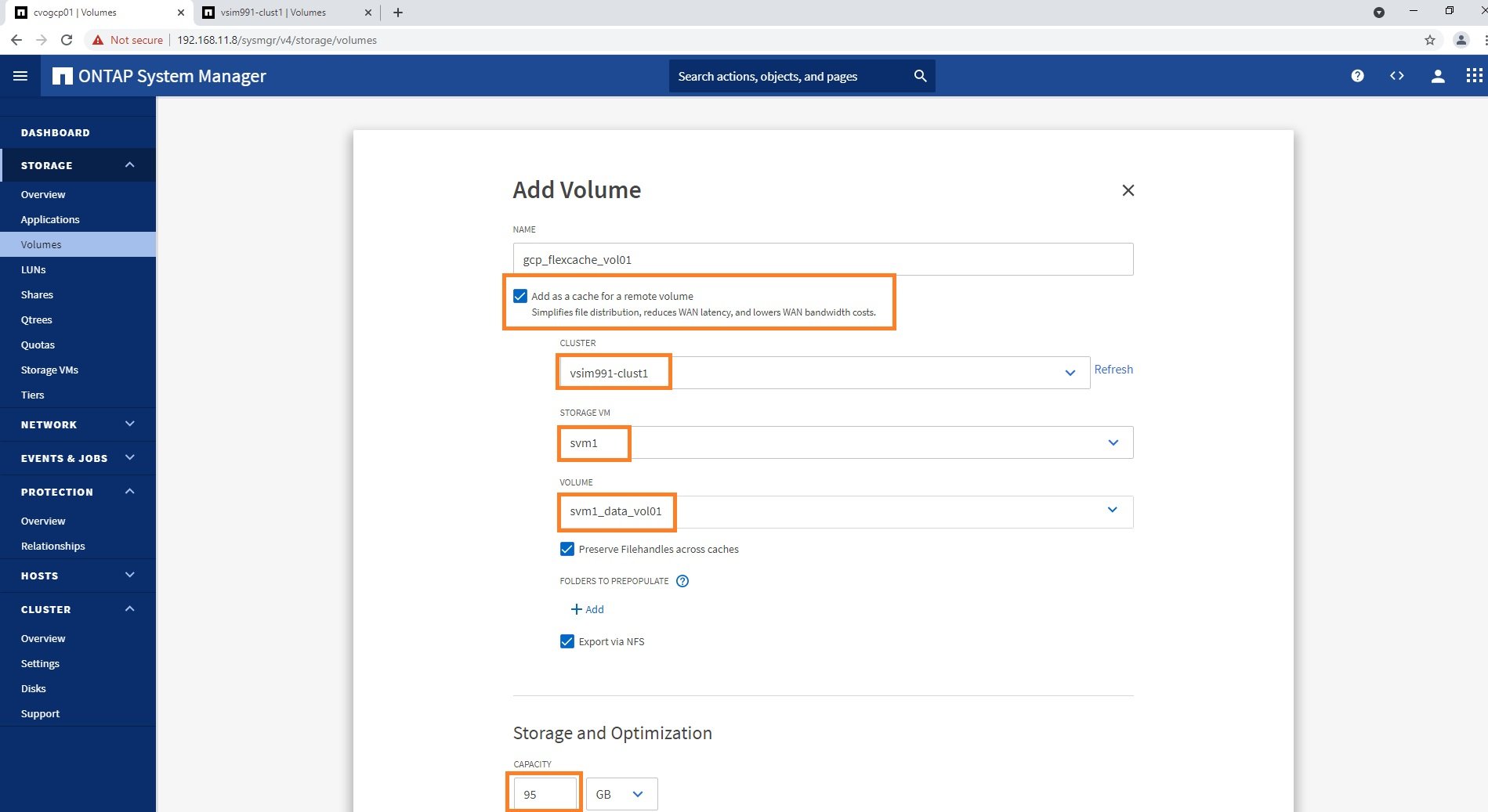

4.3 Tick the first box. This indicates the FlexCache volume will be for a remote volume and make it possible to enter all of the details for the rest of your setup: the name of your on-prem cluster, SVM name, and the SVM source volume the FlexCache copy will be based on.
21 FC vol

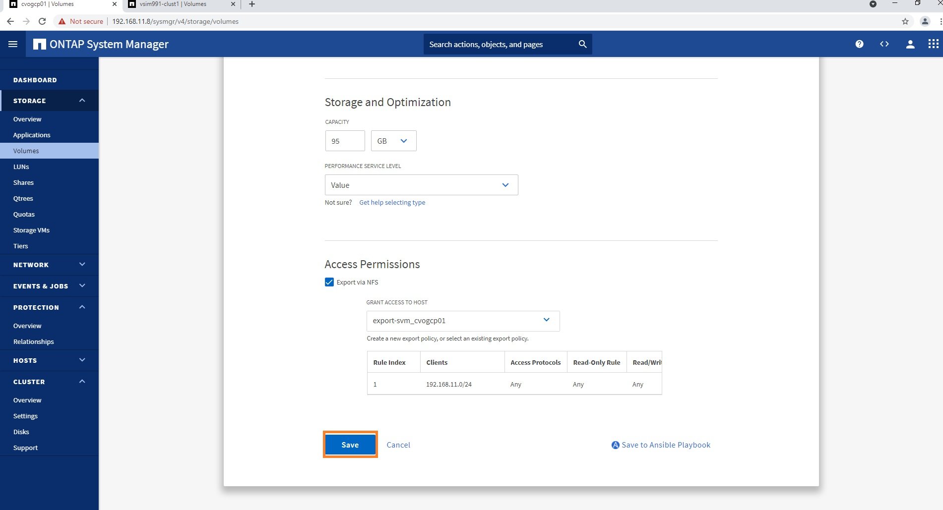

4.4 Scrolling down, you will find some more settings that can be adjusted per your specific deployment. In this example, we are leaving the default settings.
Click “Save” to proceed.
22 FC vol

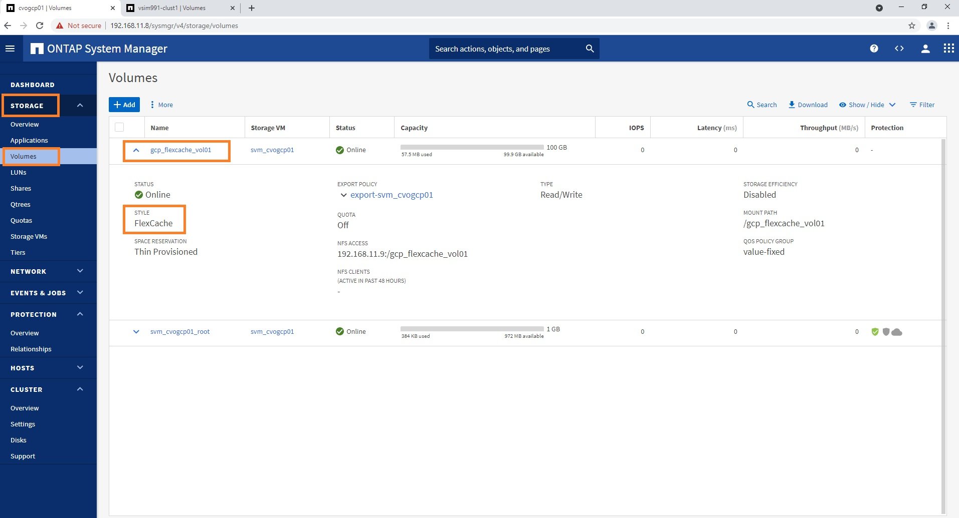

4.5 Your FlexCache volume will now be in place. To verify, go back to System Manager and click the “Settings” option in the menu to the left. From there, go to “Volumes.”
The FlexCache volume will be indicated by a checkmark.
23 - FC vol
