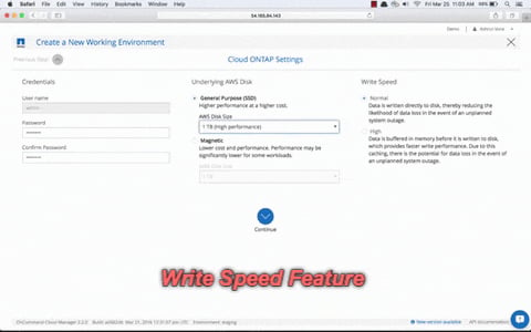

In Write Speed we are enabling faster acknowledgment back to client. So when client writes to Cloud Volumes ONTAP using any protocol (NFS, CIFS, or iSCSI) write is acknowledged before it is committed to stable storage.
How do I enable this feature?
By default starting with OnCommand Cloud Manager 2.2 will set your write speed as Normal or in other words, imagine you are getting latest Cloud Volumes ONTAP via Cloud Manager but without this feature.
There are two ways to enable this feature:
  1. When you are deploying new working environment there is an option to select Normal or High write speed.
Write-Speed Feature

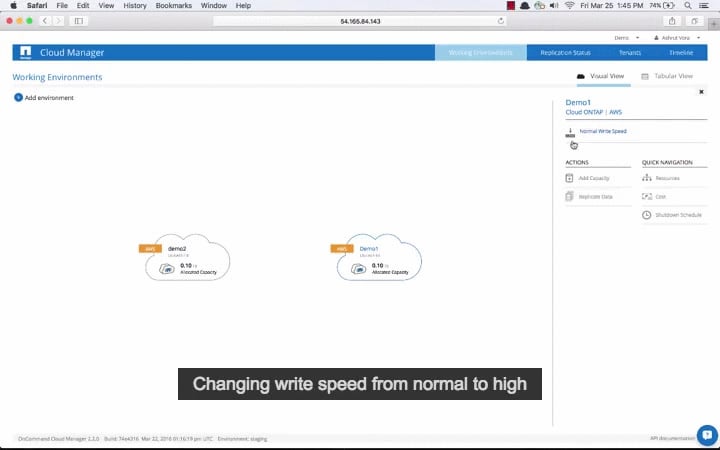

  • You can change write speed of existing deployment,which has normal write speed by going into Cloud Volumes ONTAP options
    • Since Cloud Volumes ONTAP needs a reboot to enable the changes, please make sure you have planned this event or Cloud Volumes ONTAP is not in use
  • how-to-change-write-speed
