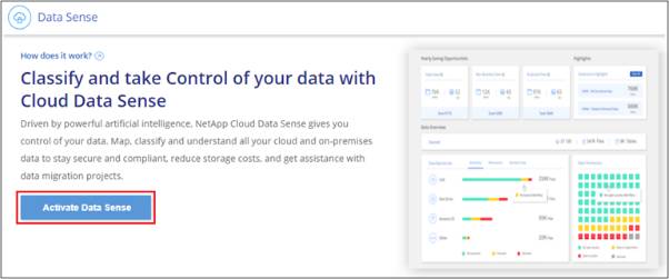

  1. In Cloud Manager, find the panel for Data Sense.
  2. On the Data Sense page, find the “Activate Data Sense” button and click it.
1 Aug 25 2022 07 21 02 42 AM

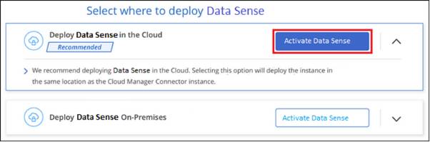

  • Click Activate Data Sense to launch the deployment wizard.
  • 2 Aug 25 2022 07 22 56 82 AM
