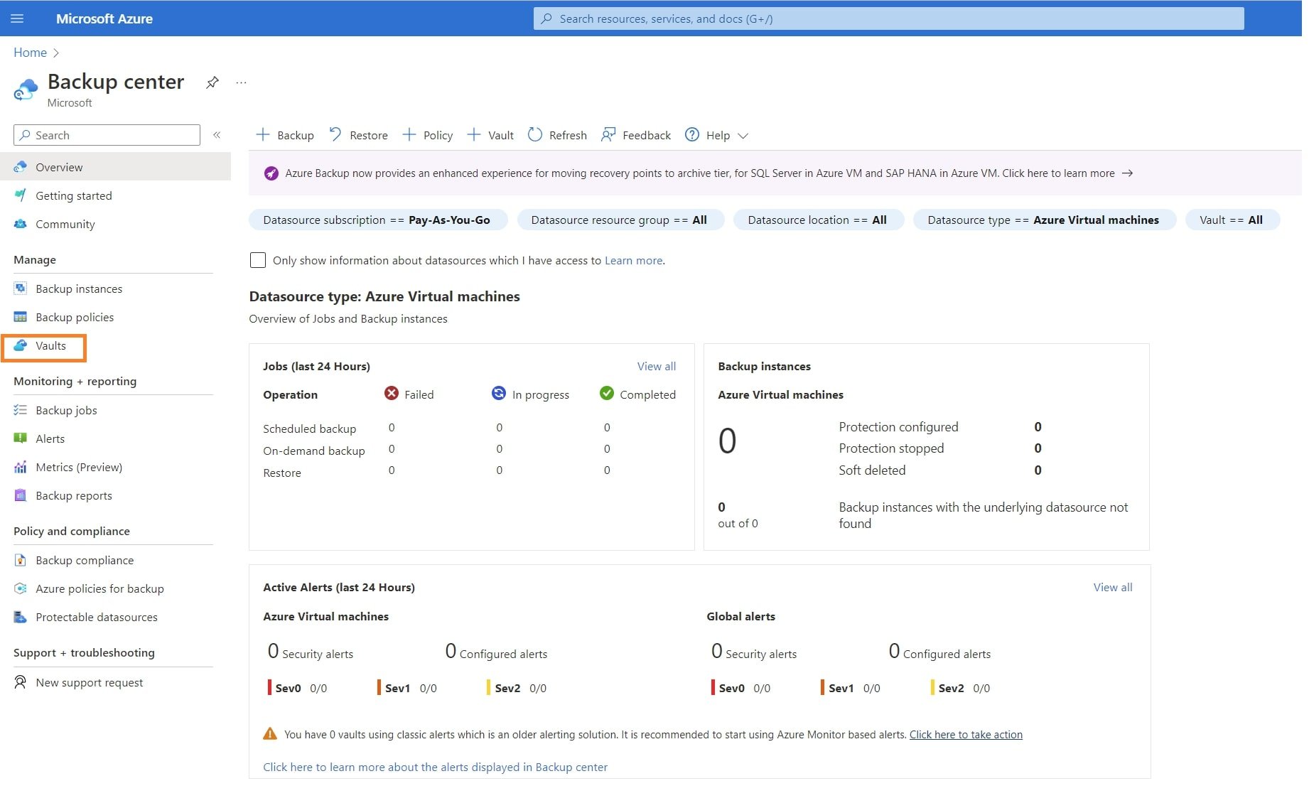

    1. Open the Azure Backup center from the Azure portal. Click on “Vaults” to create an Azure Backup vault for storing the backup.

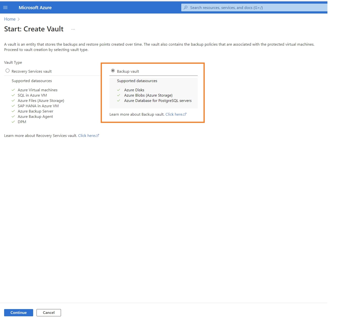

  • Click on “+Vault” to create a new Backup vault.
  • cvo 576 1
  • Select “Backup vault” and click continue.
  • cvo 576 3

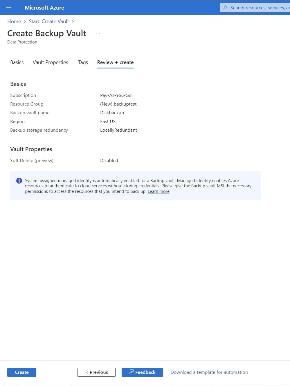

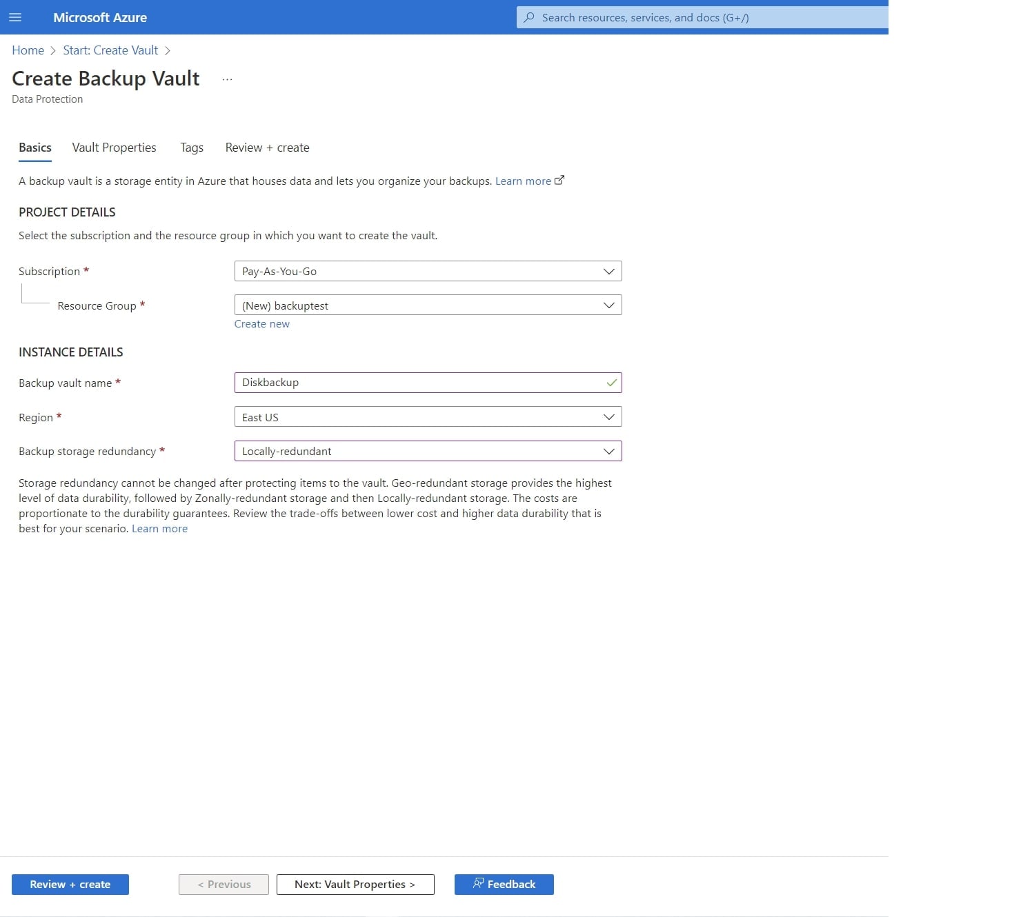

  • Enter the Backup vault properties, i.e., vault name, region, resource group, and backup storage redundancy. Storage redundancy can either be locally redundant or globally redundant, based on your organization’s data resiliency requirements.
    Click on “Review+create” to continue.
  • cvo 576 4
  • Review the configuration and click on ‚Ä'Create” to complete the provisioning process.

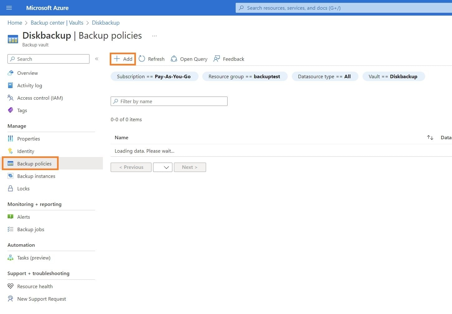

    1. Open the Backup vault from the Azure Backup center. Click on Backup Policies ->Add.

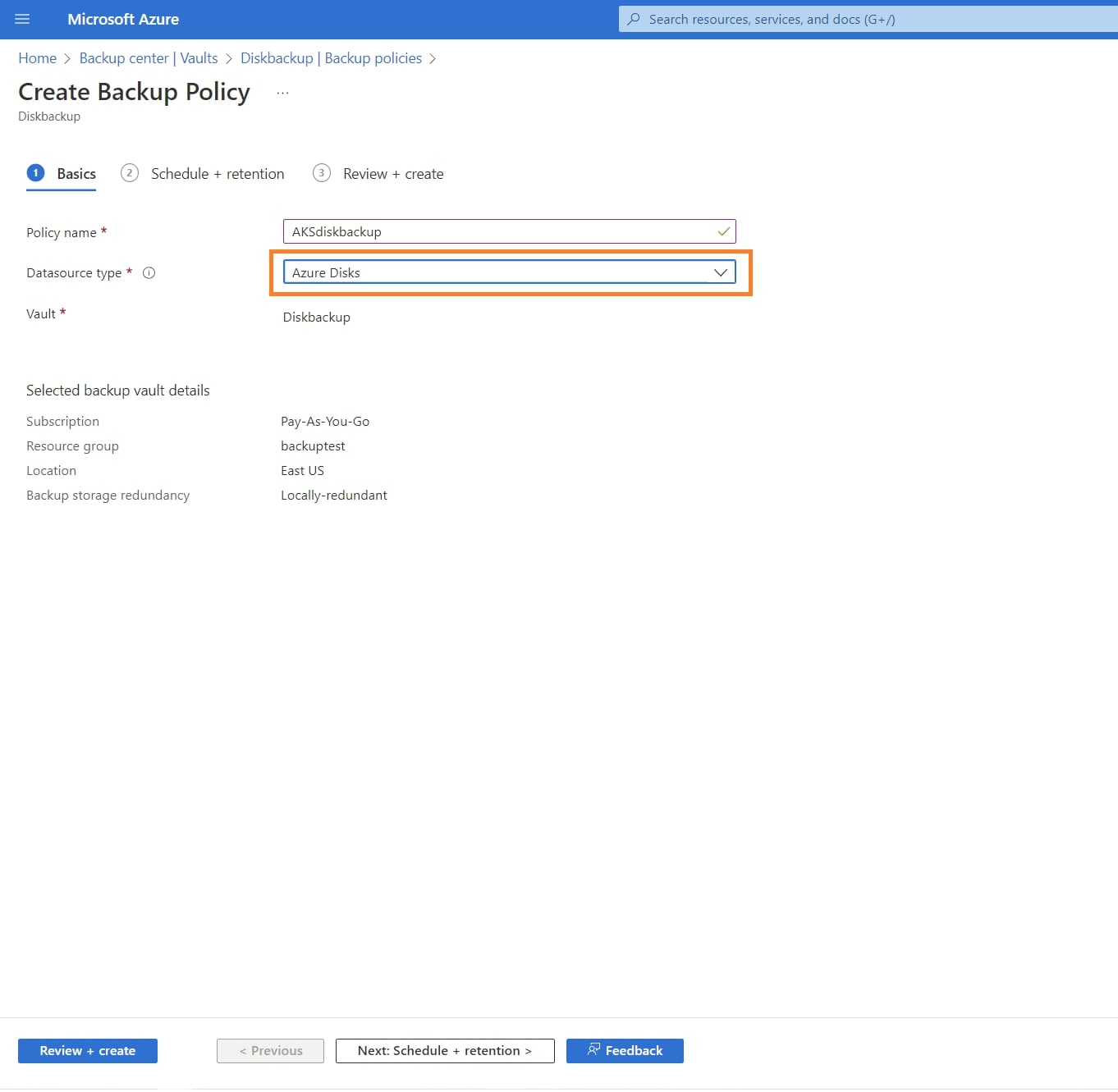

  • In the basics tab, add the Policy name and select “Azure Disks” as the data source. Click on “Next:Schedule+retention” to continue.

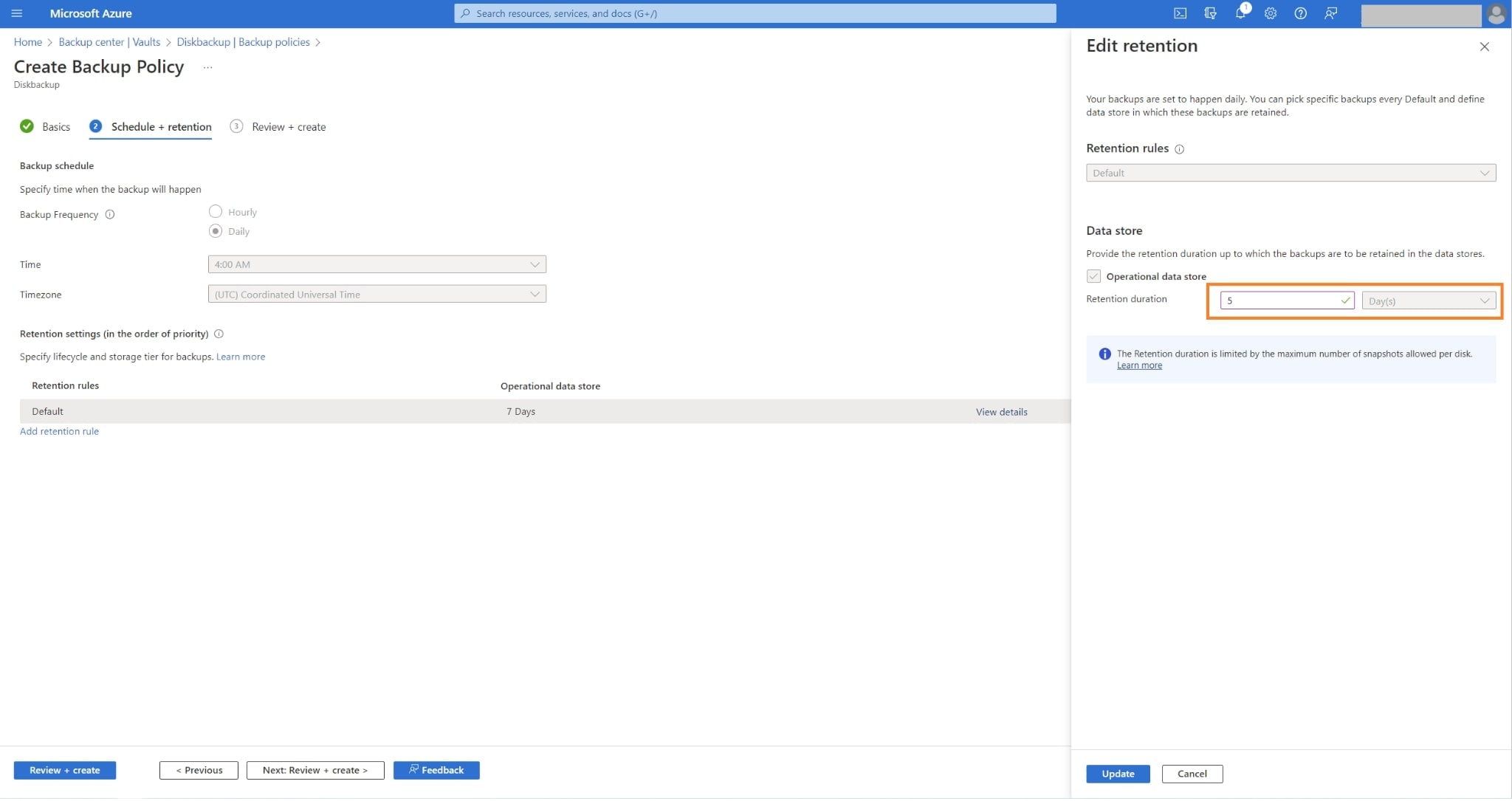

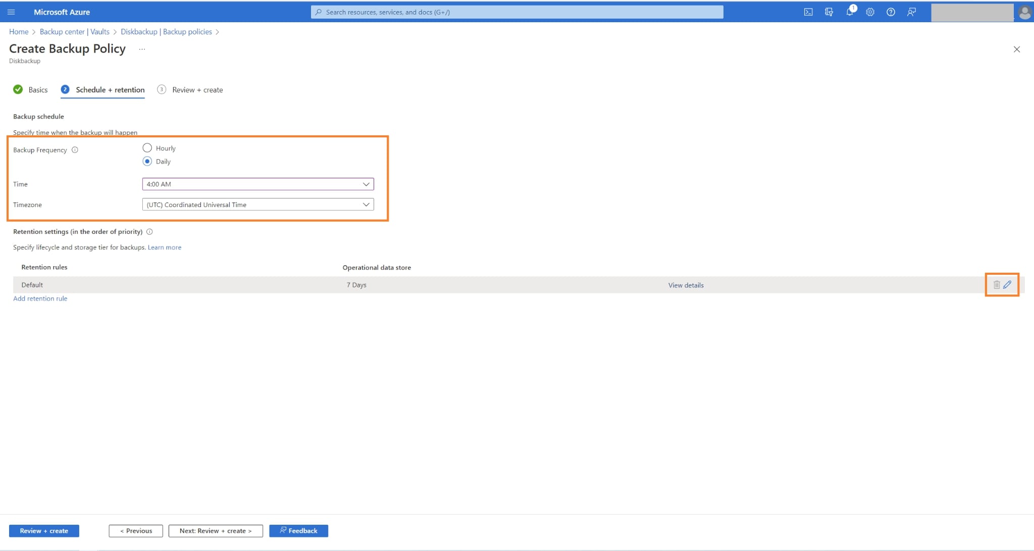

  • In the next window define the backup frequency, i.e., either daily or hourly, based on your required RPO. You can also add the retention period in this window or add a new retention rule by clicking the pencil icon.
  • cvo 576 8
  • The default retention duration is seven days, but that can be changed to suit your organization’s requirements. However, note that there is a limit of 500 incremental snapshots per disk, and Azure Backup has a max limit of 450 backups to accommodate on-demand backups as well.
    Click on “Update” once the retention duration is configured.
  • cvo 576 9

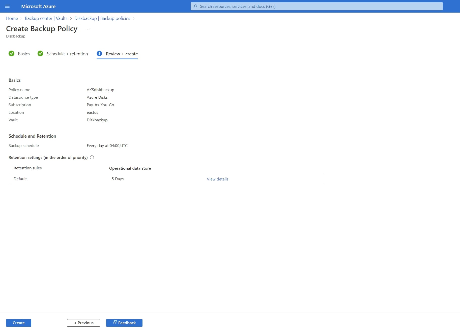

  • Review the details of the backup policy and then click on “Create” to create the backup policy.
  • cvo 576 10

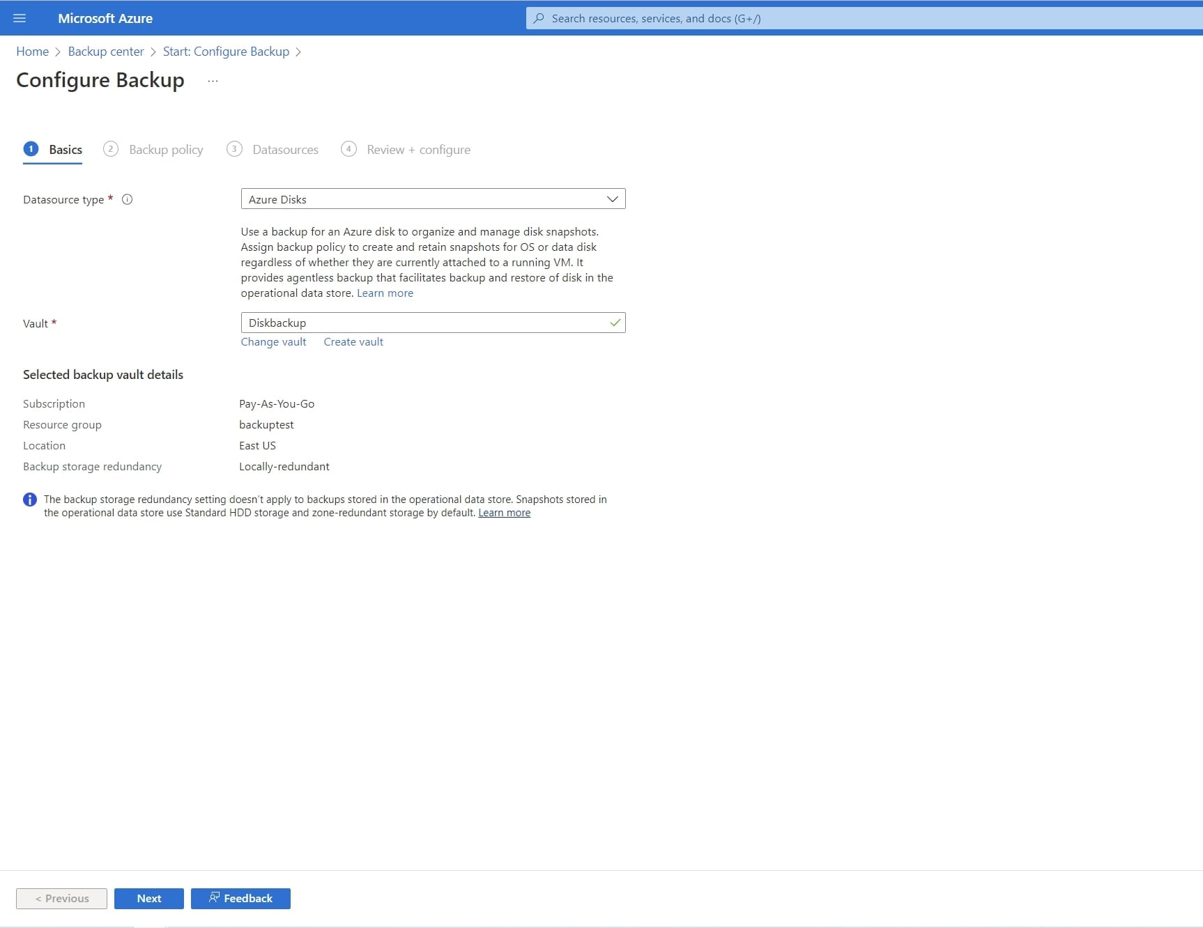

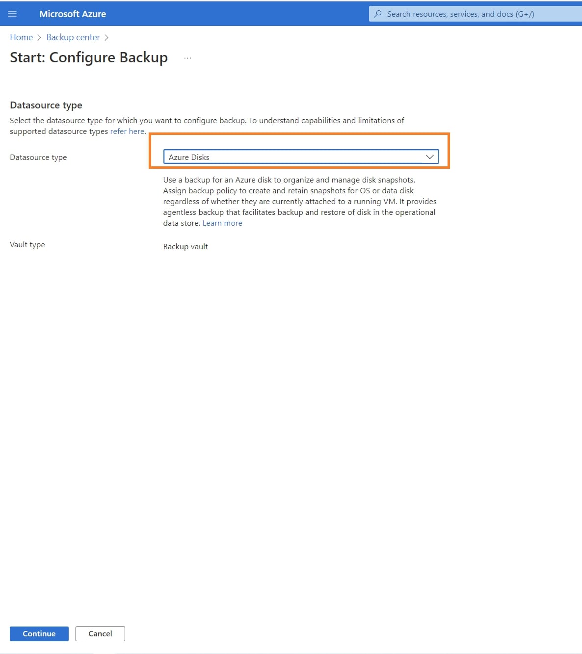

    1. In Backup center click on “+Backup” to configure backup of Azure managed disk that is configured as persistent volume in AKS. Select the data source as Azure disks and click “Continue” to proceed.
  • cvo 576 11

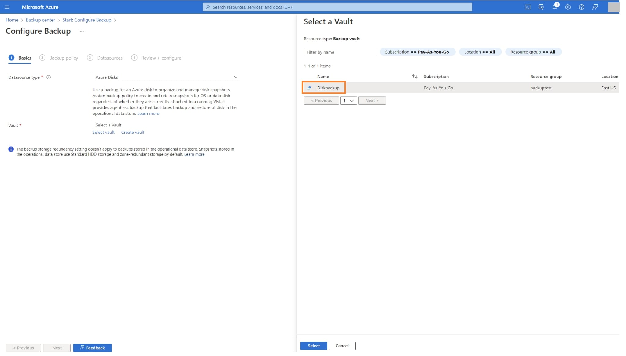

  • Click on “Select Vault” and choose the Backup vault that was previously created in step 1.4, or your existing Backup vault.
  • cvo 576 12
  • Click on “Next.”

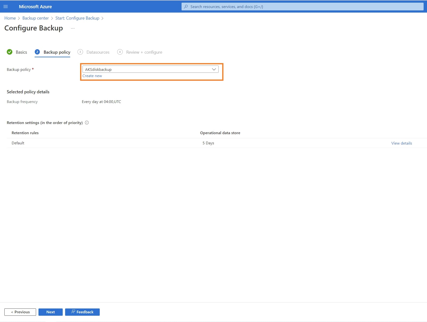

  • Select the “Backup Policy” created in step 2.5.
  • cvo 576 14

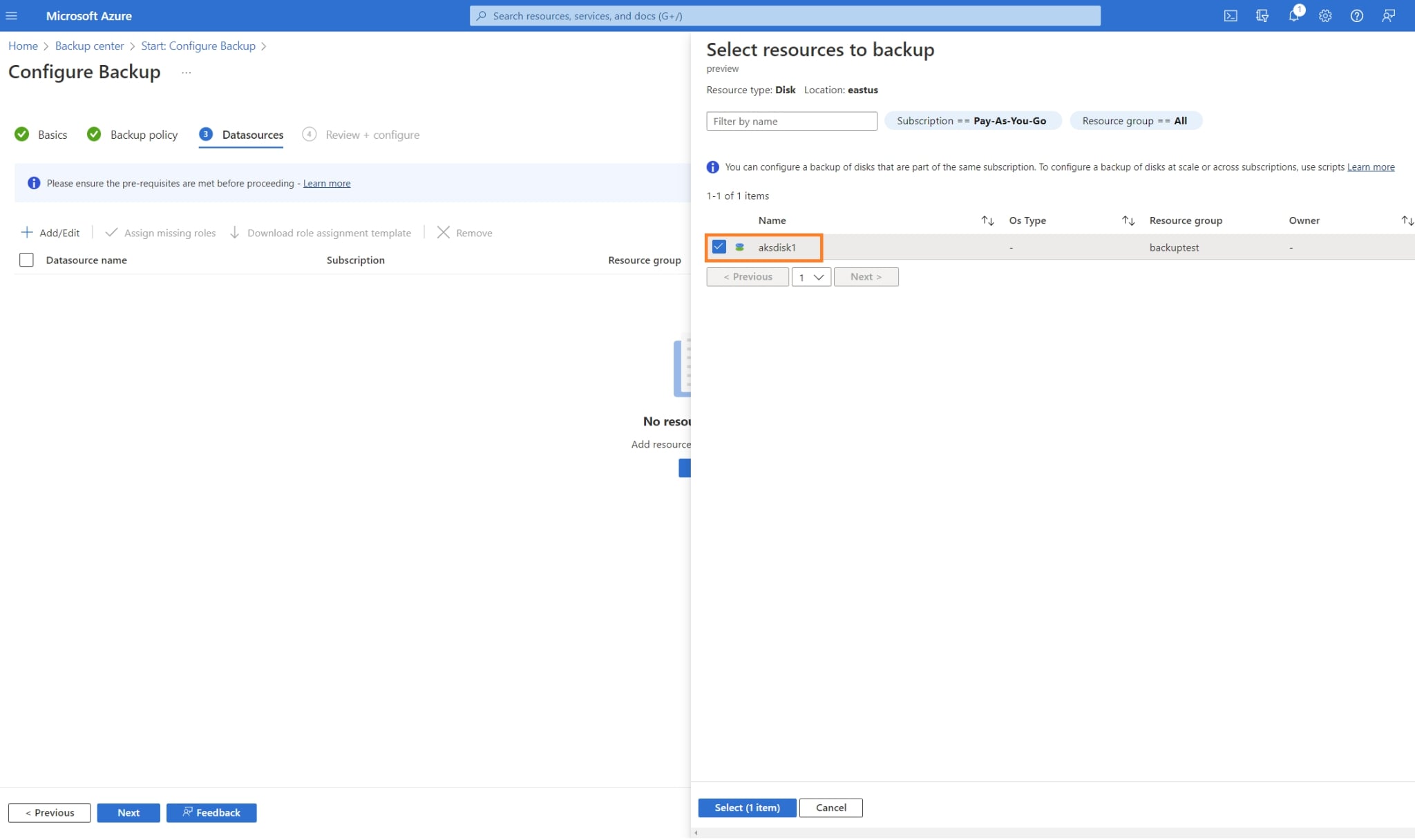

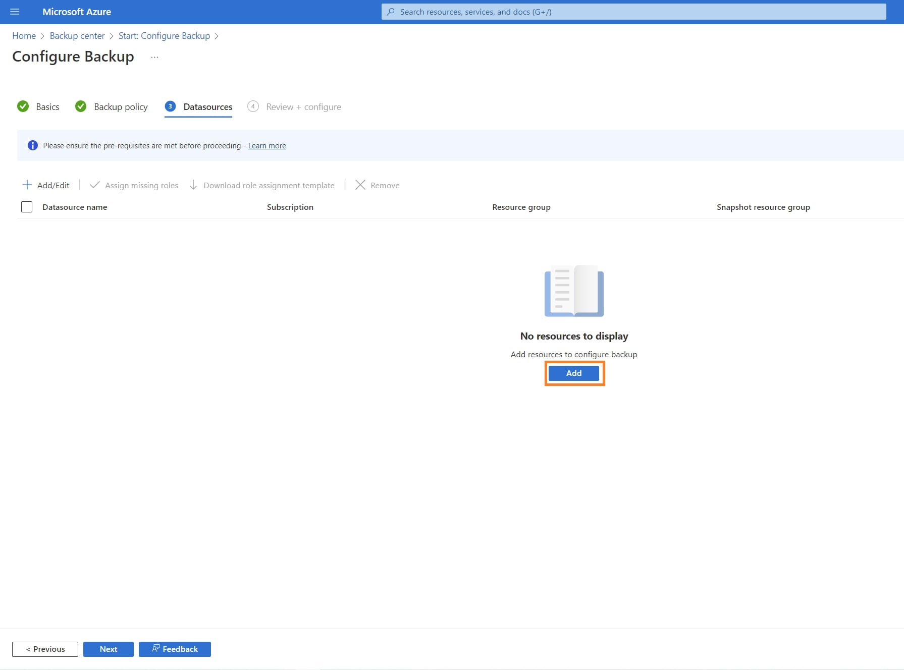

  • Click on “Add” to add the disk as data source.
  • cvo 576 15
  • Select the managed disk that is attached to the AKS cluster as a persistent volume.

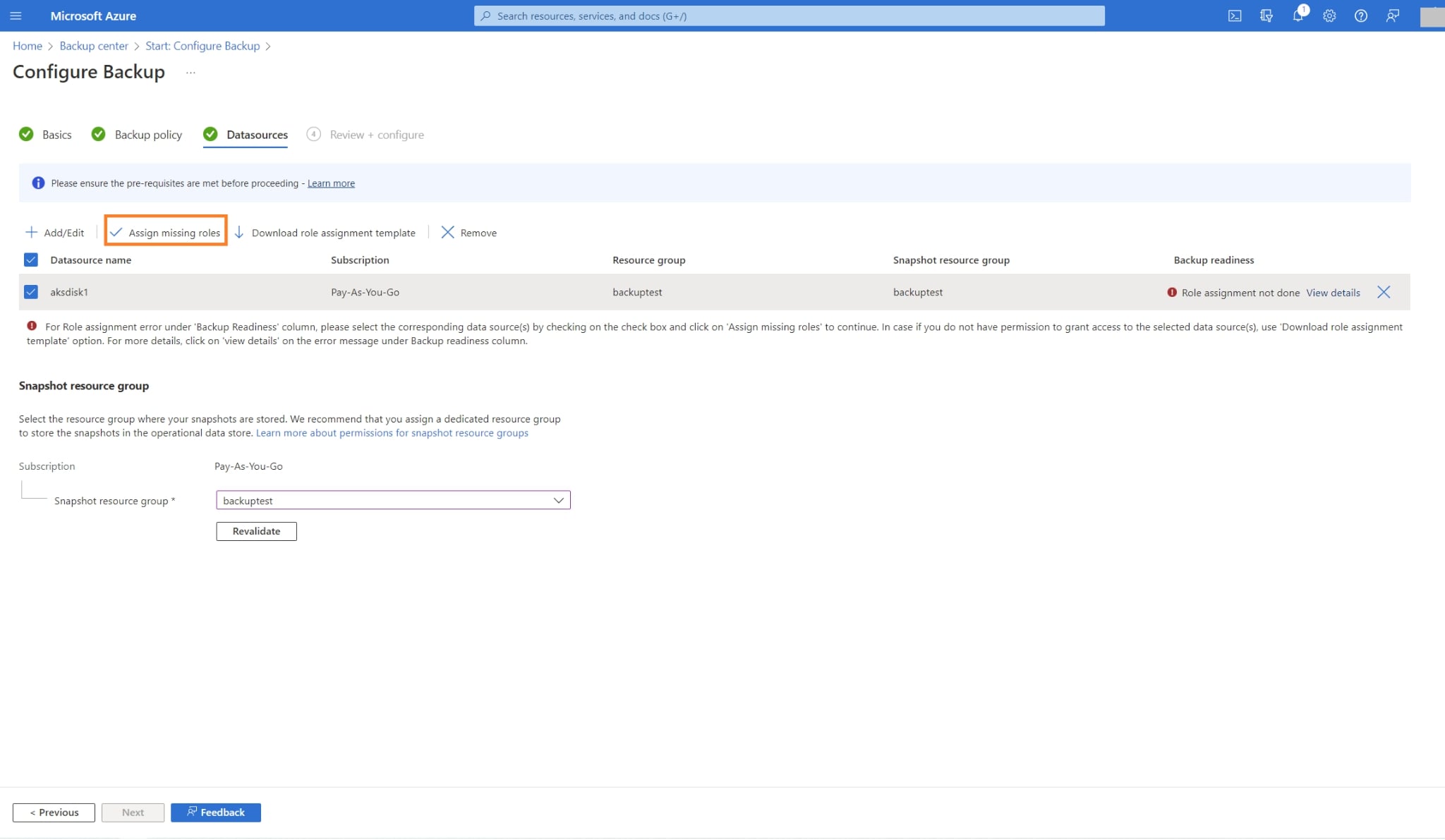

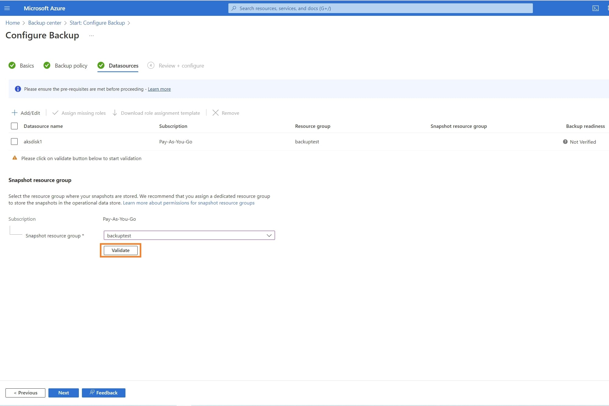

  • Select the resource group where the snapshots will be stored. It is recommended to create a separate resource group for the backup to segregate the backup management. Click on “validate” to proceed.
    The Backup vault managed identity should be assigned “Disk backup Reader” permission on the source disk to be backed up. Set the Disk Snapshot contributor role on the Azure Backup Service Resource group for the validation to succeed.
  • cvo 576 17

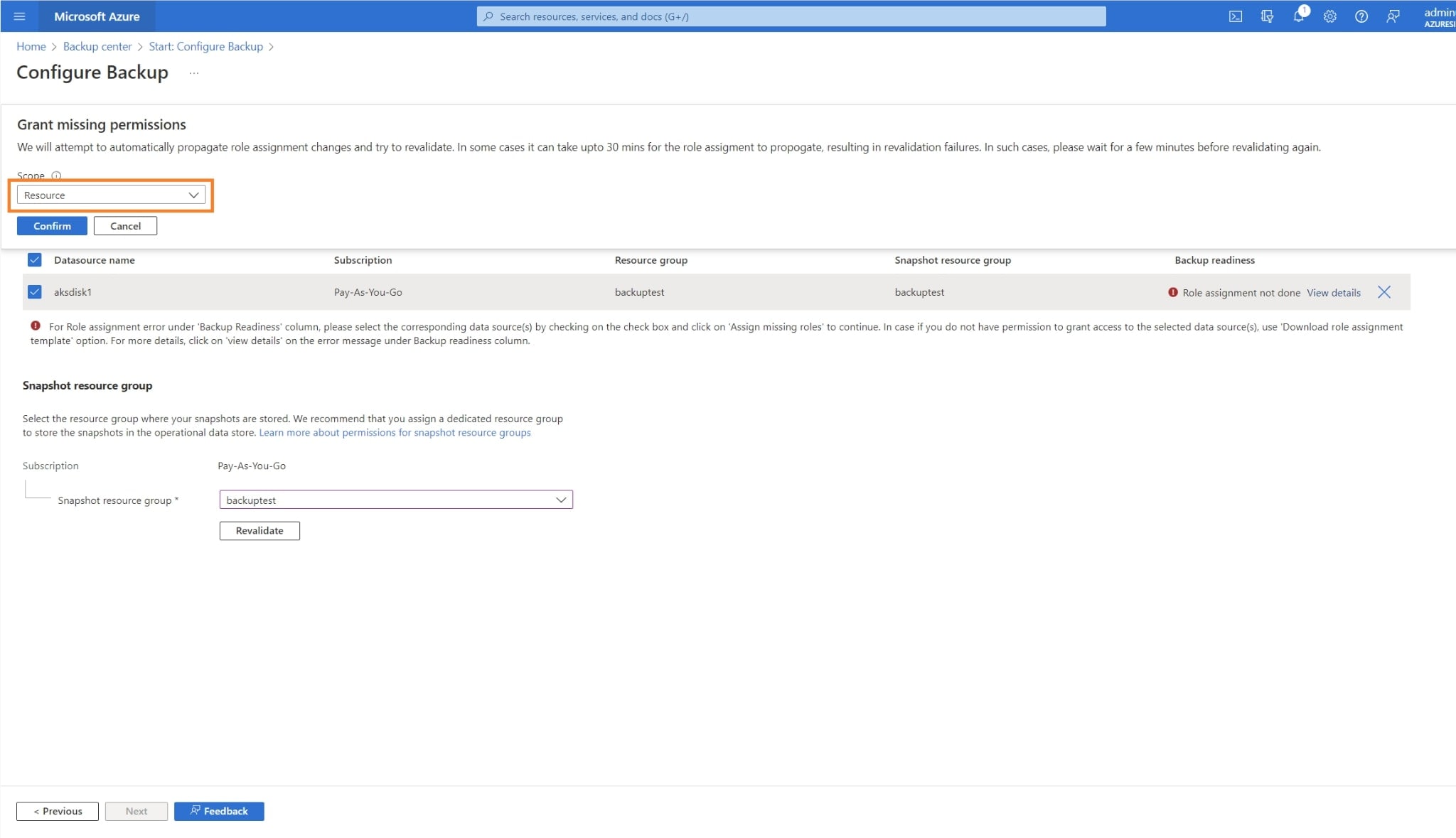

  • If you get a validation error, select the disks and click “Assign Missing Roles” to assign roles.
  • cvo 576 18
  • Select the scope as “Resource” and click confirm to assign the role permissions.

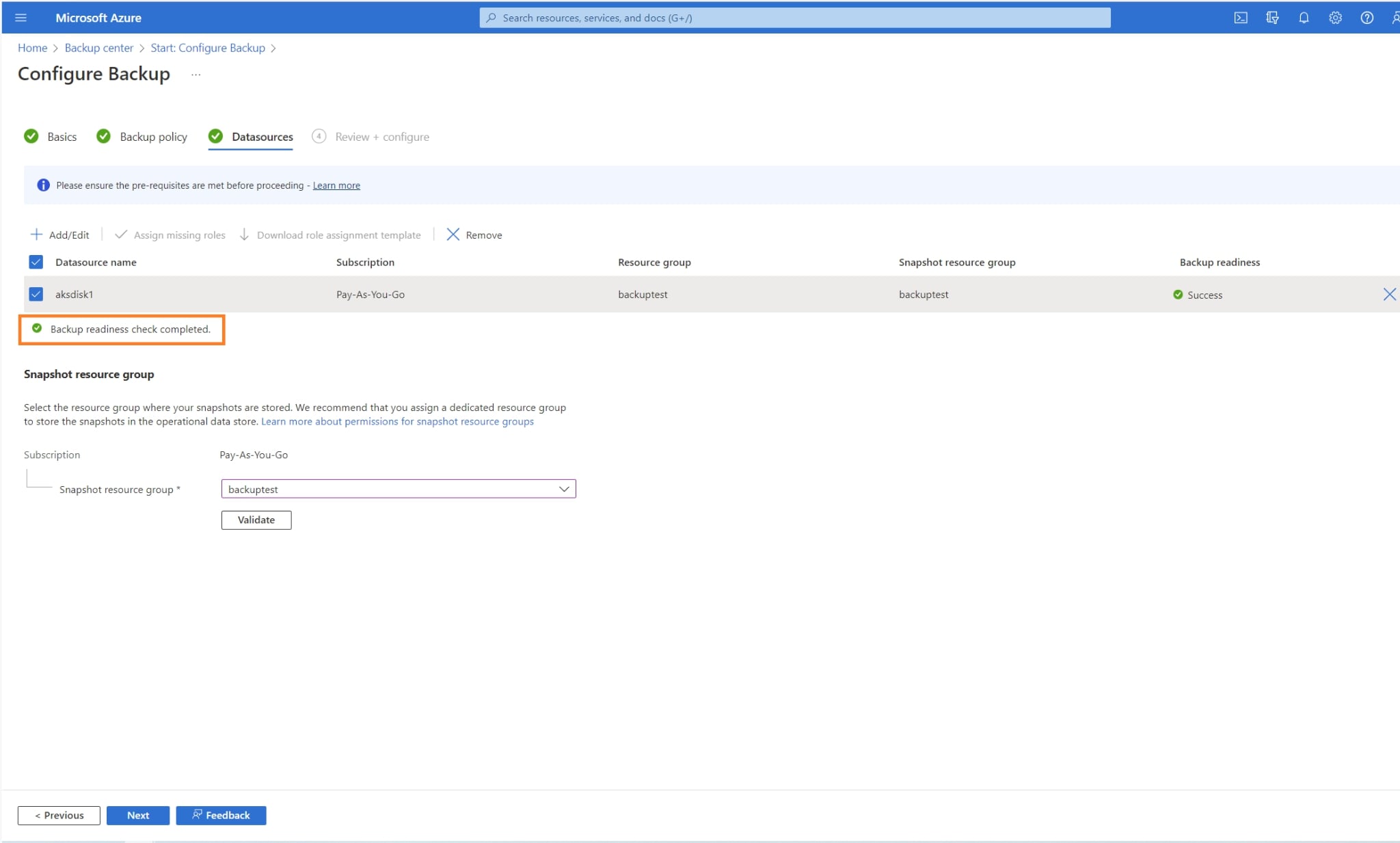

  • Once the role is assigned, the backup readiness check will run automatically. Click on “Next” to continue.
  • cvo 576 20

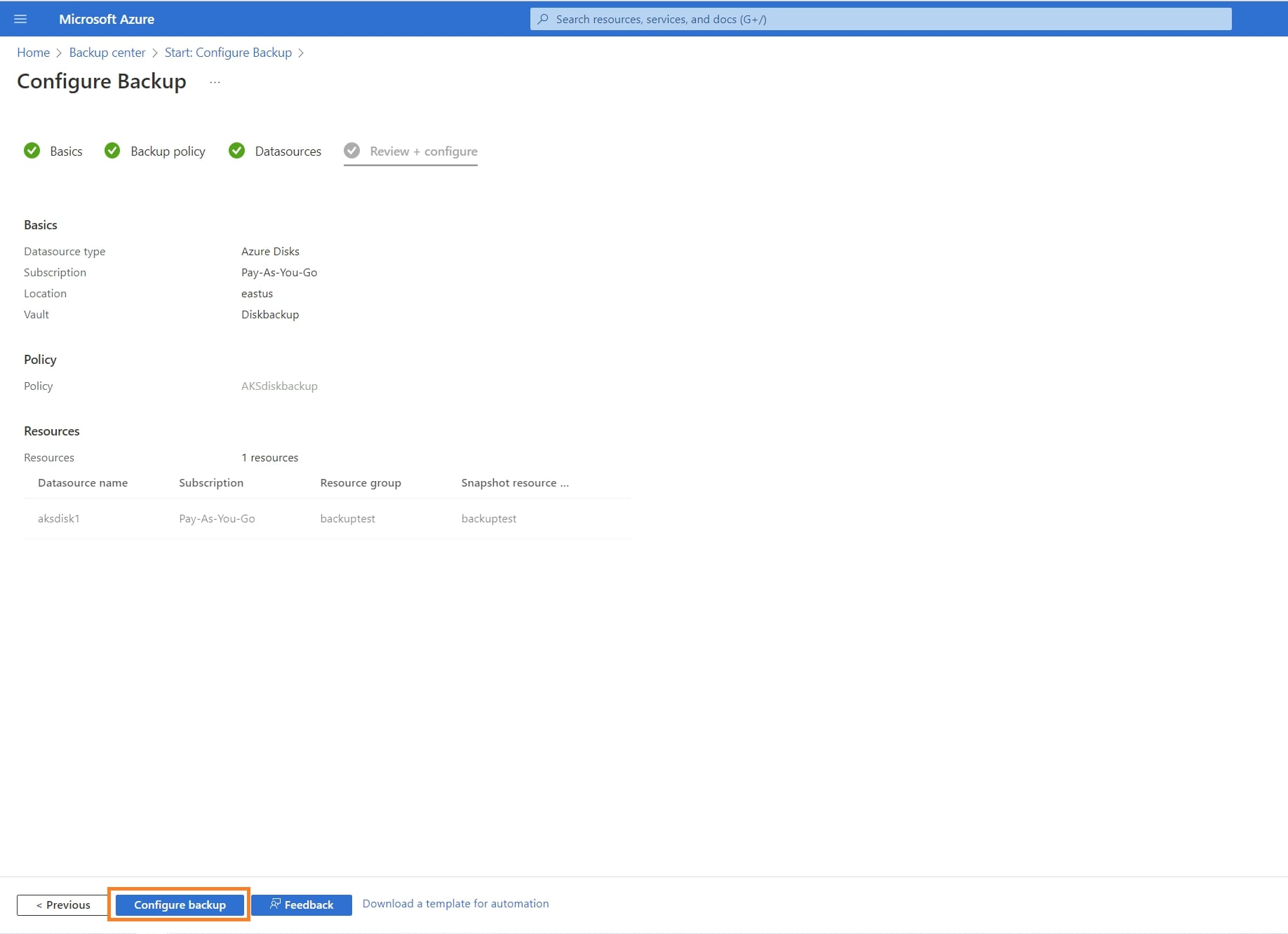

  • Review the settings and click “Configure backup” to complete the backup configuration.

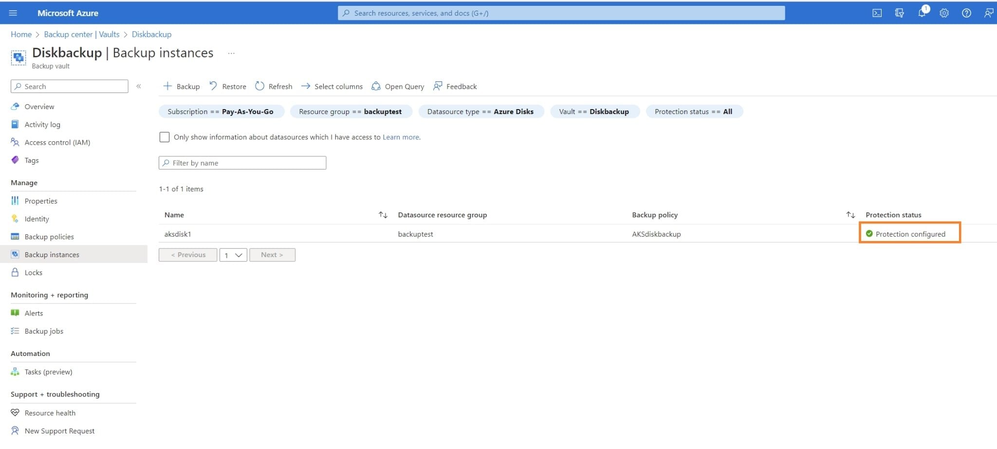

  • If you browse to the Backup Vault ->Backup Instances, you can see the disk protection status.

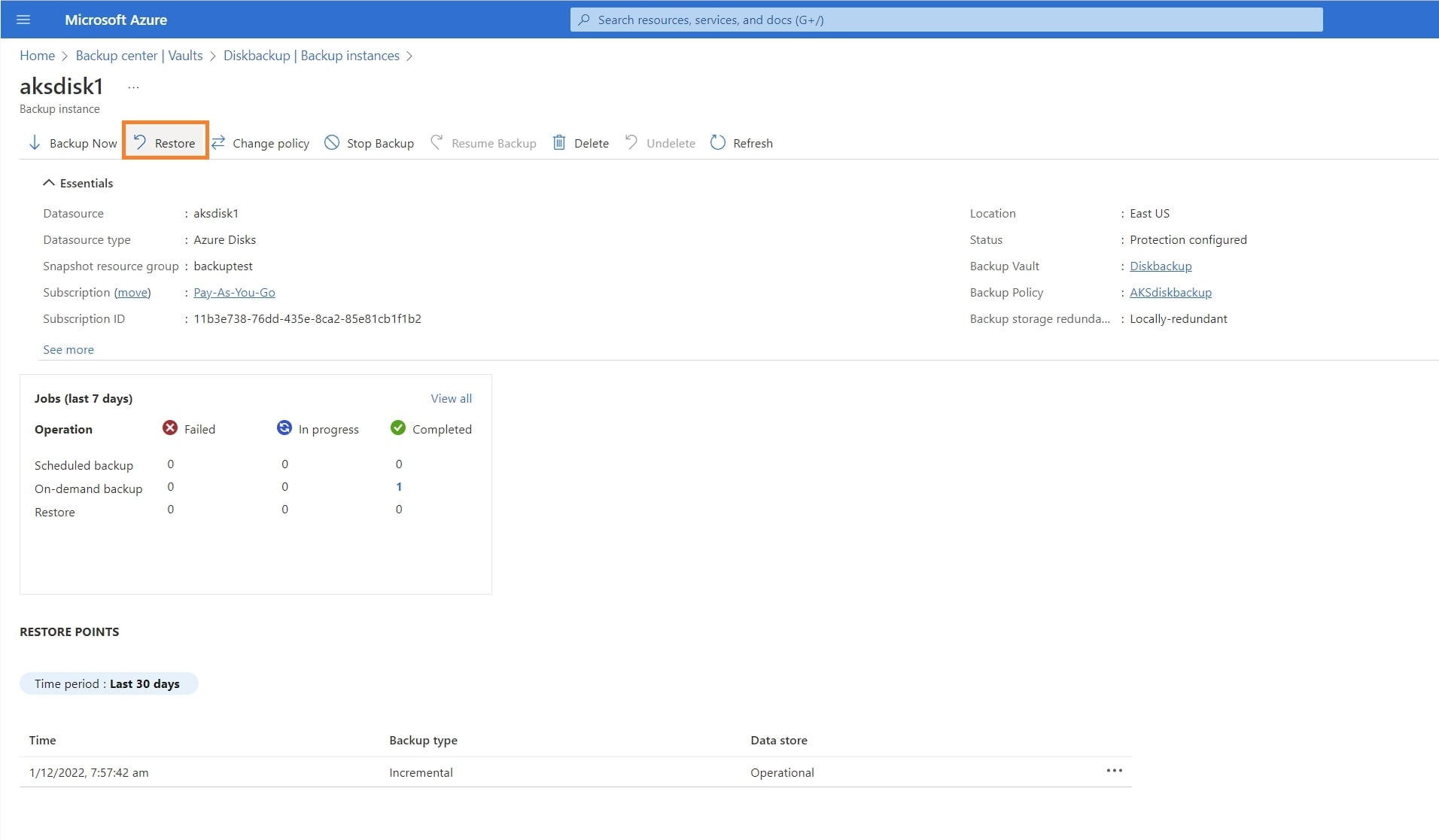

    1. To restore the backup, browse to the Backup Vaults-> Backup instances and select the disk to be restored. Click on “Restore” to proceed.

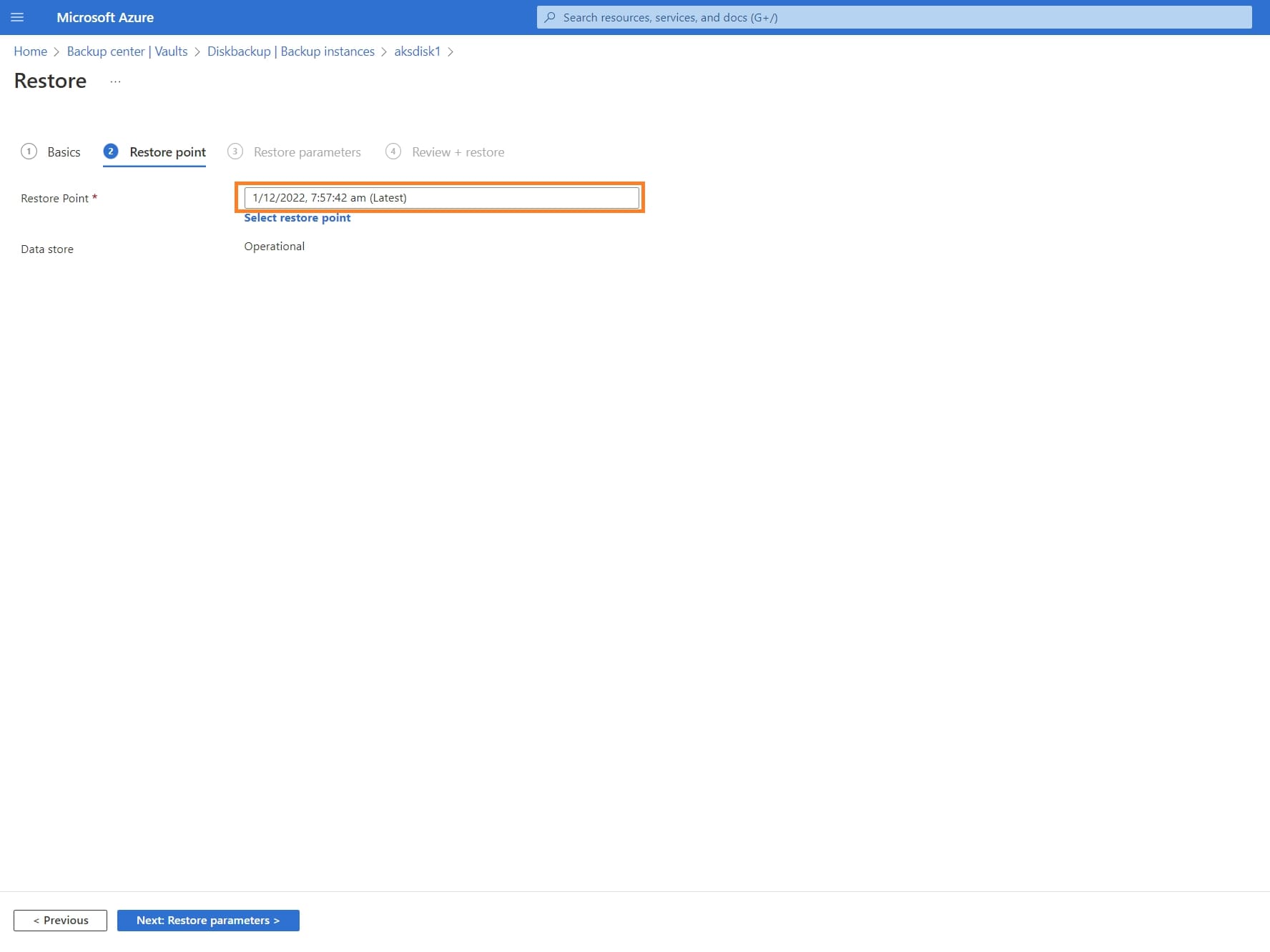

  • Select the “Restore Point” to select the point-in-time backup copy that you want to restore. Click on “Next: Restore parameters” to continue.

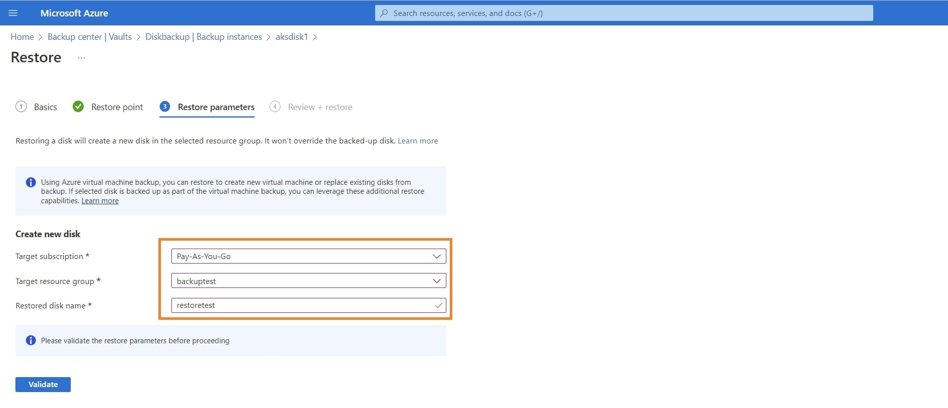

  • Select the target subscription, resource group, and provide a name for the restored disk. Click on “Validate” next, and once the validation completes, click “Next:Review+Restore” to proceed.

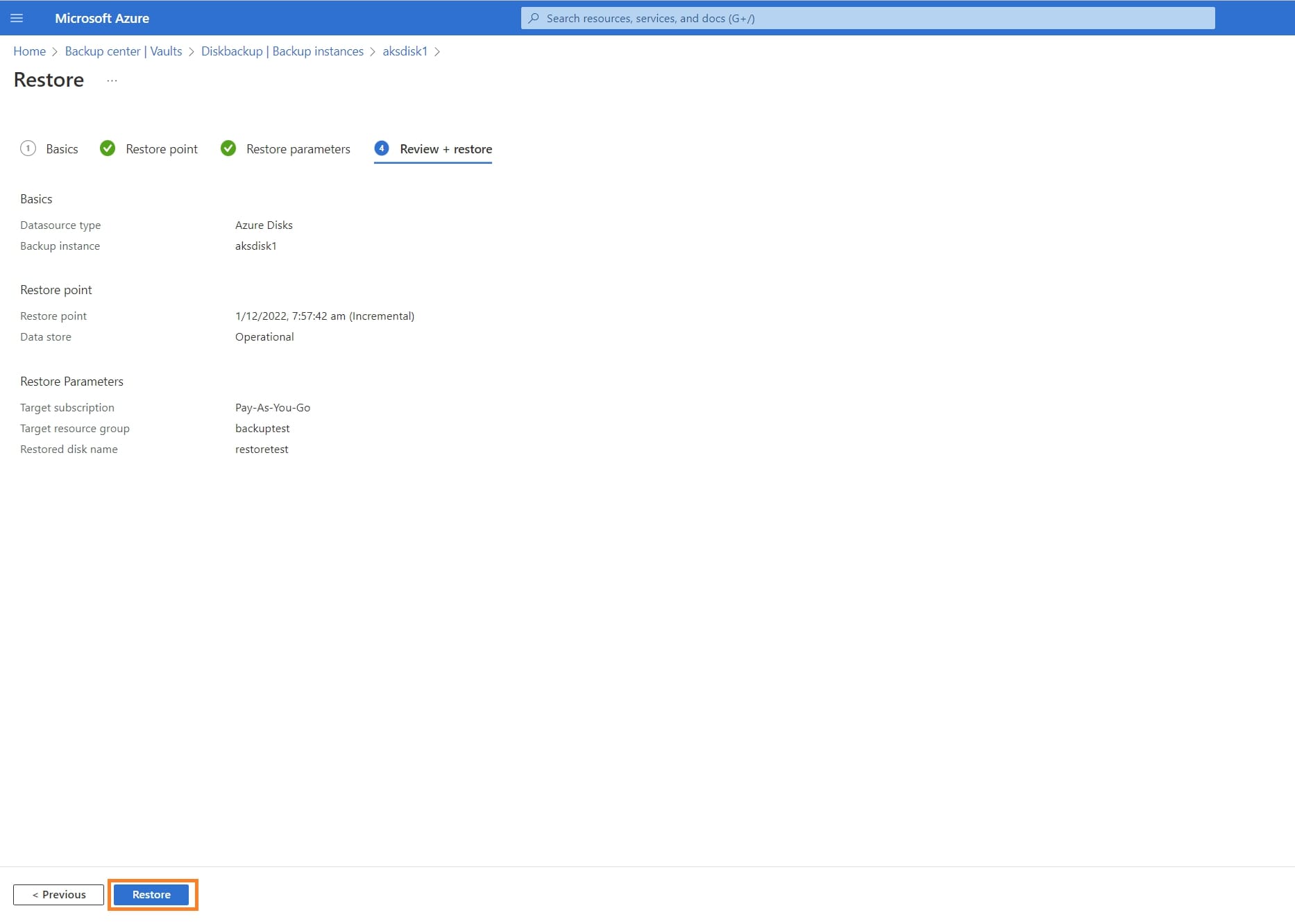

  • Review the settings and click on “Restore” to start the restore process.
  • cvo 576 26

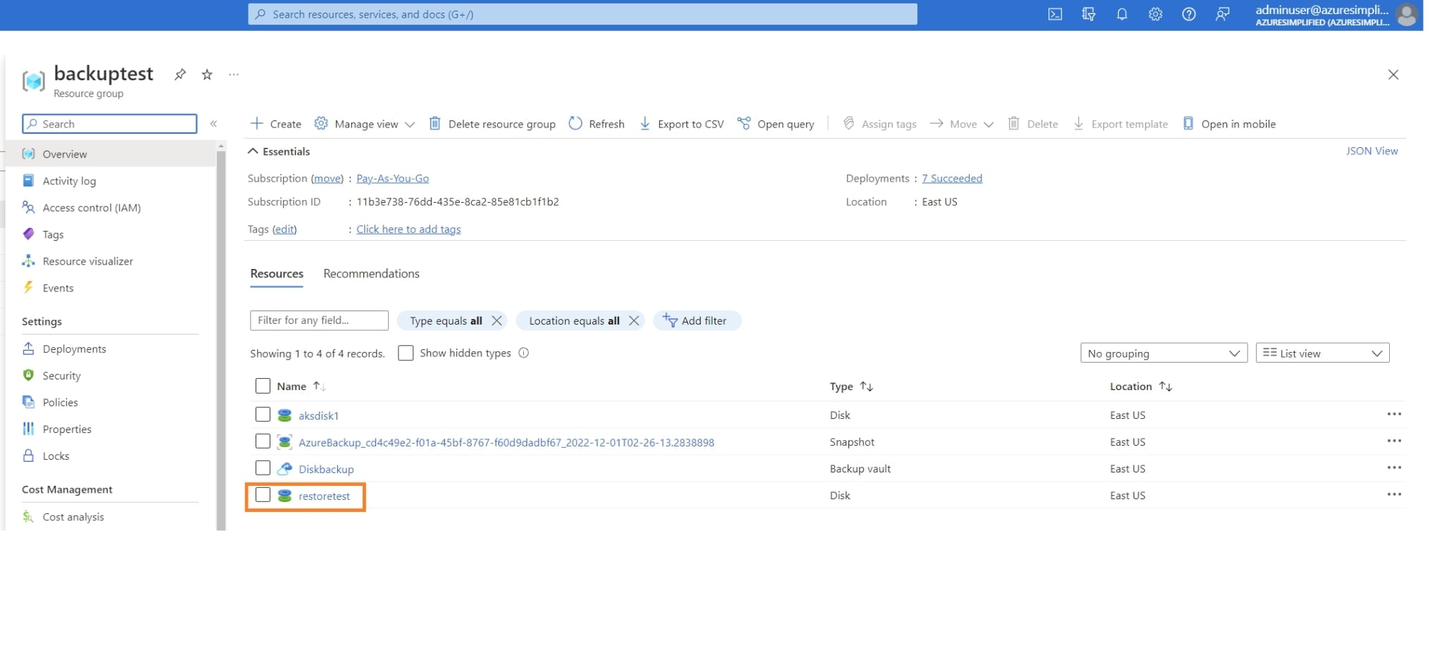

  • Once the restore process is completed, you should be able to see the disk in the target resource group.
  • cvo 576 27
    As part of your AKS recovery process, this can then be attached to a new or an existing cluster. For more on how to attach a persistent volume to an AKS cluster, check out Azure Kubernetes Service: Configuring Persistent Volumes in AKS.
