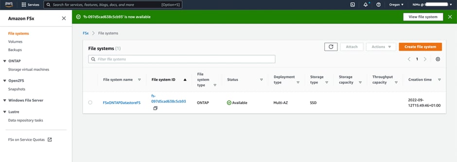

  1. Create Amazon FSx for ONTAP in a designated VPC.
    To create and mount the Amazon FSx for NetApp ONTAP file system, open the Amazon FSx console at https://console.aws.amazon.com/fsx/, select Create file system, and specify the SSD storage capacity, provisioned SSD IOPs, and throughput capacity based on your requirements.
    Note: If you are not sure about capacity or throughput, don’t worry. Start with a small capacity and throughput and then scale to whatever level is required. There is no need to add additional hosts or perform rebalancing, adding capacity and throughput only requires the click of a button.

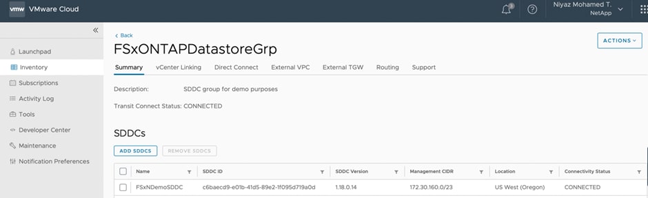

  • Create an SDDC group.
    After the file systems and SVMs have been created, use VMware Console to create an SDDC group. Adding the first member to an SDDC Group creates a VMware Managed Transit Gateway (VTGW) and assigns it to the group.

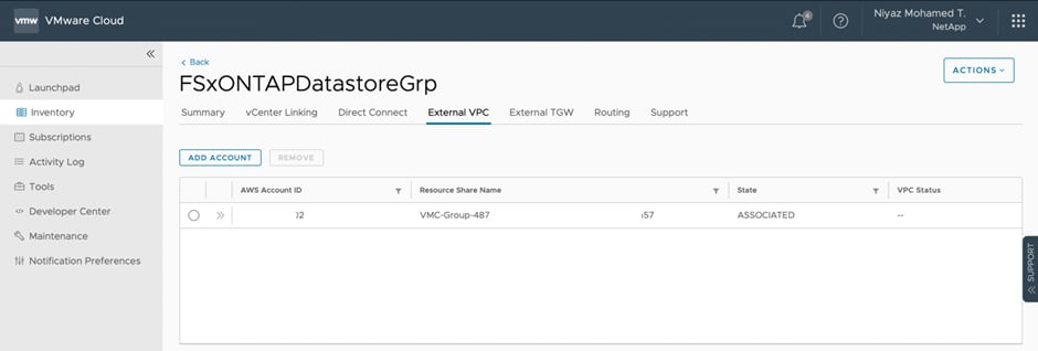

    Attach the newly created designated VPC to the SDDC group. To do so, select the External VPC tab within the VMware cloud console and follow these instructions for attaching an External VPC to the group. This process can take 10-15 minutes to complete.
    As part of the external VPC process, you are prompted via the AWS console to a new shared resource via the Resource Access Manager. The shared resource is the AWS Transit Gateway managed by VMware Transit Connect. Click Accept resource share.

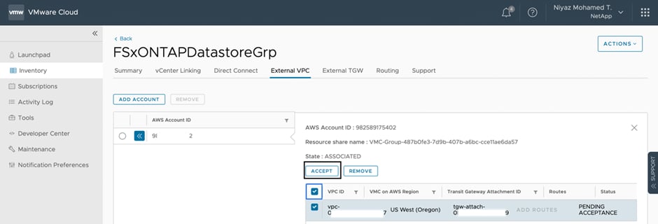

    After the External VPC is in an associated state, go back to the AWS Console, go to the VPC service page, and navigate to the VPC that was used for provisioning the FSx for ONTAP file system. Here you create a transit gateway attachment by clicking Transit Gateway Attachment in the navigation pane on the right.
    Make sure that DNS Support is checked under VPC Attachment and select the VPC in which FSx for ONTAP was deployed. After this is complete, switch to VMware Cloud Console, navigate back to the SDDC Group > External VPC tab. Select the AWS account ID used for FSx, select the VPC, and click Accept.
    blog4 Oct 20 2022 10 37 45 31 AM
    Select the Routes column, click the Add Routes option, and add the required routes:
    • A route for the floating IP range for Amazon FSx for the NetApp ONTAP floating IPs.
    • A route for the newly created external VPC (designated VPC for FSx for ONTAP) address space.

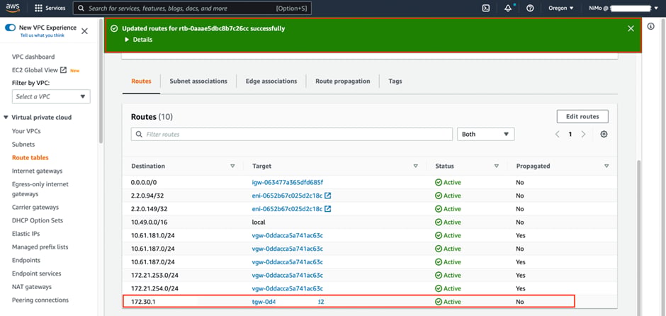

    Back in the AWS console, create the route back to the SDDC by locating the designated VPC in the VPC service page and select the main route table for the VPC.
  • blog5 Oct 20 2022 10 37 53 86 AM
    Also update the inbound rule of the security group associated with the FSx for ONTAP filesystem to allow the CIDR block of the SDDC infrastructure. Make sure NFS and ICMP traffic is enabled from the SDDC CIDR to avoid connectivity issues.

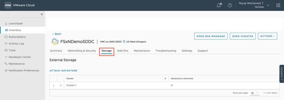

    1. In the VMC Console, open the Storage tab of the SDDC.
  • blog6 Oct 20 2022 10 38 04 39 AM

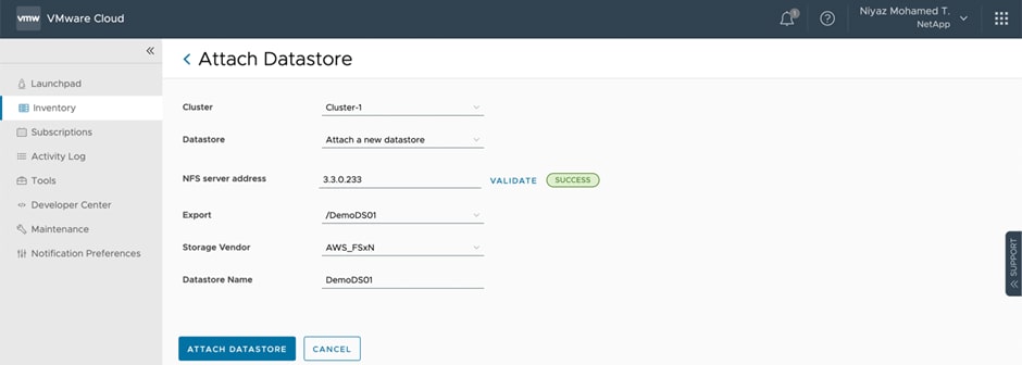

  • Click ATTACH DATASTORE and fill in the required values.
  • blog7 Oct 20 2022 10 38 13 76 AM
    Note: NFS server address is the NFS IP address which can be found under the FSx > Storage virtual machines tab > Endpoints within AWS console.
  • Click ATTACH DATASTORE to attach the datastore to the cluster.

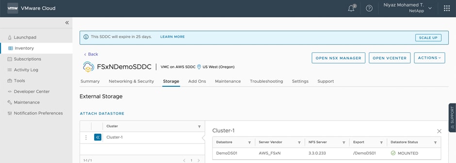

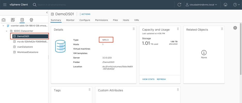

  • Validate the NFS datastore by accessing vCenter as shown below:
  • blog9 Oct 20 2022 10 38 28 20 AM
