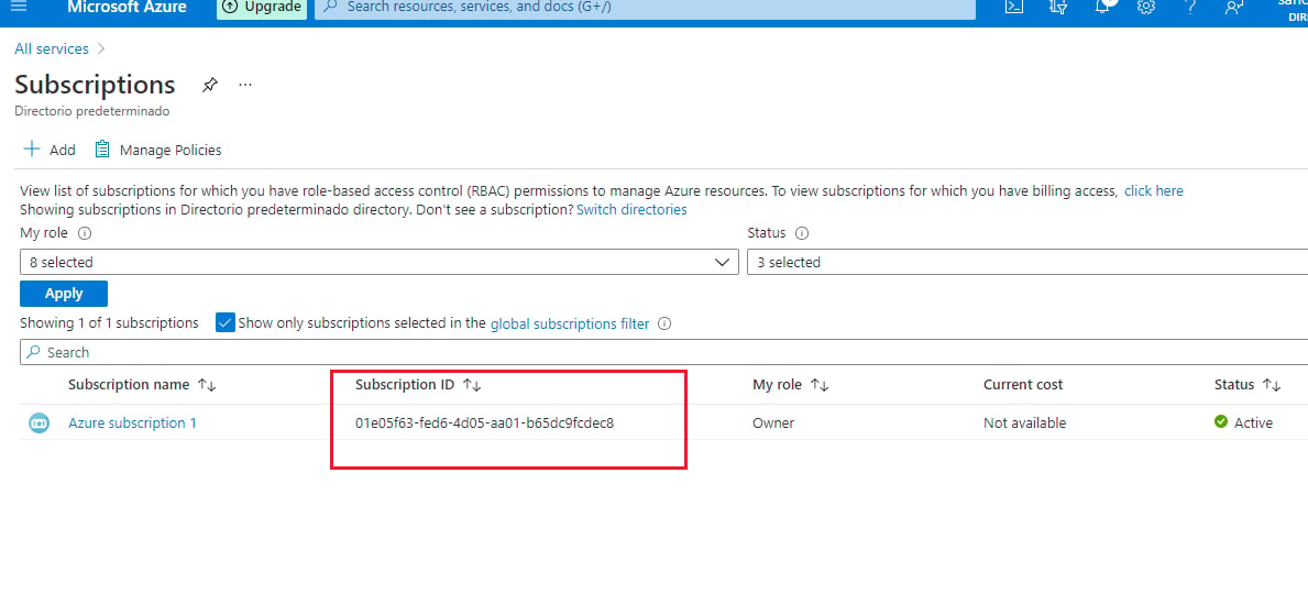

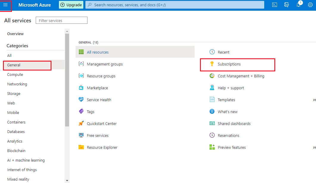

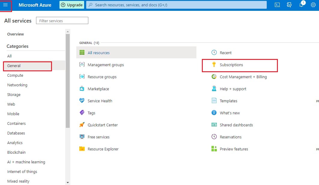

  2. Now you need to add your Azure subscription ID in the JSON file. Your Azure subscription ID can be found in Azure portal > All Services > Subscriptions > your subscription name.
s1
Now copy the subscription id you find there:
s2

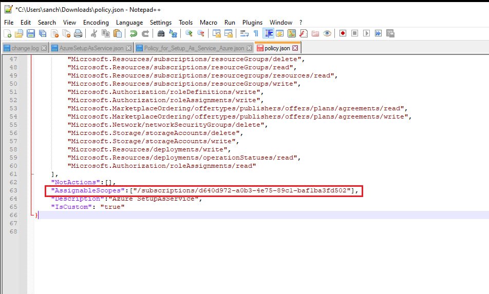

  1. Edit the JSON file downloaded in Step 1 and update the AssignableScope line at the bottom with your subscription id. Make sure to update it with the following format or else the JSON file will return a parsing error:
"AssignableScopes":["/subscriptions/d640d972-xxxx-xxxx-xxxx-xxxxba3fd502"]
s11
Save the file. You now have a custom role called Azure SetupAsService. In the following steps we will upload the new role to your Azure portal.

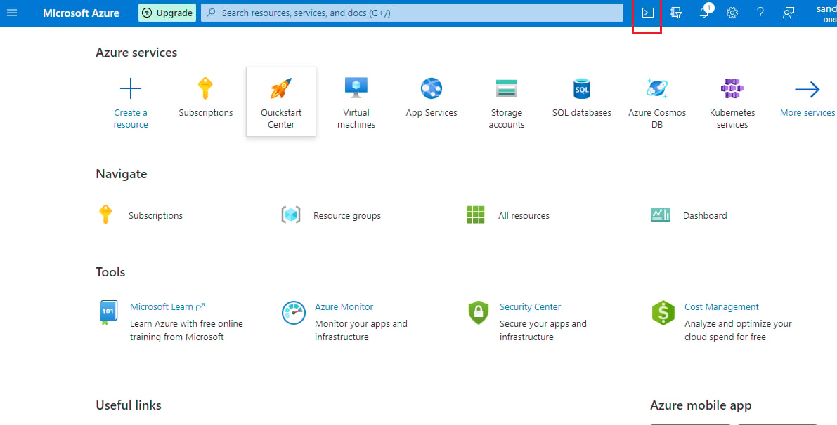

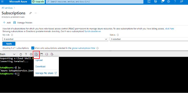

  1. Click on Azure Cloud Shell in the Azure portal:
s3 1
  1. Click the upload option in the Cloud Shell to upload the JSON file:
Picture1 Oct 10 2021 09 00 02 01 AM

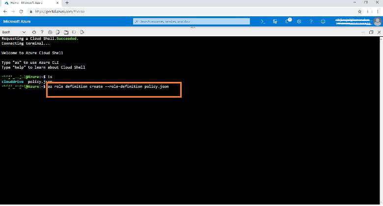

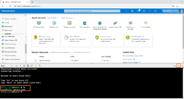

  1. Once the upload is complete, type the command ls in Cloud Shell. The policy file will be available in the home folder. You can click on the maximize icon on the left-hand side to expand Azure Cloud Shell to full screen:
Picture1 Oct 10 2021 09 01 36 40 AM
  1. Run the following command from Cloud Shell:
az role definition create --role-definition your_file_name.json
Picture1 Oct 10 2021 09 03 06 31 AM
  1. On successful execution, the role details will be displayed in Cloud Shell:

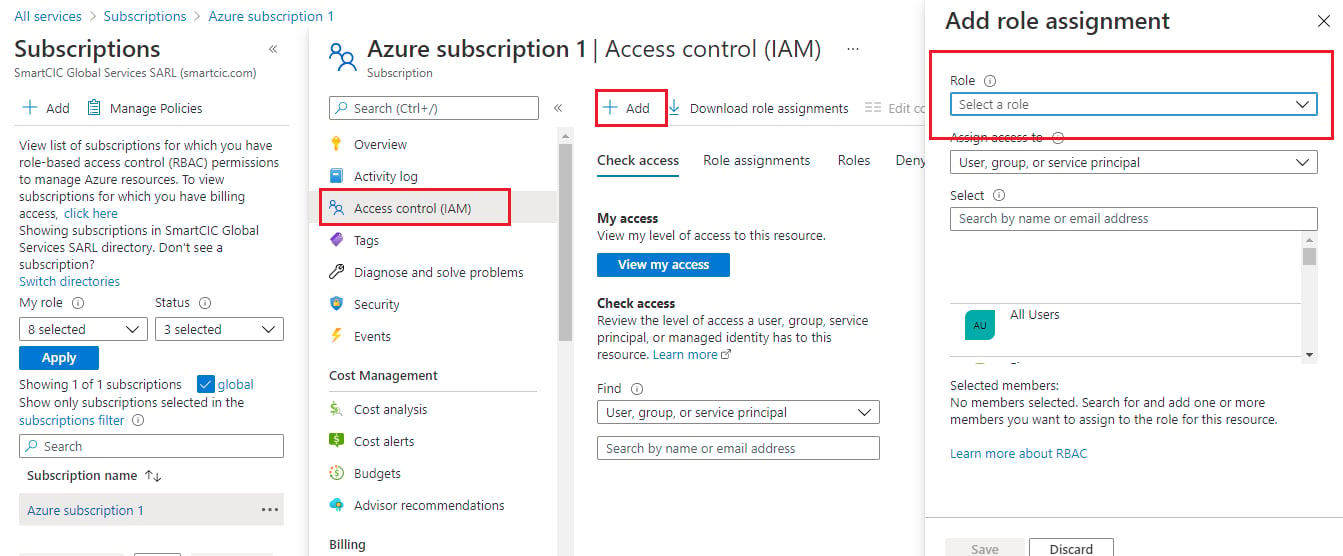

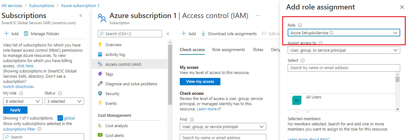

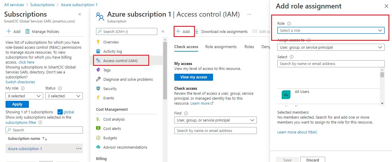

9. In the Azure portal go to All Services > Subscriptions > Select your subscription > Access control (IAM).
Click “+Add” and select “Add role assignment” from the drop-down menu:
s12

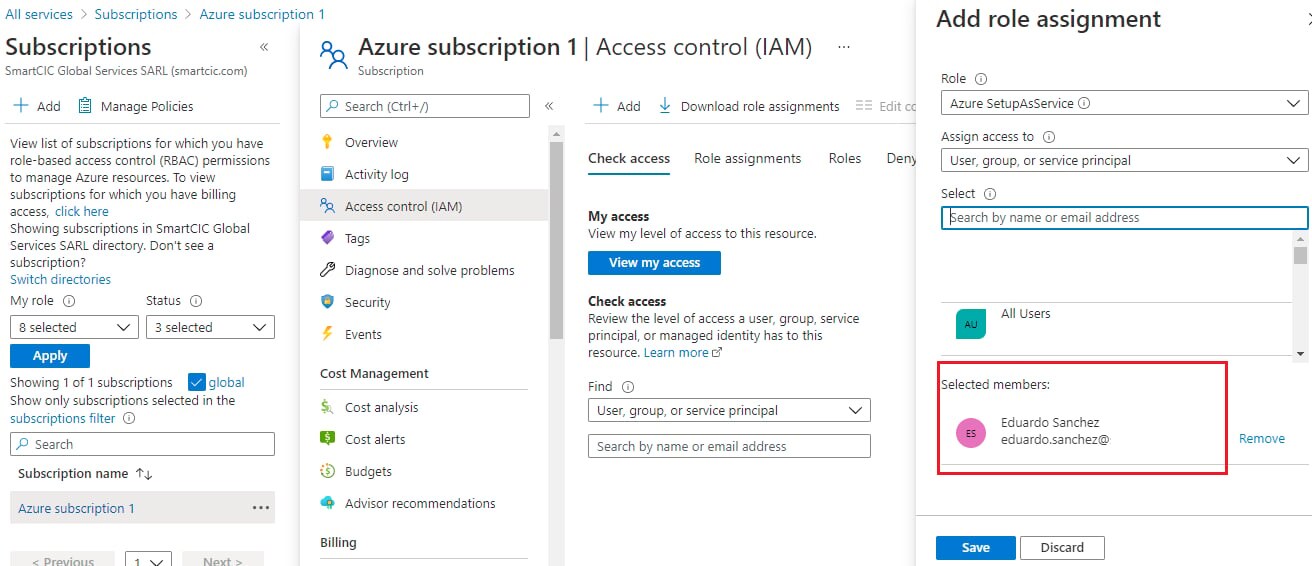

  1. From the Roles drop-down menu, select the “Azure SetupAsService” role we created in Step 8:
s13

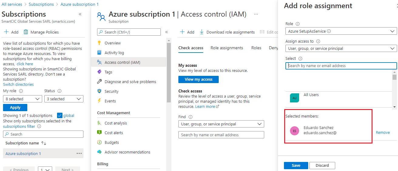

  1. Search for the Azure user account that you want to use to deploy the Service Connector and click “Save” to complete the role assignment:
s14
The user now has the permissions needed to deploy the Service Connector instance in Azure.

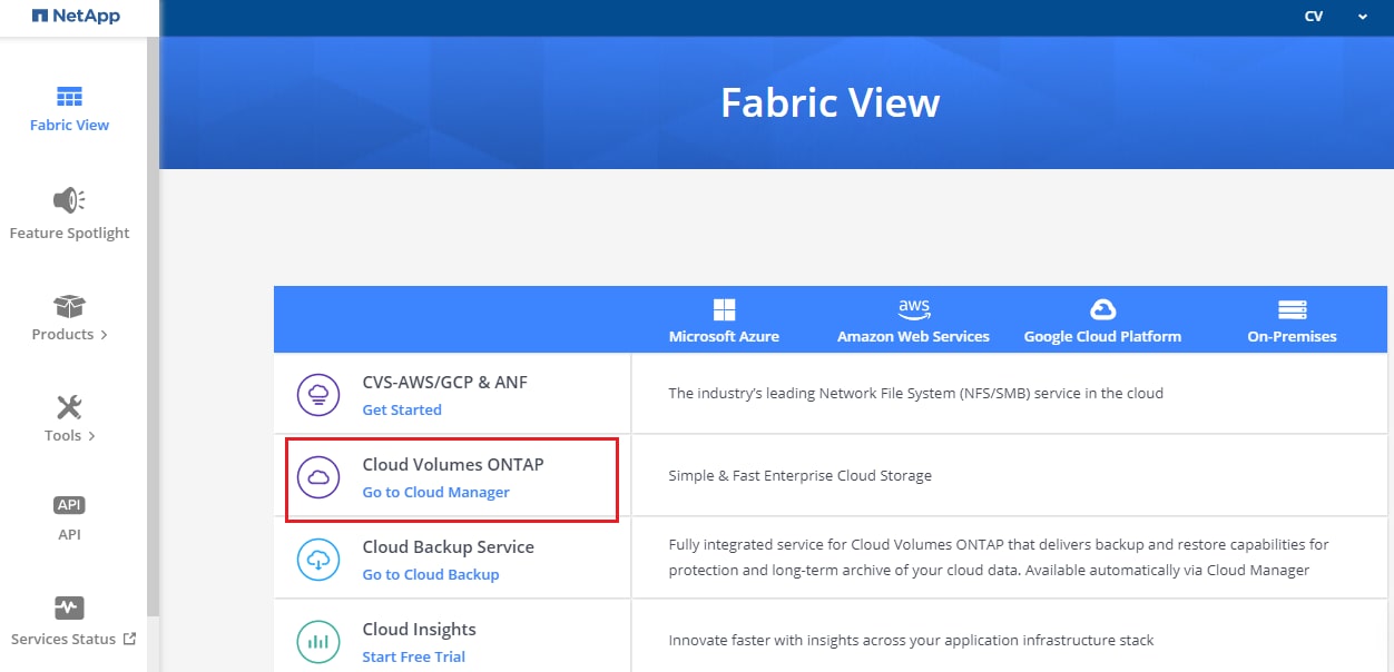

  1. Sign up and log in to NetApp Cloud Central.
  1. In the Fabric View, click on “Go to Cloud Manager” under Cloud Volumes ONTAP:
s5

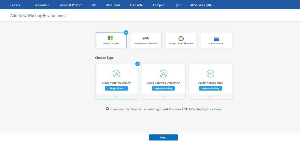

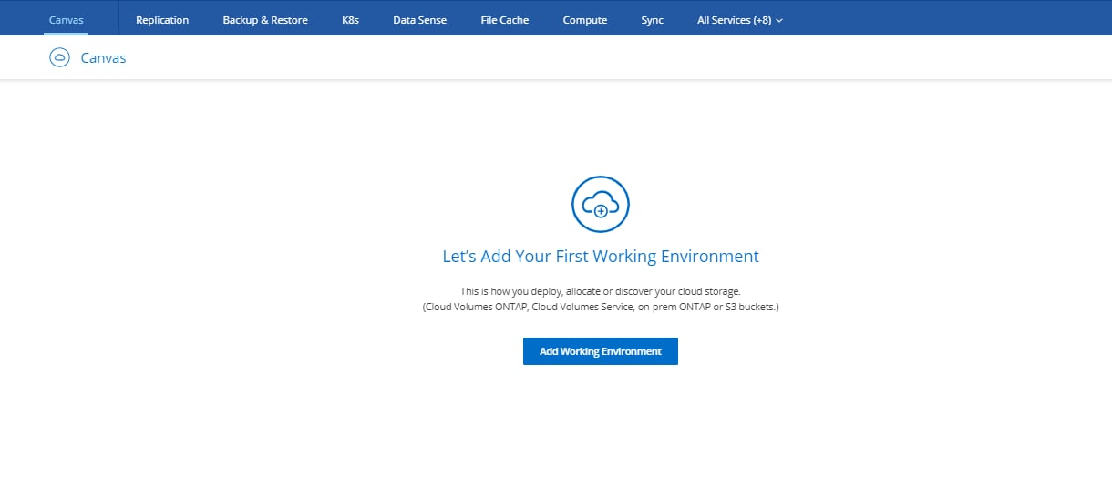

  1. Click on “Add Working Environment”:
s6

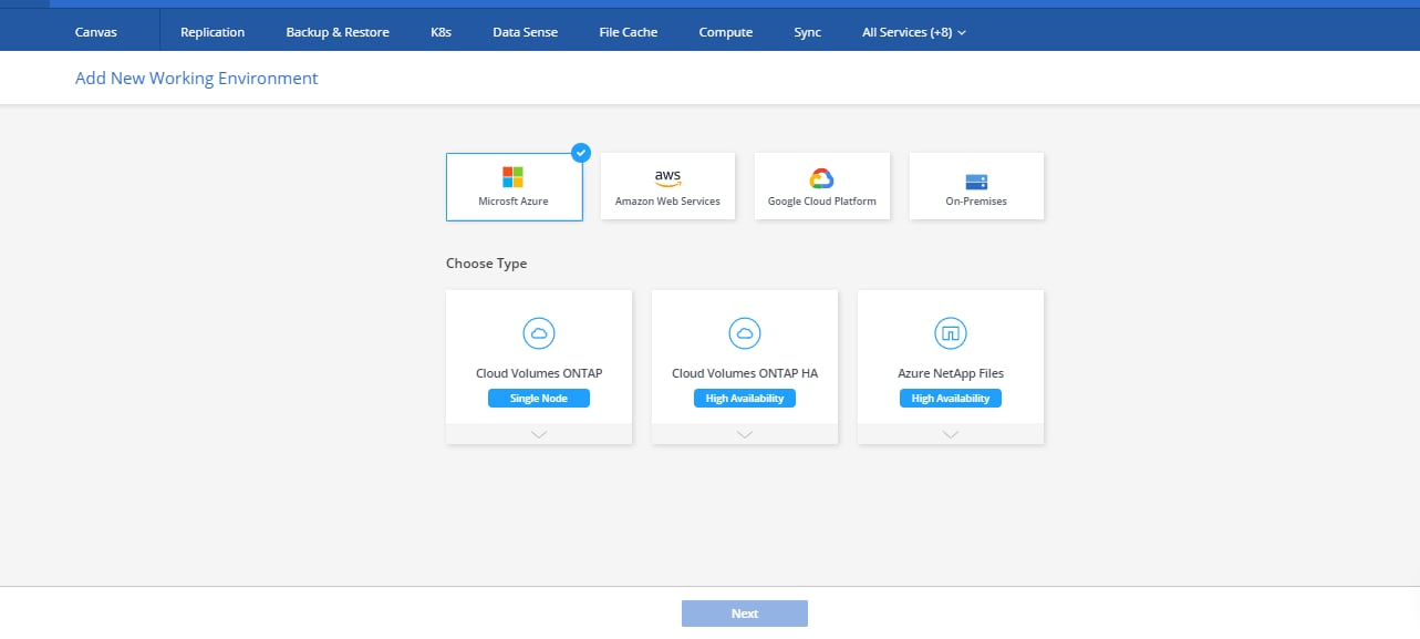

  1. Select Microsoft Azure as the provider and the Cloud Volumes ONTAP mode you want (either single-node or high availability). Click “Next” to proceed:
s7

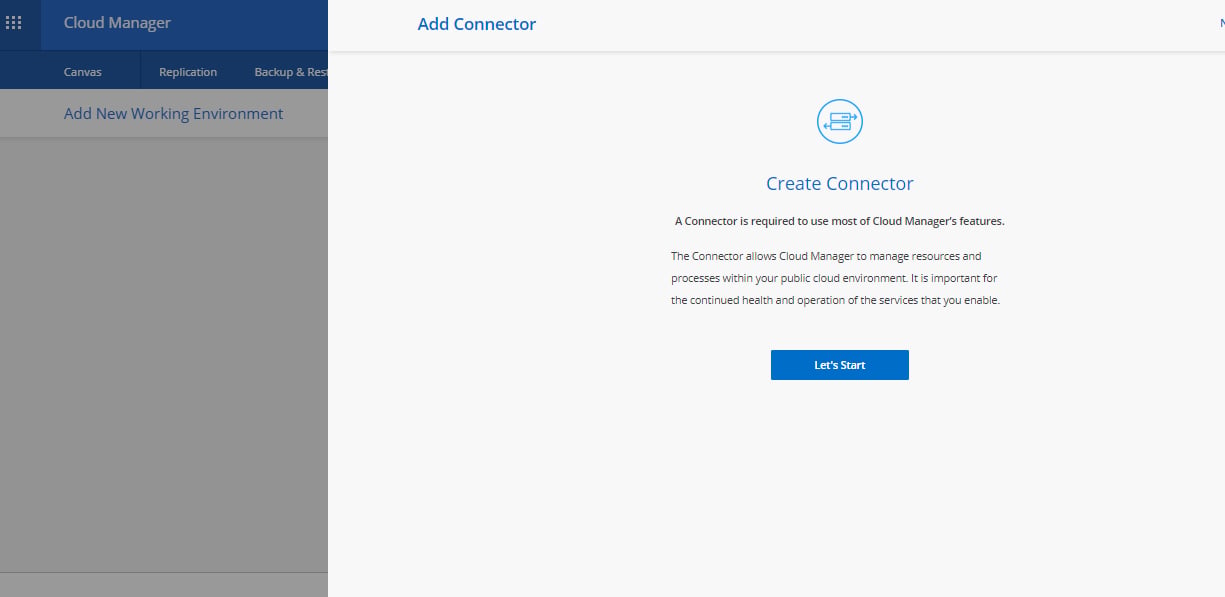

  1. As mentioned in our prerequisites section, the first time you deploy Cloud Volumes ONTAP, you'll be prompted to create a Service Connector first.
    In the previous section we created a custom role that gave us permissions to create this Service Connector instance from Cloud Manager.
    Click on “Let's Start”:
s8

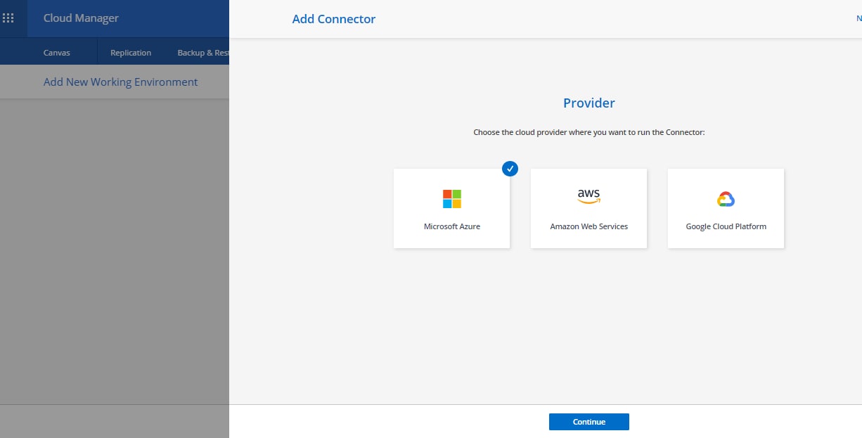

  1. Select Microsoft Azure as the provider. Click “Continue”:
s9

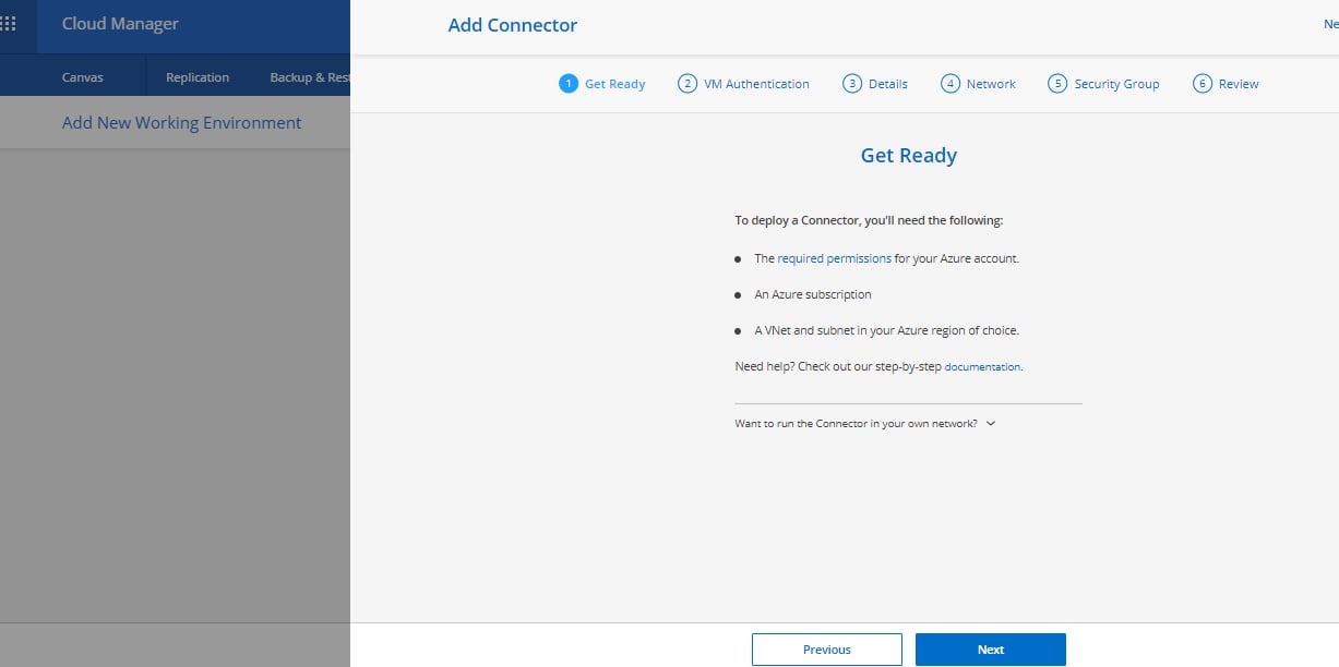

  1. On the Get Ready screen, click on “Next”:
s10

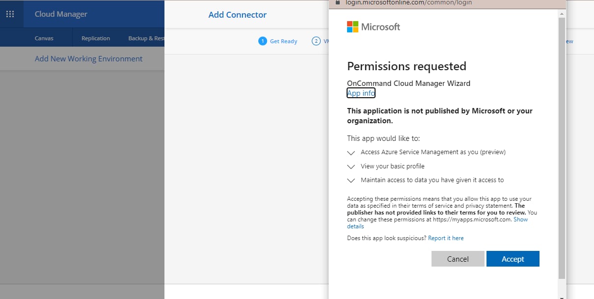

  1. Now you will need to select an Azure account in order to log in. After you select the account, a window will pop up prompting you to accept the required permissions. Click on “Accept”:
s15

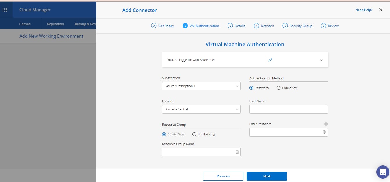

  1. You will now be directed to the Virtual Machine Authentication screen. Here you need to provide the following details:
    • Your Azure subscription
    • Azure region
    • Authentication method, username, and password for access to the VM, in case it is needed.
    • Resource Group: If you select “Create New” in this field, Cloud Manager creates a new Resource Group for you. It is recommended to deploy a new Resource Group only for Cloud Volumes ONTAP because there is potential for data loss if, for example, another Azure user accidentally deletes a Cloud Volumes ONTAP resource from an existing shared Resource Group.
Provide all the details above and click “Next”:

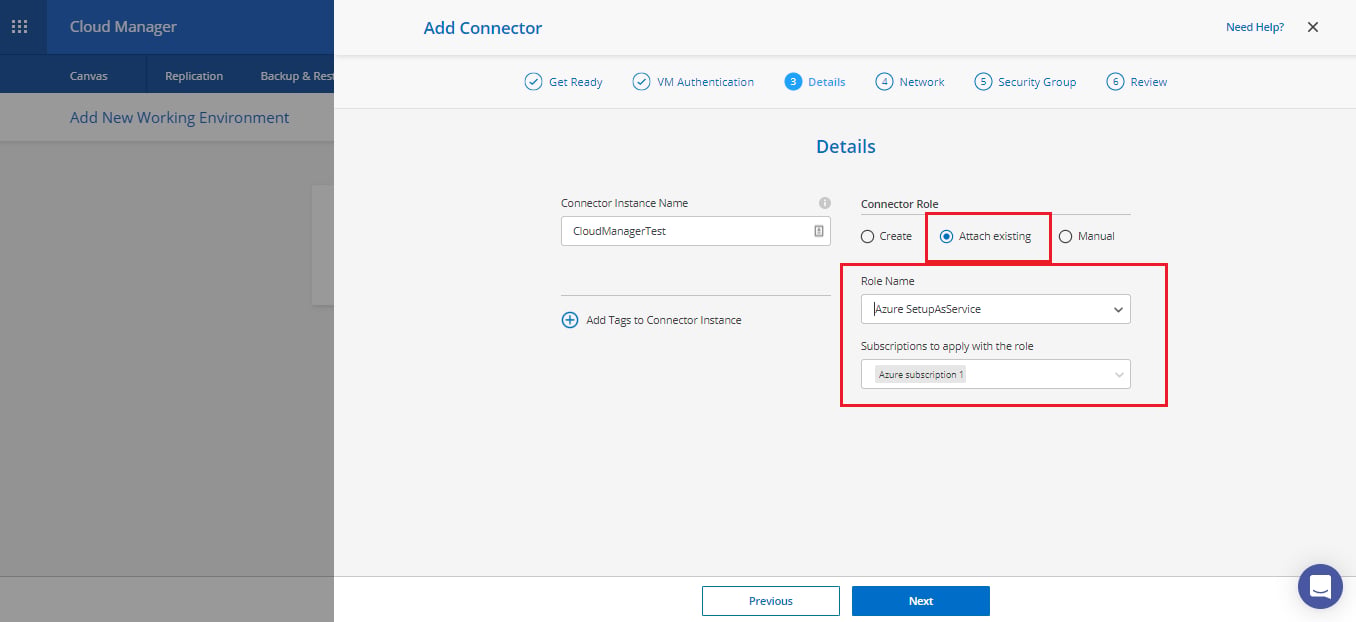

    • Service Connector instance name
    • Connector role: Select the role you created in the previous section of this blog. In our case, we are choosing “Attach existing.”
    • Azure subscription associated with the role
    • Tags to the Connector instance, if any
When you’re done, click “Next”:

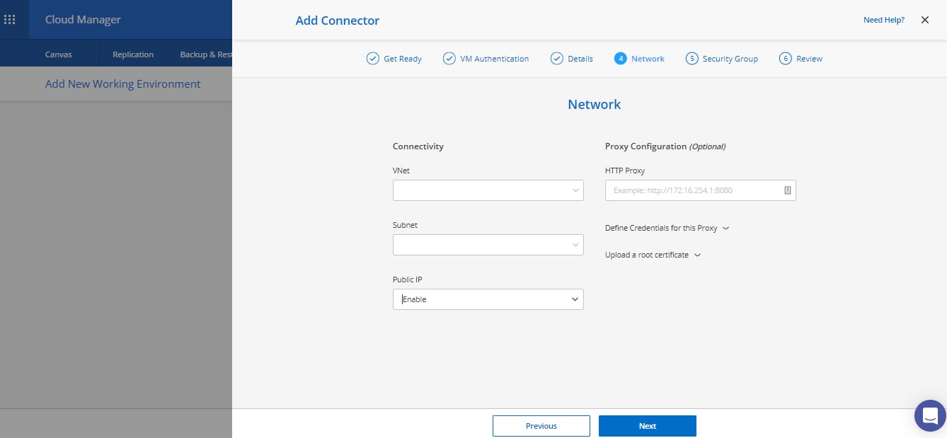

  1. Select a VNet and subnet, whether to enable or disable a public IP address, and a proxy server, if needed. Then click “Next”:

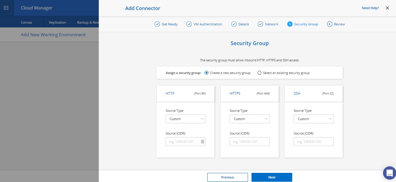

  1. Choose between adding a new Security Group for the Connector instance (which Cloud Manager creates for you) or select an existing one.
In either case, the Security Group must allow inbound HTTP, HTTPS and SSH. This in case the Connector instance needs to be managed or accessed. When you’re done, click “Next”:
s19

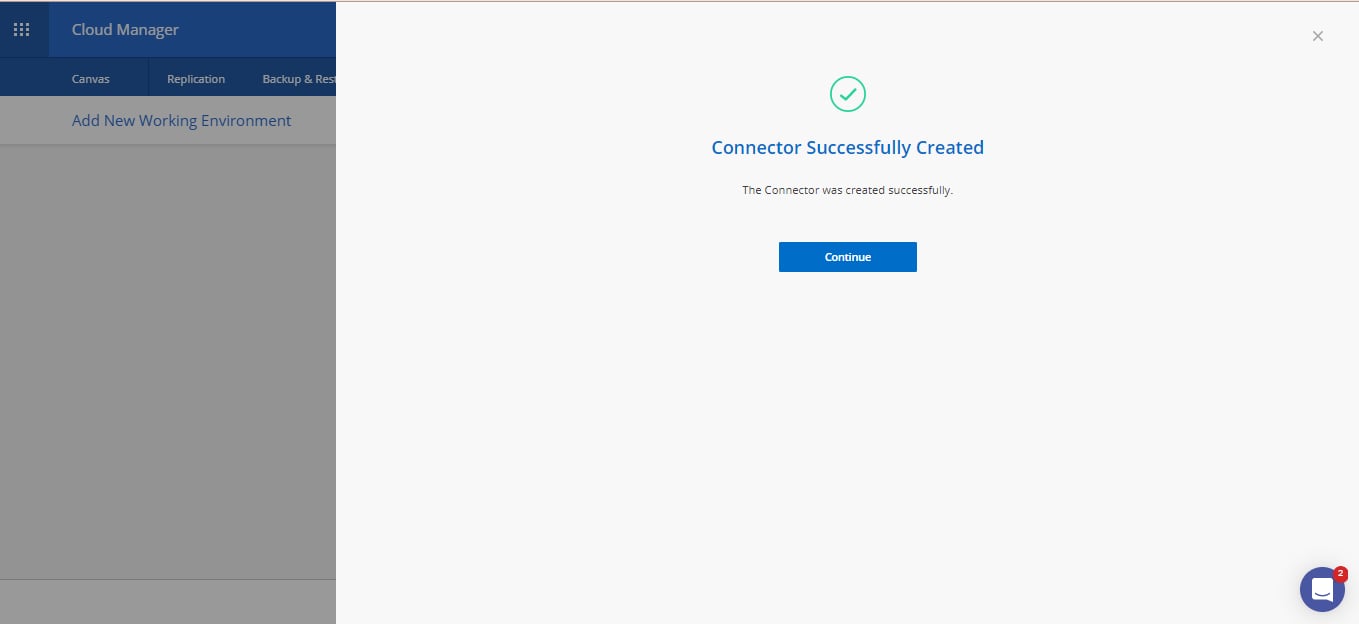

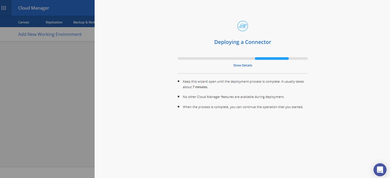

  1. Review all your settings and click “Add” if everything is correct. This will start the Service Connector instance deployment. Leave the Wizard open during the duration of this process, which can take around seven minutes to complete:
s21
Once finished, click “Continue”:
s22

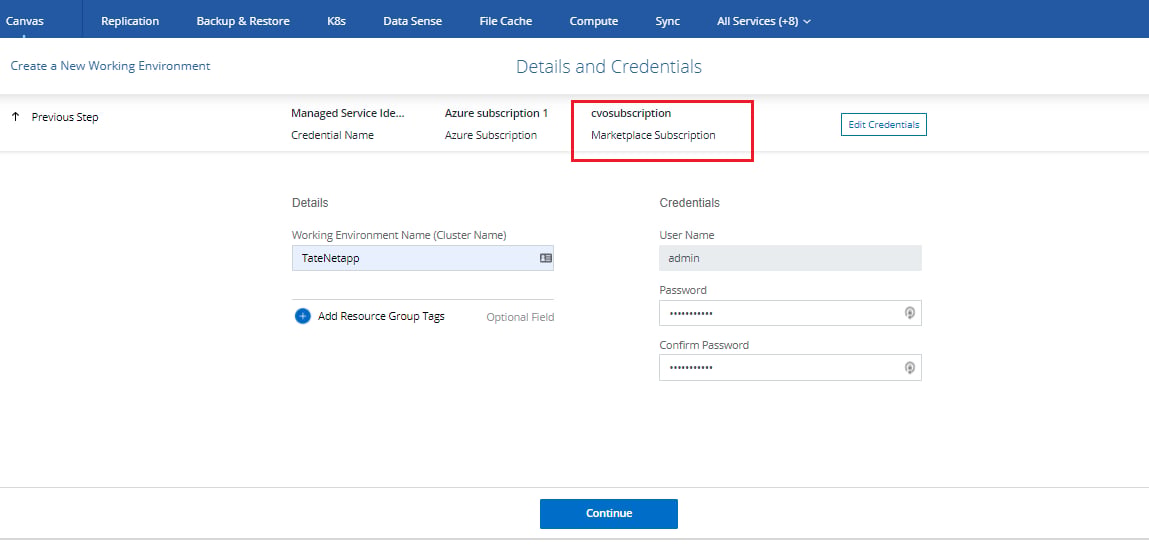

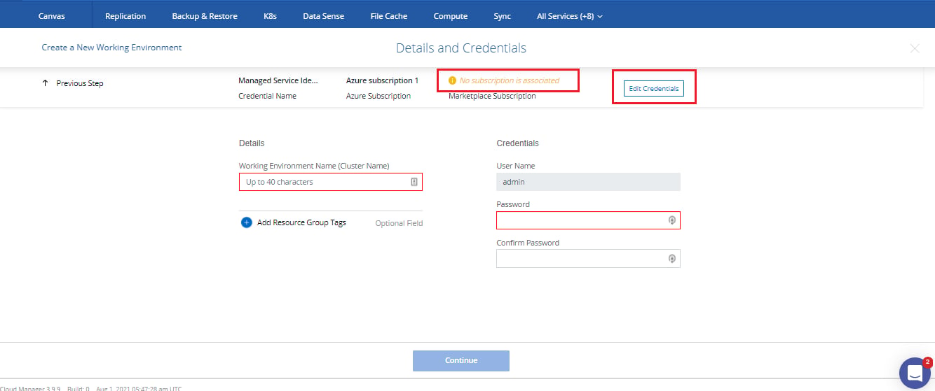

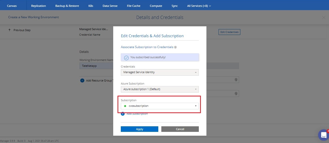

  1. Besides giving a name for your cluster and the credentials to access it, in this step you need to associate an Azure Marketplace subscription with the selected Azure subscription if you intend to use the Pay-as-you-go model for Cloud Volumes ONTAP.
If no Marketplace subscription is associated, you will see the notification in yellow at the top right. Click on “Edit Credentials”:
s24

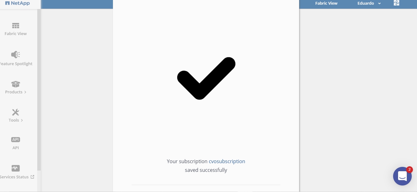

Follow this video on how to complete the rest of the Marketplace subscription steps.

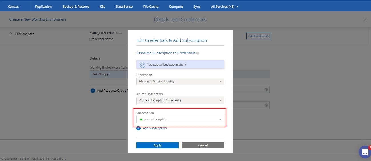

After completing the steps shown in the video, you'll be redirected in a separate tab to Cloud Manager, where you'll need to save the subscription:
s26
Go back to the Cloud Volumes ONTAP deployment wizard. You'll now see a window prompt with the Marketplace subscription you just created. Click “Apply”:
s28
With the subscription now associated, click on “Continue”:
s29

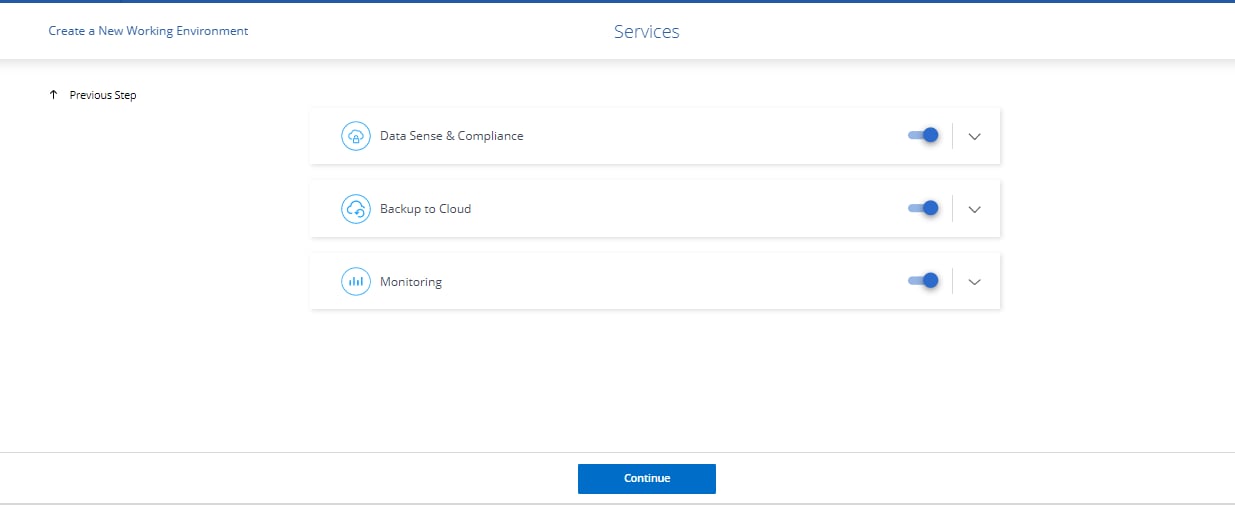

  1. Choose to enable or disable any of the additional NetApp Cloud services complementary to Cloud Volumes ONTAP and click on “Continue”:
s30

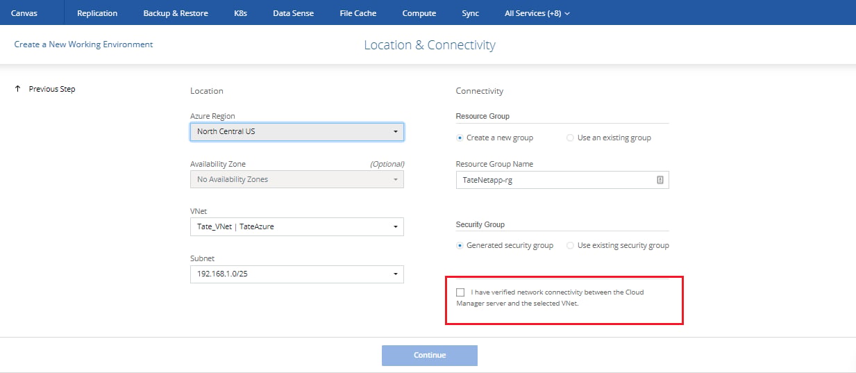

  1. In this step you need to provide:
    • Azure region (make sure it is the same region where you deployed the Service Connector)
    • Azure VNet and subnet with connectivity to the Service Connector
    • Resource Group (a new one is recommended)
    • Security Group. Creating a new security group is recommended. If you select an existing one, make sure it complies with these rules.
Check the box at the bottom right and click “Continue”:
s31

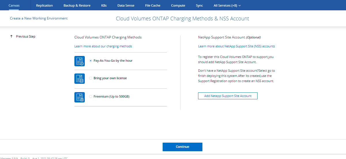

  1. Choose the ONTAP charging method and, optionally, subscribe to a NetApp Support account (you can also do this one later from the NetApp site). You can learn more about Cloud Volume ONTAP charging methods here.
When you’re done, click “Continue”:
s32

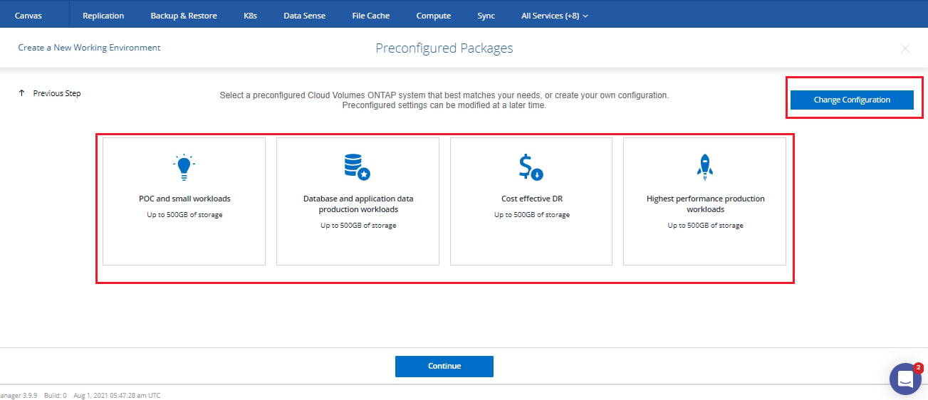

  1. Select from one of the pre-configured packages that come with optimized disk types, capacity, and VM types for specific workloads. If you select one of these pre-configured packages, you will only need to specify a volume and then review the whole deployment.
    If you instead choose “Change Configuration,” you will need to complete a few additional steps by specifying VM Type, SSD type, disk size, data tiering, and write speed:
s33

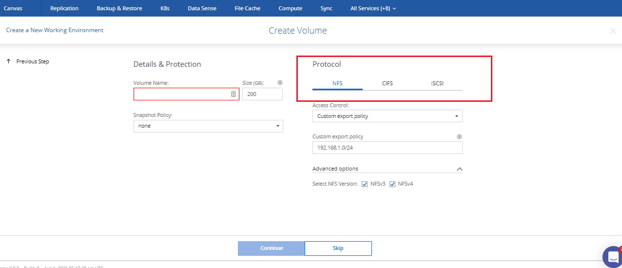

  1. In this step you can create an initial volume in your Cloud Volumes ONTAP cluster deployment and specify the multi-protocol access control options.
You can also skip this step and create a volume later. Click either on “Continue” or “Skip”:
s34

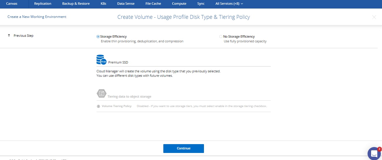

  1. When creating an initial volume, select whether or not to enable storage efficiencies and data tiering details, if needed:
s35

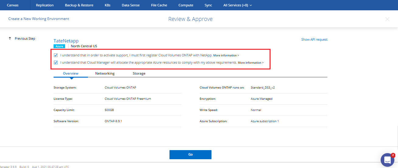

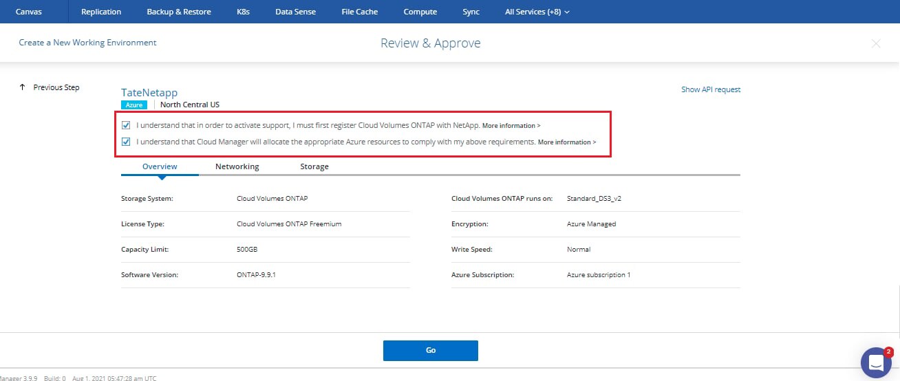

  1. Review all of your configuration settings for this deployment and check both boxes at the top. Click “Go”. This will start the Cloud Volumes ONTAP deployment:
s36

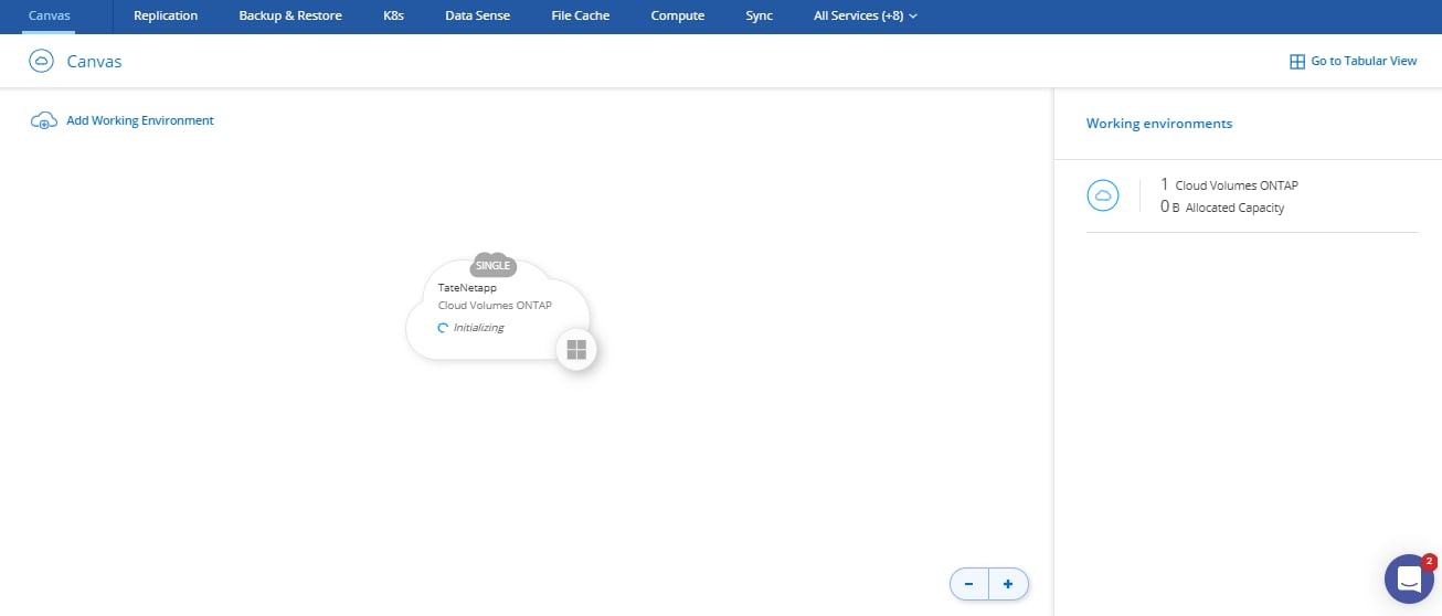

You will see the screen below as the deployment starts. The entire process should take about 20 minutes.
s37

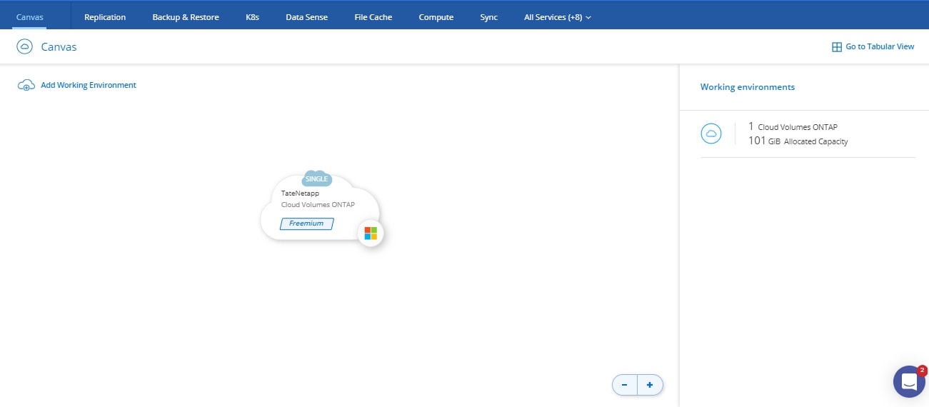

  1. One the deployment is completed you will be able to see the Cloud Volumes ONTAP instance on the Cloud Manager Canvas page. Click on it to start managing your Cloud Volumes ONTAP server in the Azure Cloud:
s38
