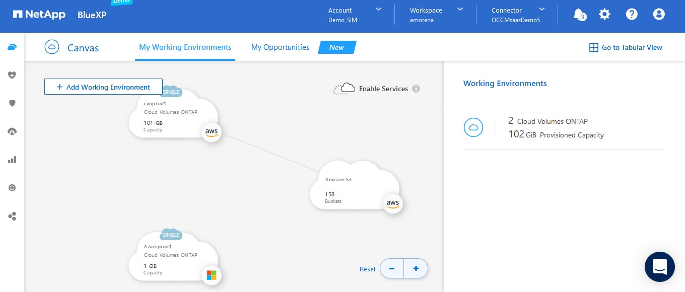

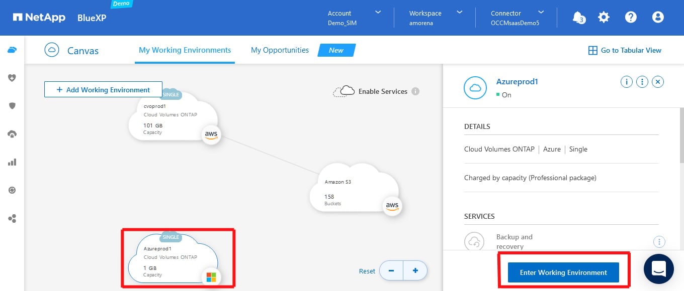

  1. On the BlueXP canvas you will see your current working environments listed as icons.
CVO613.1
2. Select Cloud Volumes ONTAP instance deployed in Azure and then click the “Enter Working Environment” button in the details panel.
CVO613.2

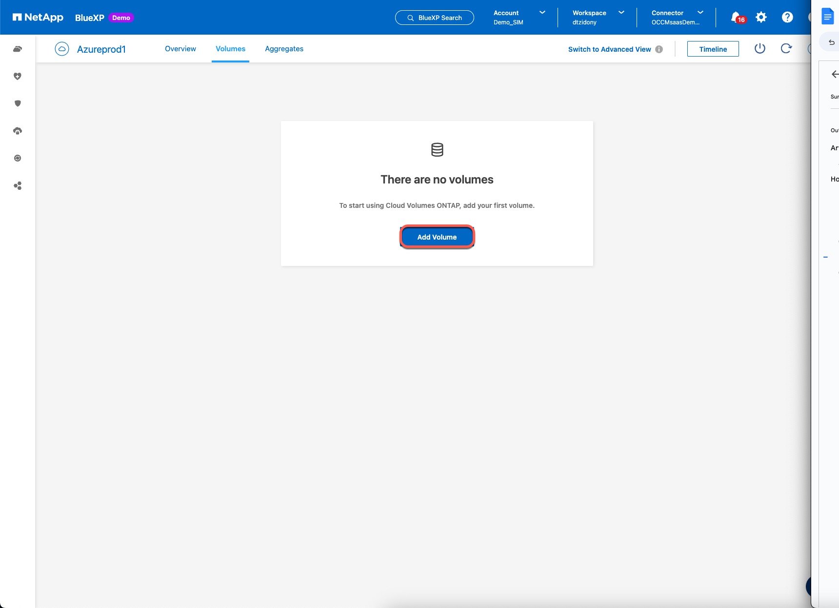

3. On the Azure instance’s details page, click the “Add volume” button, then select the option to create a new volume.

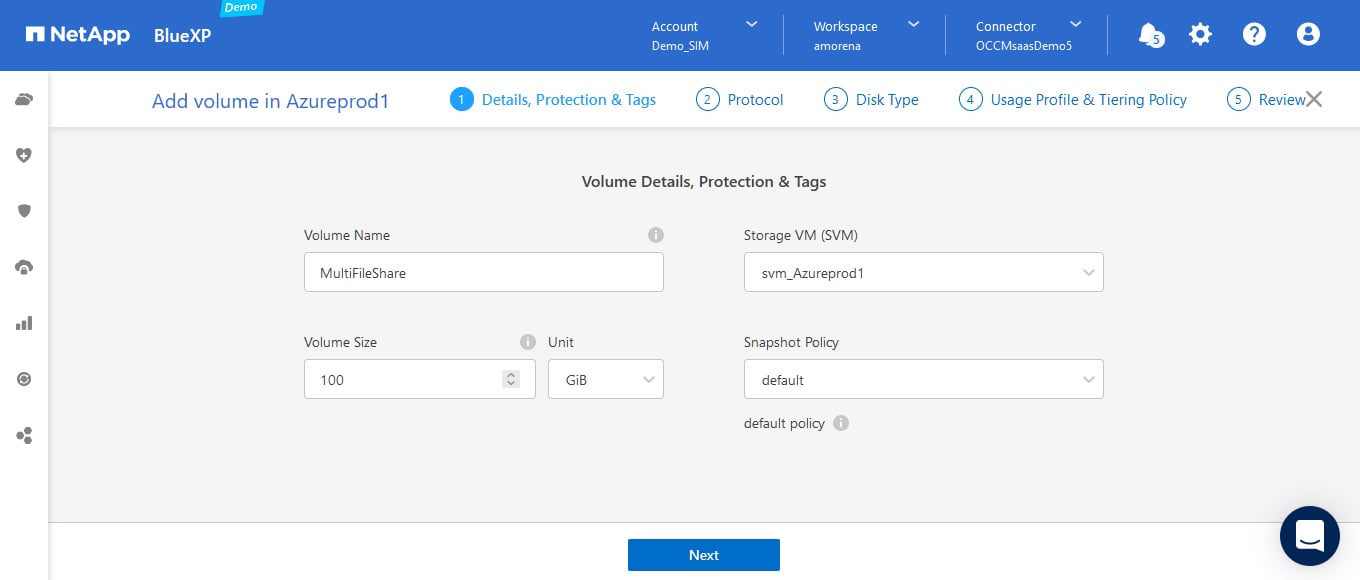

4. In the Volume Details, Protection & Tags step, enter in all of the volume information requested. When you are done, click “Next.”
CVO613.4

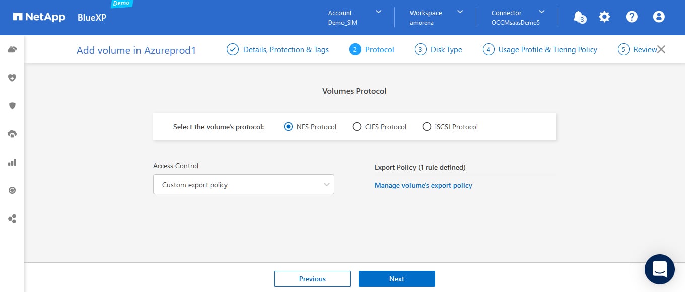

5. On the Protocols page we will select the NFS as our volume’s first protocol, then click “Next” to proceed.
CVO613.5

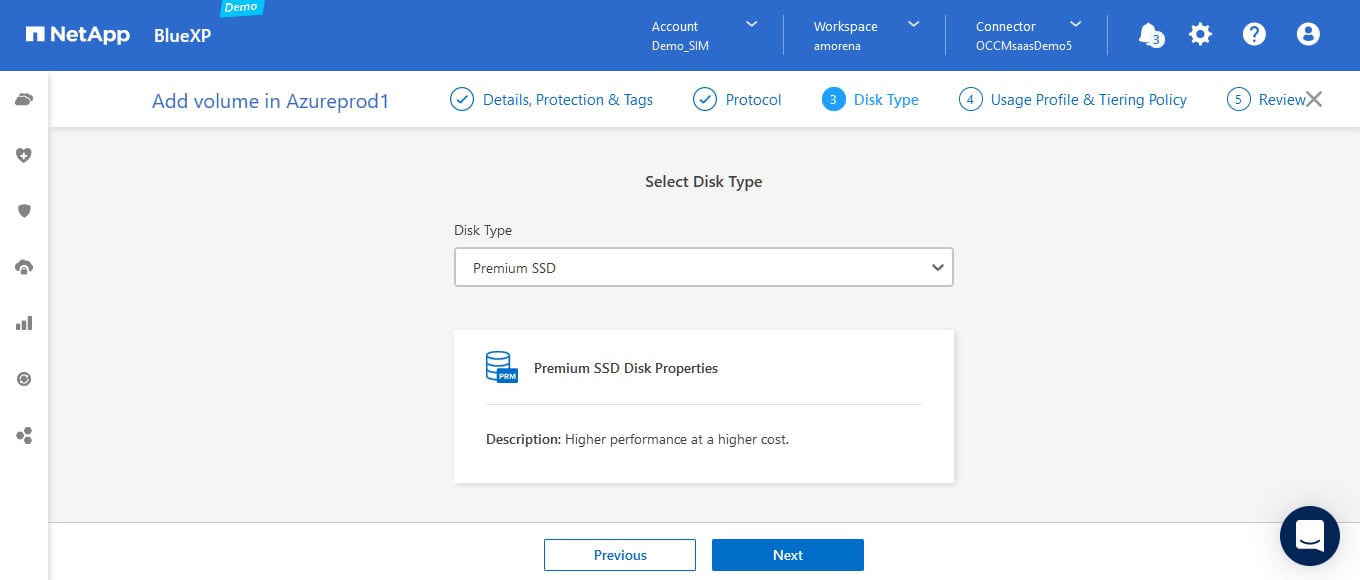

6. In this step, select your disk type. Since we are configuring this volume for file sharing, select the high performance SSD option.

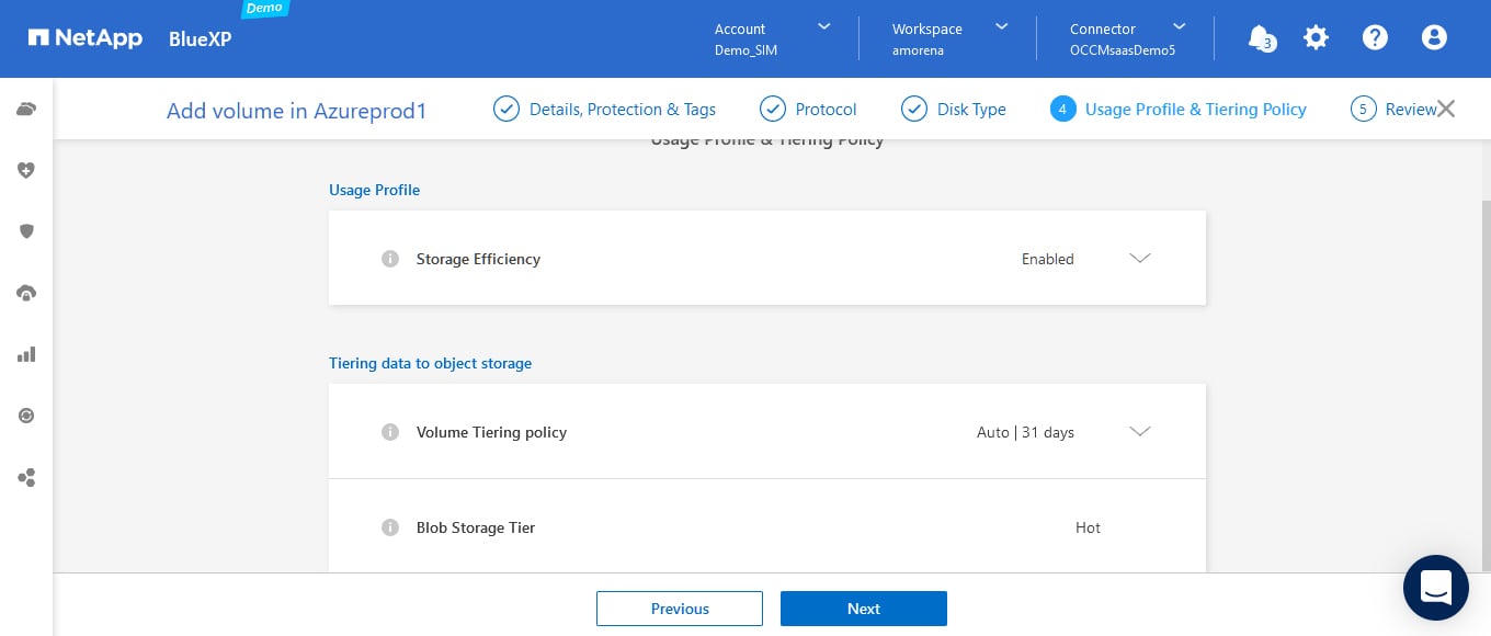

7. Choose the usage profile and tiering policy for the volume, then click “Next.”

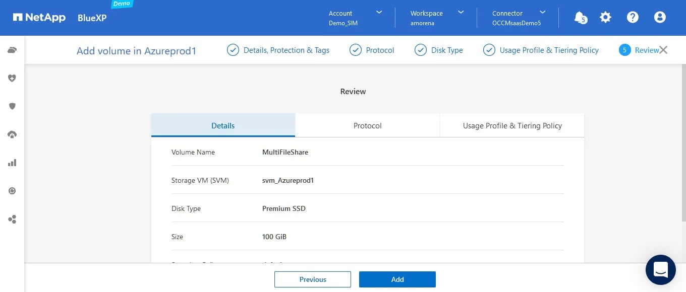

8. In the review stage, verify the volume creation. Finalize by clicking “Add.”
nfs-and-smb-cifs-enterprise-file-sharing-on-cloud-volumes-ontap IMG 8

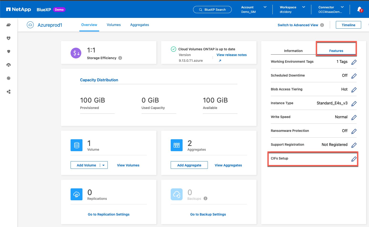

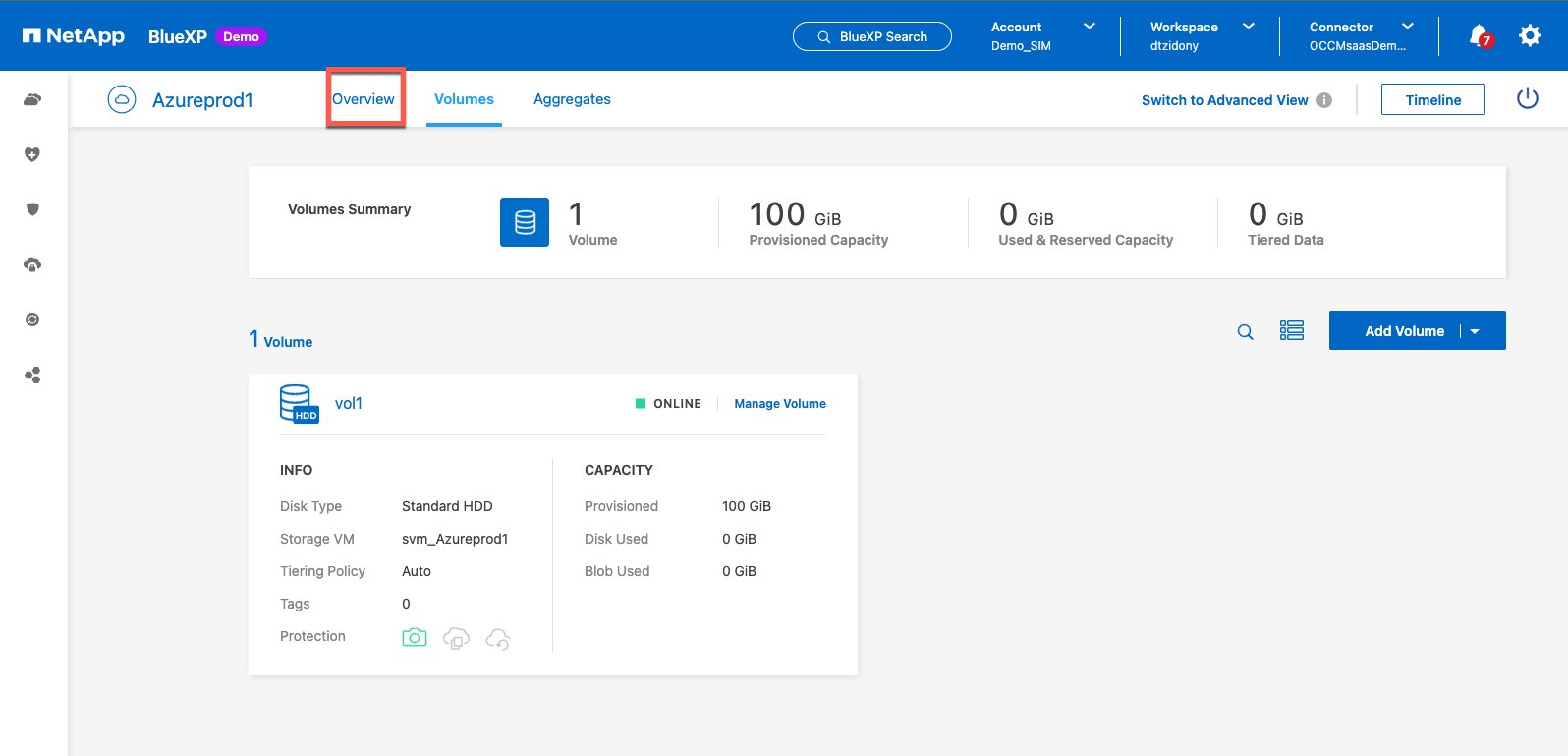

  1. Start by clicking on the Overview tab, as shown below.
CVO613.9
2. In the Overview tab, choose the Features Tab.
Find the option for “CIFS setup” at the bottom of the menu and select it.
CVO613.10

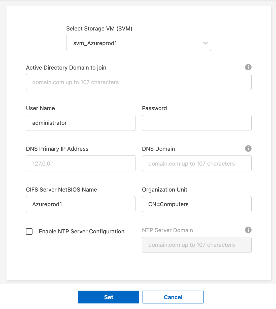

3. Add details for the DNS primary IP, secondary IP, the Active Directory domain, CIFS server NetBIOS name, your organizational unit, DNS domain, and your credentials to join the domain.
Once all the information is added, click “Set” to proceed.
CVO613.11
The working environment is now ready to be used via CIFS / SMB. You can continue to set an SMB share for the volume.

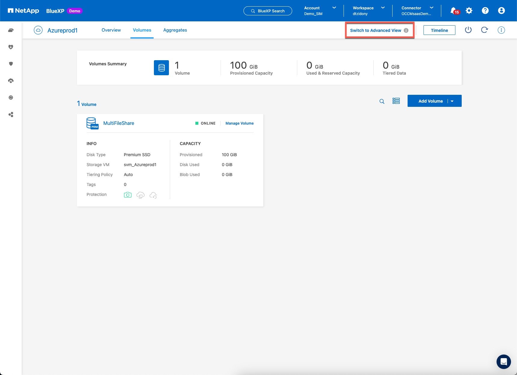

  1. From BlueXP, click on the working environment, then select the “Switch to Advanced View” button in the upper right.
CVO613.15

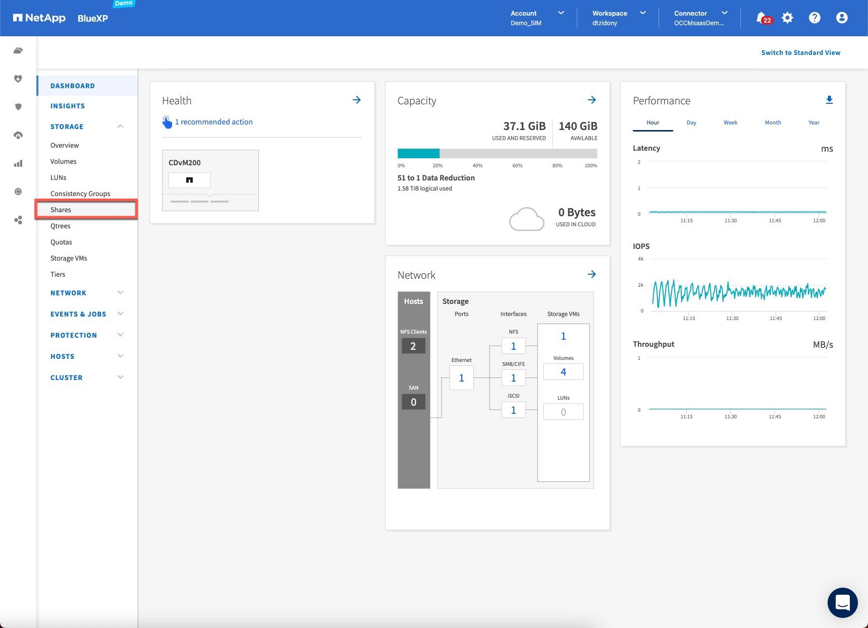

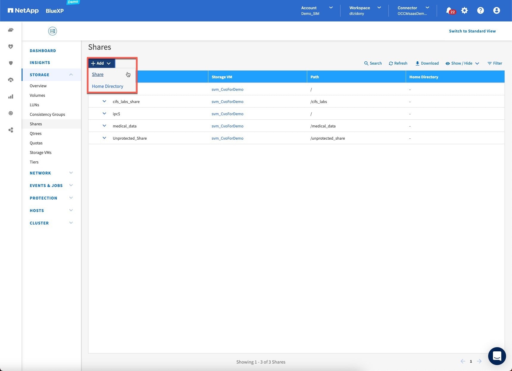

2. In System Manager, go to the left-side menu and expand the Storage menu options. Select “Shares” from the list.
CVO613.16
13. Click the “+Add” button in the upper left of the window, then select “Share.”
CVO613.17

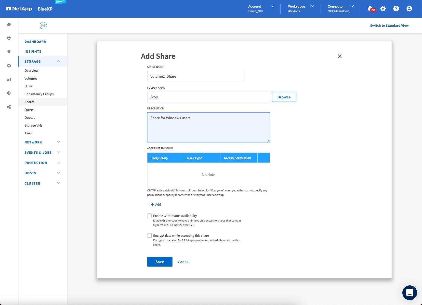

4. In the Add Share window, choose a name for the share, its access path, a description, and the access permission.
CVO613.18

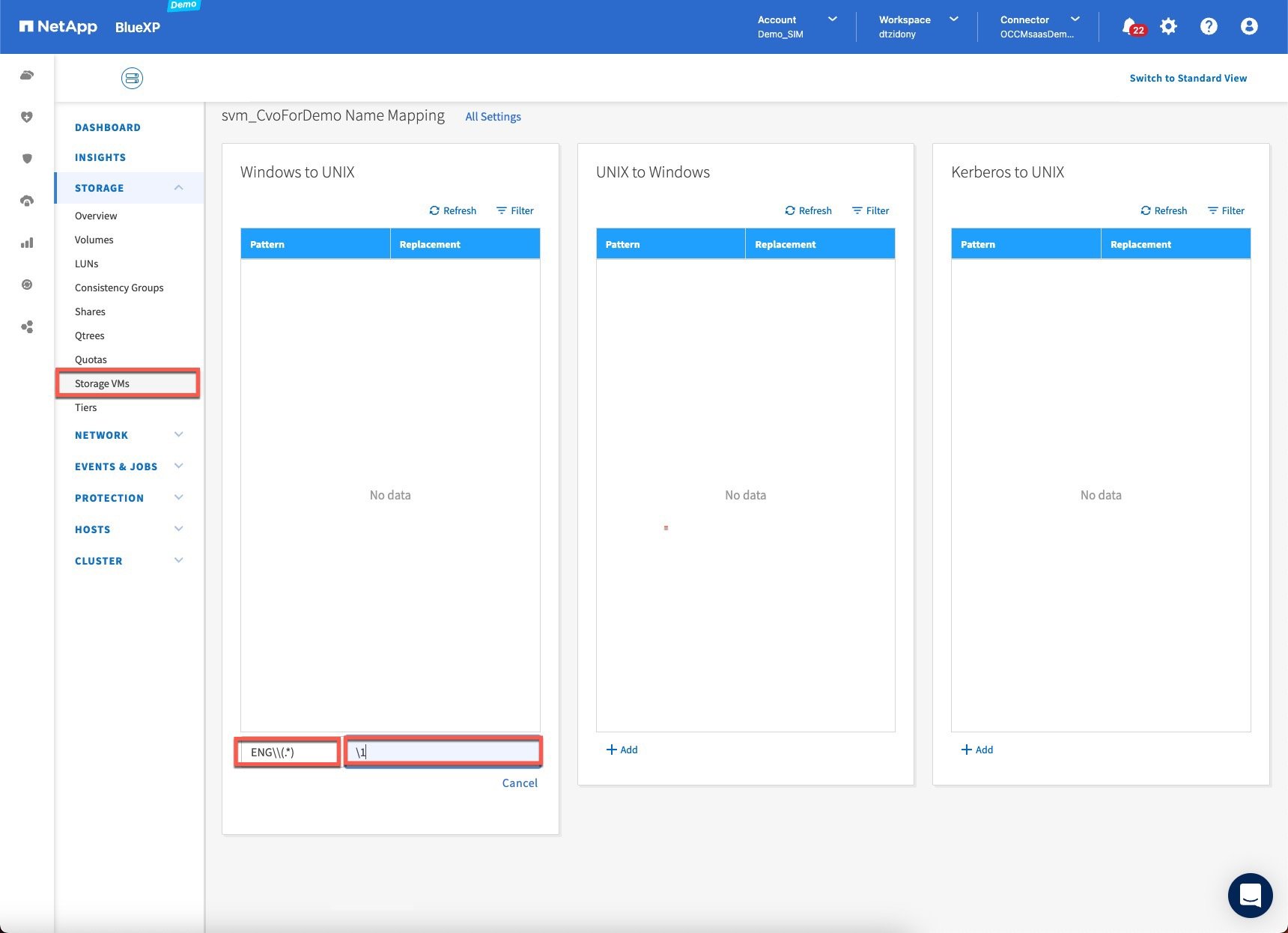

5. Next, we will configure username mapping for Windows and UNIX usernames. This will allow Windows users to access files on the share using UNIX file permissions and vice versa.
If individual-level file tracking is required, we recommend using a conversion rule of a 1:1 conversion of Windows users to UNIX users, and vice versa.You could also configure a default user mapping for all users not covered by a name-mapping or conversion rule.

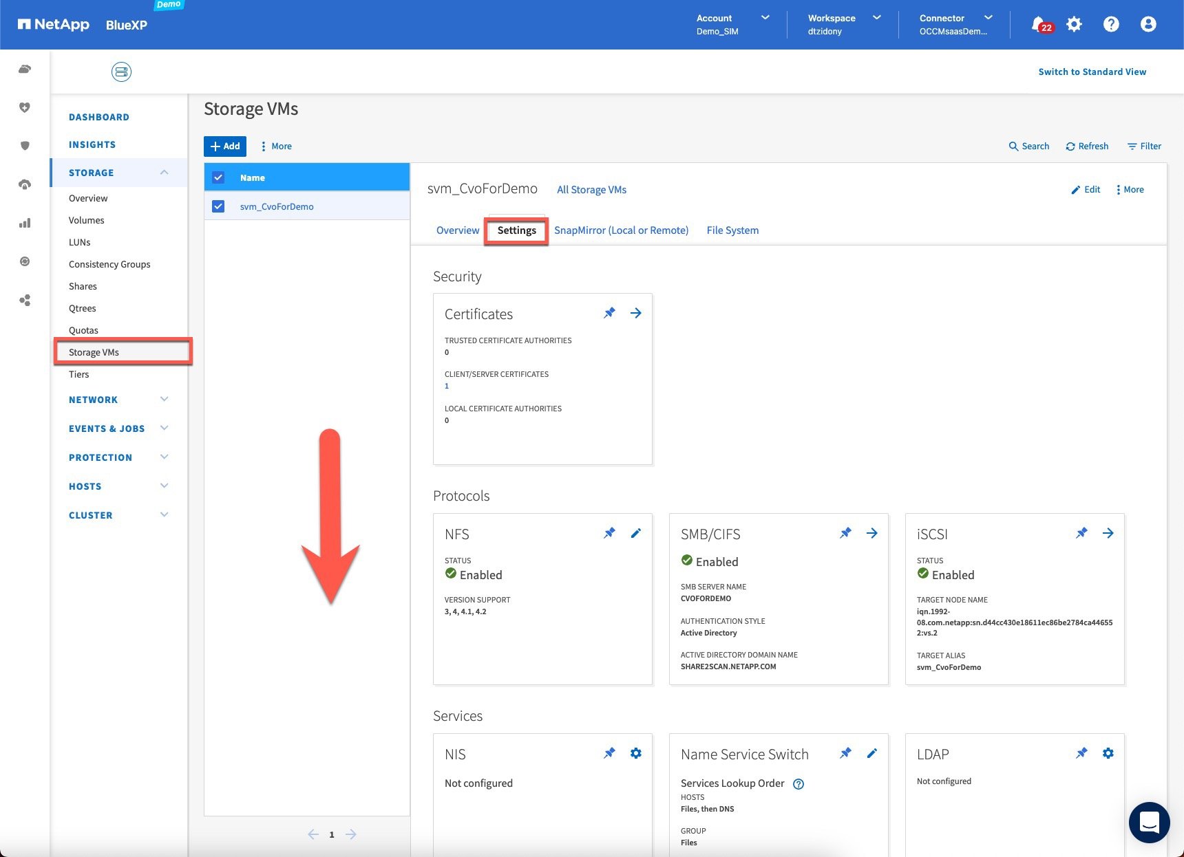

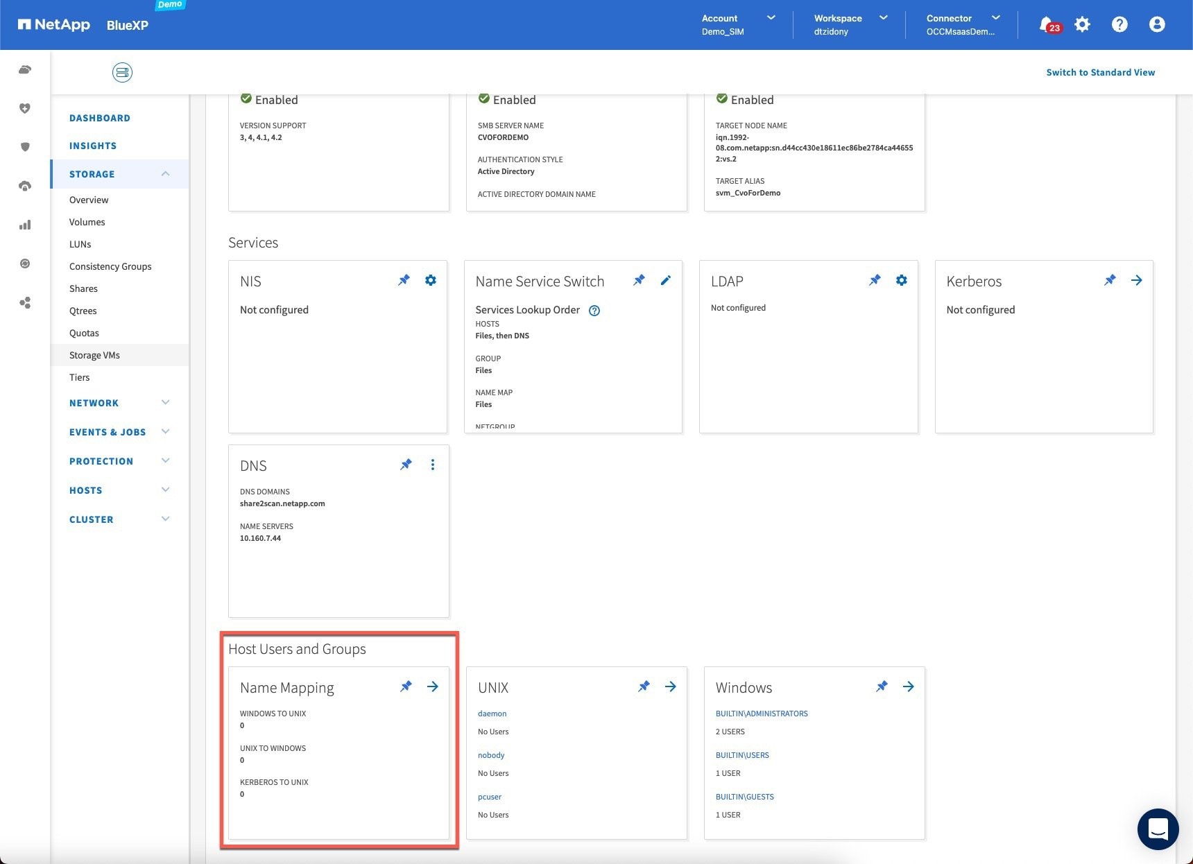

6. Now, expand the Storage menu option, then select “Storage VMs” from the list.
Go to the Setting tab and scroll down until you see the Host Users and Groups widget.
CVO613.19
7. In the Host Users and Groups widget, select “Name Mapping.”
CVO613.20
8. The following screenshot shows an example conversion mapping from a Windows user to a UNIX user:
CVO613.21
