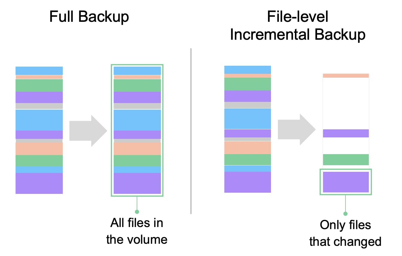

Problem #1: File-Level Backups Back Up Too Much
The amount of data that needs to be copied and moved from the data source to the backup destination varies significantly depending on the type of backup.
  • Full backups copy all the files in the volume
  • File-level incremental backups copy files that have changed since they were last backed up
Screen Shot 2021-04-26 at 20_40_57-1-1
The issue with the file-level backup method is that copying over entire files will inevitably copy over more data than has been changed since the last backup has been created. For example, if a 1 TB file contains 3 KBs that have changed, the entire 1 TB file needs to be copied over.
Backing up entire files like this takes time and puts a lot of stress on the network. The more time it takes to create a backup, the more likely that changes to the live copy won’t make it over to the current backup. That means data loss, a red flag for effective backup systems.

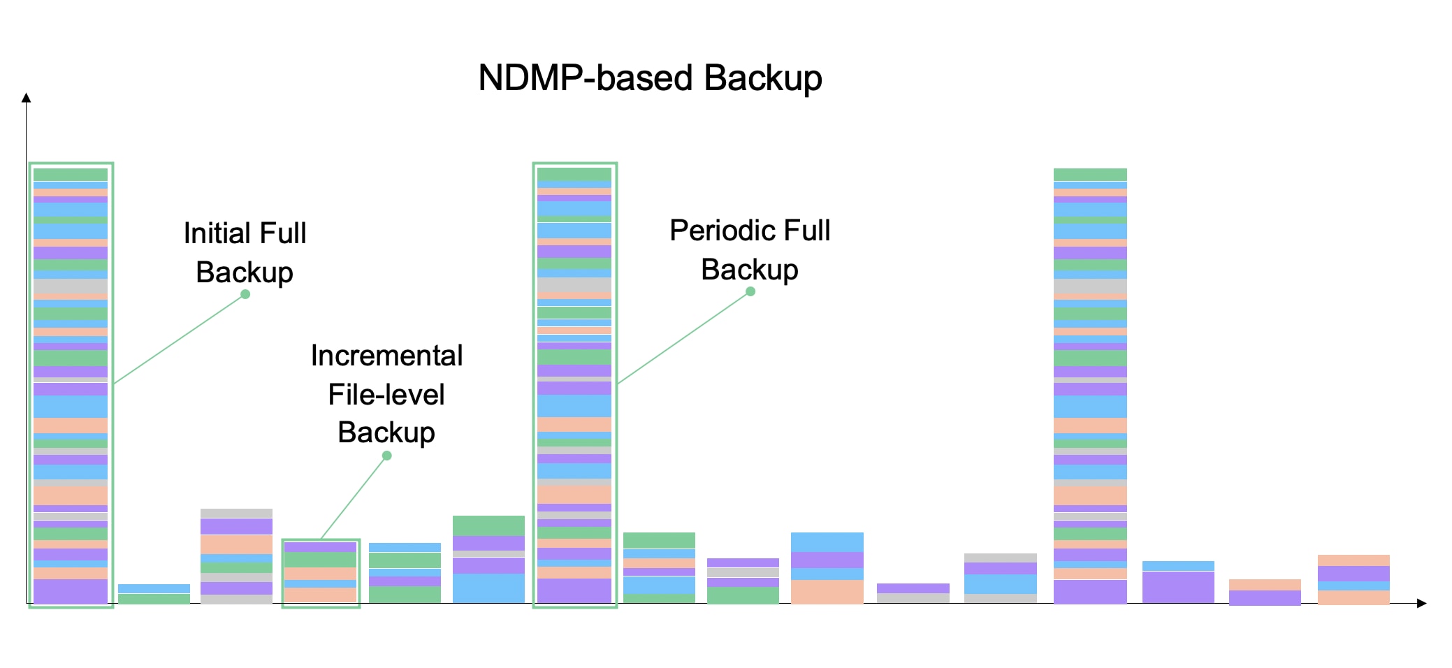

Problem #2: Incremental File-Level Backups Aren’t Incremental Forever
Traditional NDMP-based backup solutions can only perform up to nine consecutive incremental backups. After that point, they need to create an entirely new full backup copy. That’s a time-consuming and costly task.
Typically, these systems are configured to perform five daily backups followed by a full backup over the weekend.
But for businesses that operate 24/7/365, the weekend may not offer the luxury to pause the system while that full backup is created. That means there will be some significant data loss between the primary and the copy.

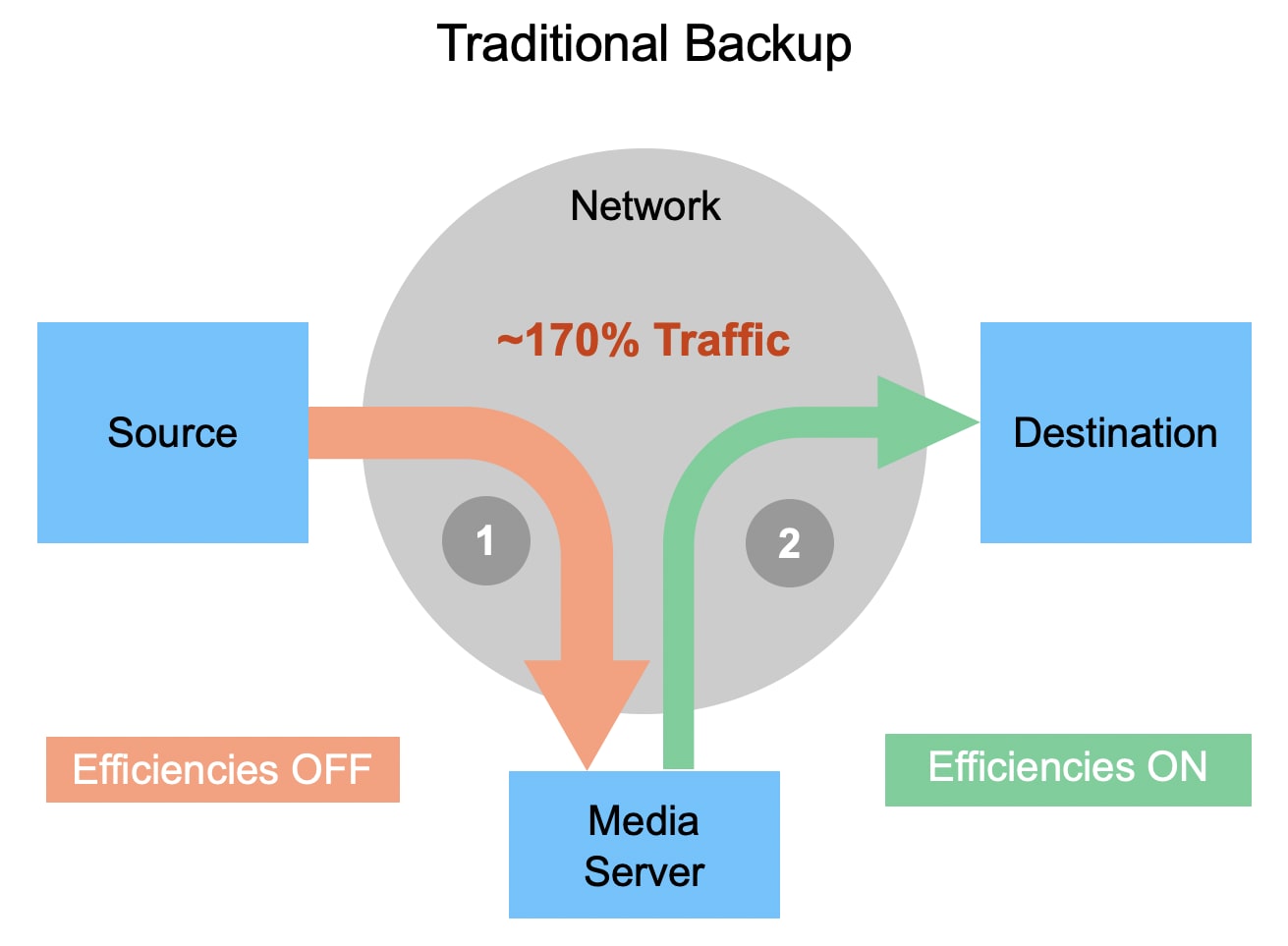

Problem #3: File-Level Backups Don’t Back Up Directly
Since NDMP-based file-level backups can’t directly access the cloud, they leverage mediators to get the data from your ONTAP system to the storage repository.
Screen Shot 2021-04-26 at 20_41_21-1
NDMP-based solutions first transfer data from the backup source to the media server in its raw format without storage efficiencies (deduplication and compression). Then it is moved from the media server to the backup destination.
There are a number of issues with the use of media gateways:
  • The data is insecure. Since media gateways have to open files up as they move them between the source and destination, the data can’t be encrypted. That makes transferring through media gateways a major security concern.
  • Storage efficiencies are lost. This time without the storage efficiencies. That means that your backup copy is now consuming more storage space than the primary data set. Restoring your data from such copies, if ever necessary, means that you will also need to recreate all of the efficiencies.
  • Data is transferred twice. When backup copies are created your data has to make two jumps: once to the media gateway and once to the destination. This affects both the time it takes to safely back up systems and the stress put on your network.
  • It is a single point of failure. If the media gateway fails, your entire backup and restore system goes with it. For enterprise-grade business continuity, that is simply not an acceptable risk.
  • There is more hardware to maintain. Using a media gateway requires maintaining the entire infrastructure to support it. That means hosting dedicated hardware, with all the associated costs and overheads.

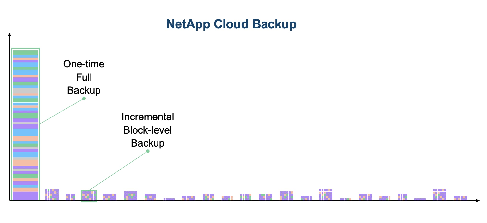

Cloud Backup is incremental forever.
Another unique advantage of using NetApp Cloud Backup is that after the one-time initial full backup is created, subsequent backups are incremental forever. This drastically minimizes the overall amount of data that needs to be transferred, contributing to its unmatched efficiency.
When there’s no need for periodic full backups, operations become much more efficient and there is less chance of missing a backup window.

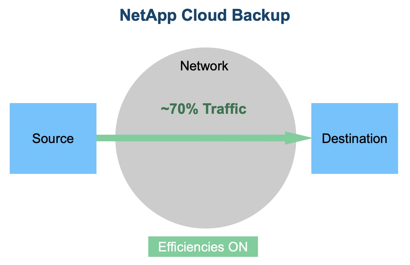

Cloud Backup creates backups directly.
Another operational advantage is that Cloud Backup backs up and restores directly from source to destination while preserving ONTAP storage efficiencies end-to-end. This is not the case for traditional backup solutions which require a media server in between the source and destination.
NetApp Cloud Backup moves data directly from the ONTAP source to the object storage destination while preserving all of the existing ONTAP storage efficiencies.
Screen Shot 2021-04-26 at 20_41_30-2
The advantages to directly backing up with Cloud Backup include:
  • Less network traffic ‚Äì By directly backing up from the source to the destination, Cloud Backup reduces network traffic to less than half the amount used by traditional solutions.
  • Enhanced security ‚Äì While media gateways open the files during the transfer process, they are not encrypted. Cloud Backup is more secure by keeping files encrypted end to end.
  • No single point of failure ‚Äì Since no media gateway is required, there isn’t a risk of a single point of failure in your backup system.
  • Lower overhead costs ‚Äì Directly backing up also removes the high overheads that come with careful sizing and operating additional infrastructure components.
