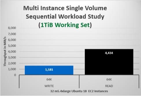

Sequential Scale Out Workload Study
Multi instance single volume sequential workload study (2GiB Working Set) and Multi instance single volume sequential workload study (1TiB Working Set)

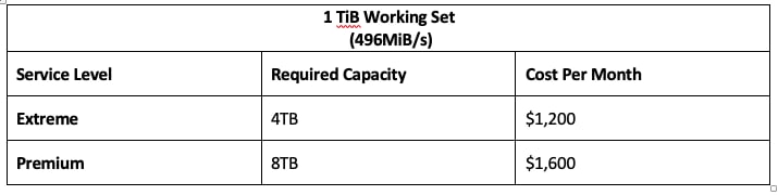

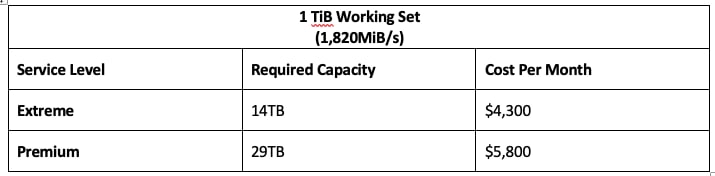

The following tables offer additional insight into the throughput detailed above. They indicate the service levels offered by NetApp Cloud Volumes Service, as well as the associated capacity and cost per month. In Cloud Volumes Service, users are able to dynamically increase or decrease service levels and allocated capacity as frequently as desired, meaning that the cost shown in the chart below will only be incurred if the capacity/service level is steadily maintained for an entire month. Thus, you can easily right size your performance at a fair price point.

1 TiB Working Set (1,820MiB/s)
4KiB Write Workload (812MiB/s)
1 TiB Working Set (496MiB/s)

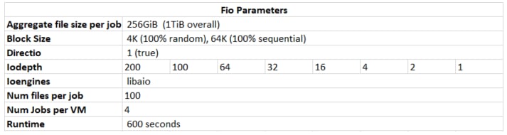

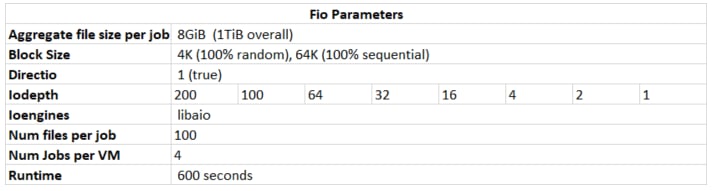

In our tests, we used the FIO load generator in addition to 32 m5.4xlarge virtual machines (for scale out) and 1 m5.24xlarge (for scale up). That allowed us to explore the amount of bandwidth available to a volume.
Our selection of the m5.4xlarge instance type was based on the 5Gbps of network bandwidth (burstable to 10Gib/s) available to the instance, the m5.24xlarge instance type was selected to demonstrate the additional bandwidth available by way of nconnect.
In each test, descending FIO iodepth values were selected {200,100,64,32,8,4,2,1} and the highest resulting figure selected for presentation.
Except for the average aggregate file size (8GiB scale out and 256GiB scale up), all FIO parameters were maintained during both scale out and up.  With four jobs per virtual machine in each test, 256GiB file sets (scale up) and 8GiB file sets (scale out), all tests used a 1TiB working set.
Note: Each section below includes a table documenting the FIO parameters used in each scenario.
