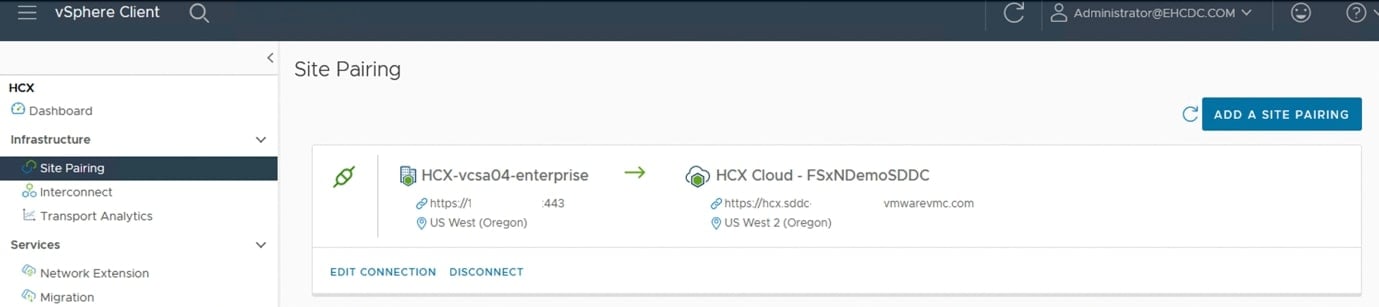

  4. Pair the on-premises VMware HCX Connector with VMware Cloud HCX Cloud Manager.

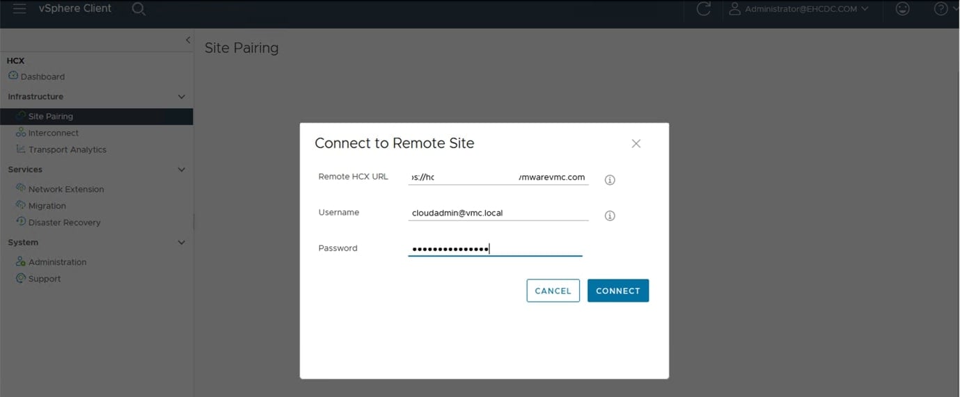

    1. Using the HCX dashboard, access Infrastructure > Site Pairs and click Add a Site pairing.
      Enter VMware Cloud SDDC HCX Manager as the target and click Connect.
fsx blg 4 a
  • With connectivity in place, pairing should be successful.
  • fsx blg 4 b

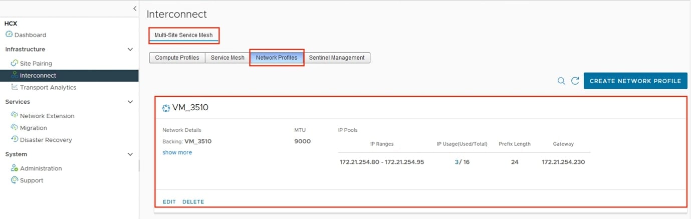

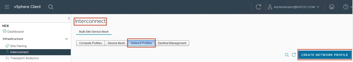

    1. Create the network profiles by selecting Multi-Site Service Mesh > Network Profiles, and then click Create Network Profile.
  • fsx blg 5 a
  • After configuration is complete, use the Network profile when creating the compute profile.
  • fsx blg 5 b

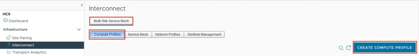

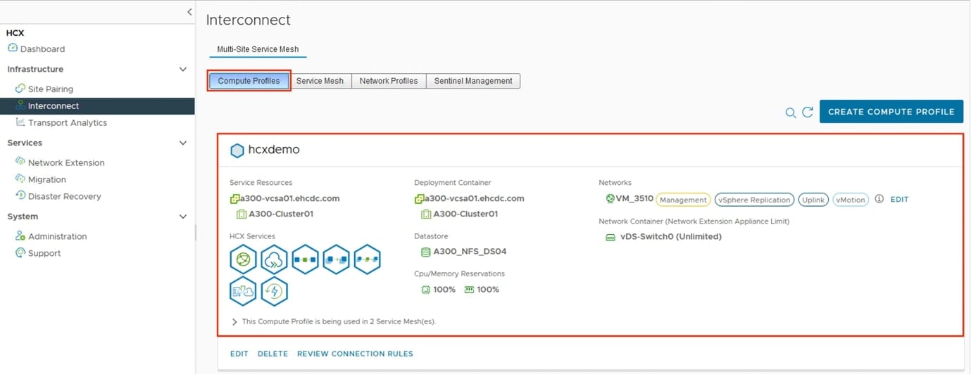

  • Now it’s time to create the compute profile. To do so, within Multi-Site Service Mesh, select Compute Profiles and click Create Compute Profile.
  • fsx blg 5 c
  • During the creation of compute profiles, the following elements—services, service cluster, deployment resource pool, deployment datastore, and networks (management, vMotion, and vSphere replication network)—are defined.
  • fsx blg 5 d

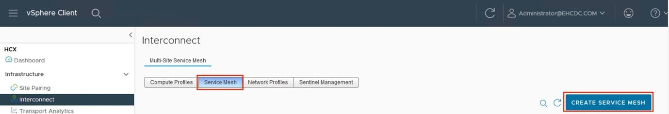

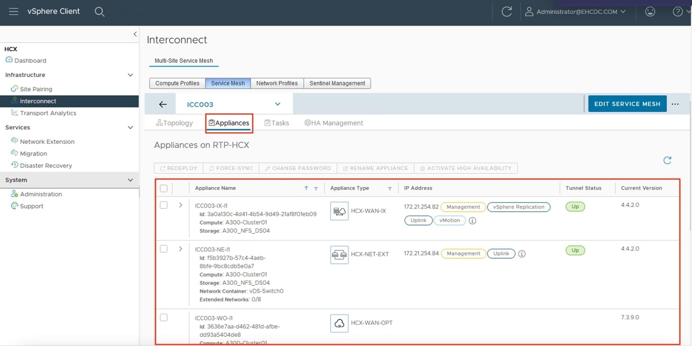

  • With Network and Compute profiles created, the next step is creating the Service Mesh by selecting the Service Mesh tab within the Interconnect option and selecting the on-premises and VMC SDDC sites.
  • fsx blg 5 e

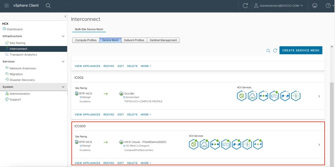

    The Service Mesh specifies a local and remote compute and network profile pair and as part of this process, the HCX appliances are deployed and automatically configured on both the source and target sites to create a secure transport fabric.
    fsx blg 5 f
  • Validate the appliance status and make sure that migration is possible.

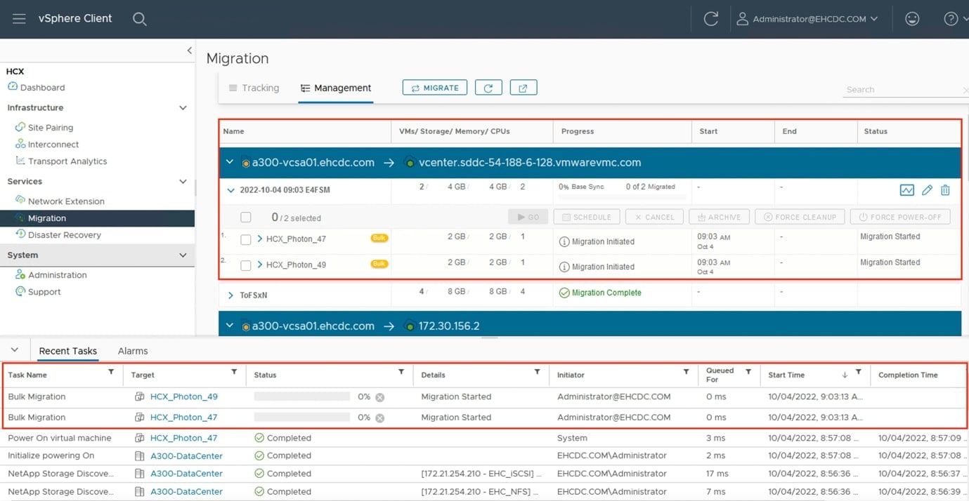

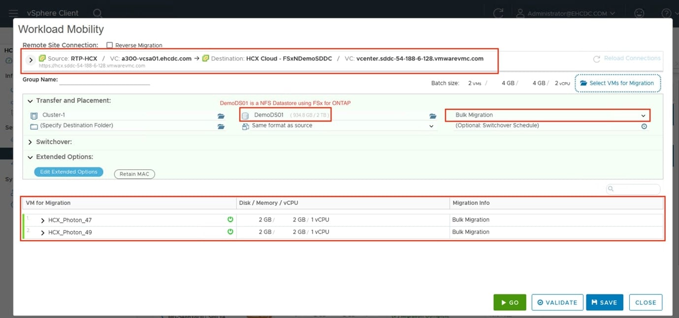

    The bulk migration capability of HCX uses vSphere Replication to migrate disk files while recreating the VM on the destination vSphere HCX instance. To initiate bulk VM migrations, complete the following steps:
    1. Access the Migrate tab under Services > Migration.
    2. Select the site connection and update Transfer and placement with the cluster, datastore, and migration profile and then click Validate after updating the target segment from a networking standpoint.
    fsx blg demonstrating bulk migration 2
  • After validation is complete, click Go to initiate the migration process.
  • fsx blg demonstrating bulk migration 3

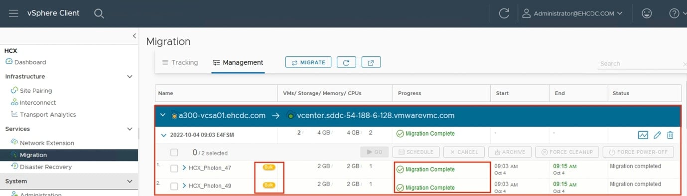

  • After the migration is complete based on the schedule switchover, the VMs are ready to roll.
  • fsx blg demonstrating bulk migration 4
