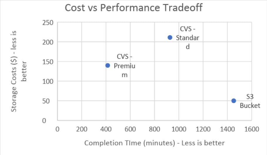

Cloud Storage Has Cost and Performance Tradeoffs
Object storage, such as Amazon S3, is massively scalable and durable for maintaining a large data lake. Compared to higher-performance storage like AWS EBS block storage, Amazon S3 can be extremely cost effective to store large data sets. With the known performance tradeoff that data is much slower to access, it is often used as a cold-storage tier, with working set data moved into a higher-performing primary storage to complete jobs more quickly. But Amazon S3 can also be used as primary storage, with many cloud analytics applications designed to be able to consume working set directly from object storage. Many users are OK with taking longer to get results, in exchange for the lower storage costs of $0.01-0.02 per GB per month.
My colleague Chad Morgenstern recently conducted tests on a large analytics job in AWS. The Hadoop Spark cluster involved 74TB of data running across 420 concurrent container instances. It took about 24 hours to complete the job, but the cost to store that working set data in Amazon S3 at the Standard Access Tier was a modest $50 for the duration.
Cloud Volumes Service gives you both cost and performanceNext, we tried running the same job using NetApp Cloud Volumes Service. Cloud Volumes Service is a durable, performant file-based data service available for AWS, and it offers three service levels – Standard, Premium, and Extreme, which provide increasing performance tiered with the storage costs. In this case, we tested the Standard and Premium levels, the Standard level provides up to 1400 MB/sec of throughput for this data set, while the Premium level provides over 3000 MB/sec, but at twice the cost - $0.10/GB/month for Standard vs $0.20/GB/month for premium.
Both service levels offered much better performance than using object storage, allowing you to complete the Hadoop Spark job 1.5 to 3.5X faster than using Amazon S3. The storage cost for the working set was $139 for Premium and $211 for Standard – the Premium actually ends up cheaper for the duration of the job, since it finishes more quickly. Nominally, Cloud Volumes Service gives you better performance, but at a 3-4X higher cost than Amazon S3. So, again it appears to be a typical cost vs performance tradeoff.

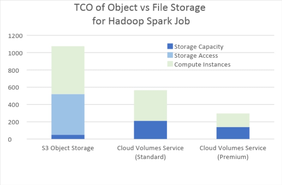

Compute: The REAL Hidden Cost of Slow Storage
Now, I’ve had more than one customer tell me already ‚Äì “forget about saving a few bucks on storage costs, what really kills me is compute costs.” High compute costs factored in can ultimately make it cost-prohibitive to move some workloads to the cloud. Therein lies an even more insidious hidden cost of slower storage ‚Äì you really need to consider the TCO of your entire application workload, particularly the impact of slow storage driving up your compute costs.
The great thing about this new era of transient containers is you only to keep your compute running for the duration of the job. In this analytics job, we used CentOS which qualified for per-second billing, and we needed a cluster of 15 C5.9xlarge EC2 instances to run the 74 Hadoop Spark container instances.
Since using Amazon S3 for storage took a lot longer to finish the job, the EC2 compute costs ended up at $555 for this job, whereas Cloud Volumes Service was able to feed the EC2 instances faster to complete the job more quickly – resulting in compute costs of only $158 to $354.
TCO of object vs file storage
So, Cloud Volumes Service can further save additional TCO for your compute as well. The overall lowest cost option for this job actually ends up being the fastest - Cloud Volumes Service at the Premium tier. Although the Premium tier costs more in storage costs than the Standard tier, by completing the job much more quickly, the EC2 savings on compute leads to an overall cost about 25% less than using the Standard tier, and a whopping 70% cheaper than using Amazon S3!
