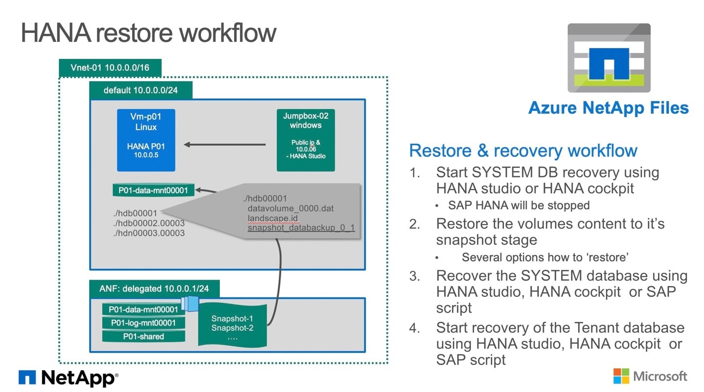

Restoring an SAP HANA Multi Database Container (MDC) database is best explained with a picture of the restore process in our lab setup.
An SAP HANA MDC database can be installed on a single host (scale up) or in a multiple-host setup (scale out). It contains a SYSTEM database and one or more tenant databases. For a full restore and recovery, the SAP HANA database must be stopped. After the file structure has been restored, the SYSTEM database needs to be recovered first, followed by recovery of each existing tenant.

This video, Snapshot-Based Restore for SAP HANA with Azure NetApp Files, shows the complete restore workflow, including the recovery procedure using SAP HANA Studio. The script we’re using automates a copy on host-based restore.
