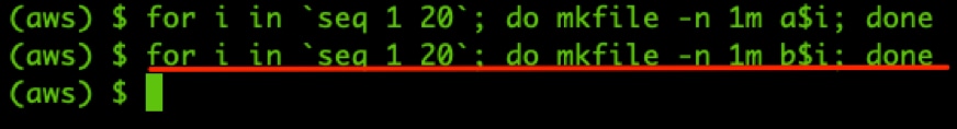

1. Using the command: for i in `seq 1 20`; do mkfile -n 1m a$i; done we are able to generate 20 unique files of 1 MB each named a[1..20]. With the same process, we also generate b[1..20]. This enabled us to generate two datasets of 20 MB each to a grand total of 40 MB.
Generate test files
Generate test files: a[1-20] and, b[1-20].

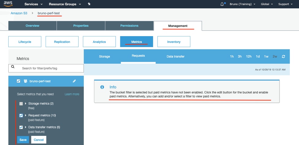

3. We can finish the preparation process by enabling additional metrics such as Request and Data Transfer in the S3 bucket configuration. When enabling these metrics, keep in mind that it might take several minutes until they appear visible in the dashboard.
Enabling the request and Data transferEnable the Request and Data transfer metrics in the AWS S3 bucket.

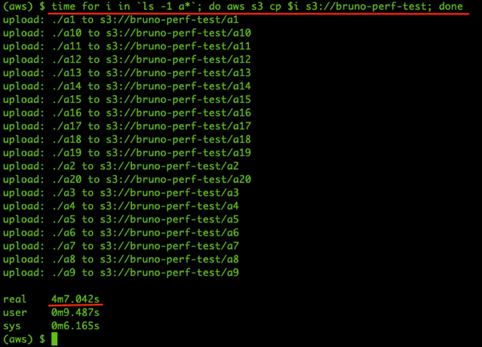

1. We start our test by uploading half of our dataset (i.e., 20 MB) to the S3 bucket. We want to be able to test the performance of making single requests putting data into the S3 bucket. To achieve that we will use the time for i in `ls -1 a*`; do aws s3 cp $i s3://bruno-perf-test; done command. This will iterate over each file and do single put requests to AWS S3.
AWS S3 bucketUpload the a[1-20] test files to AWS S3 bucket.
As you can see, by doing single requests, it took a bit over four minutes to upload each file.

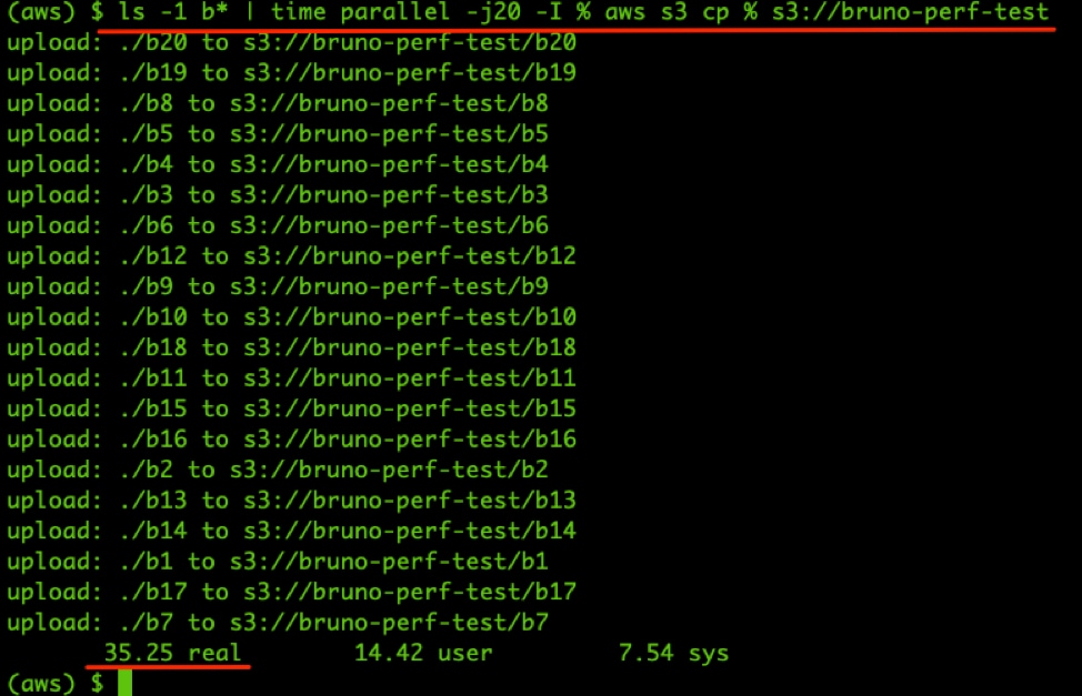

2. In the terminal, we initiate the upload of the files b[1..20] in parallel (20 jobs) using the command ls -1 b* | time parallel -j20 -I % aws s3 cp % s3://bruno-perf-test
AWS S3 bucket in parallel -1Upload the b[1-20] test files to AWS S3 bucket in parallel.
You should notice an immediate and visible performance increase. By parallelizing the upload requests, we are able to upload the dataset in 35 seconds.Visualize S3 Metrics as Part of the AWS Monitoring Services

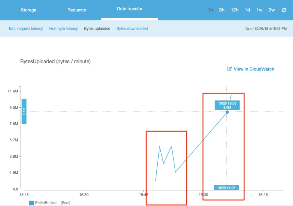

1. In AWS S3, go to the bucket configuration and under the Management section you will find the Metrics panel.
2. Explore the different dashboards related with Storage, Requests, and Data Transfer. Select the 1h in the time window (last hour) for a more comprehensive visualization.
BytesUploaded metrics graphVisualize the BytesUploaded metrics graph in the AWS S3 Metrics.

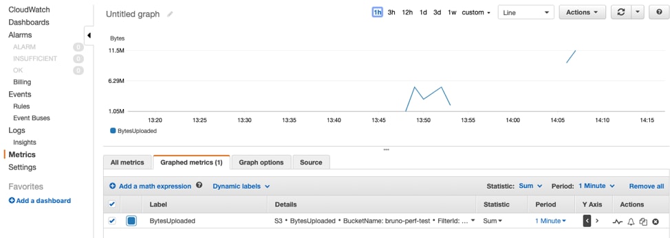

3. By clicking on “View on CloudWatch” you will be able to view those metrics in CloudWatch and build your own dashboards. This also enables you to properly monitor the performance of AWS S3, by leveraging CloudWatch-native capabilities (e.g. dashboards, metric aggregation, alerting, etc.).
AWS in CloudwatchVisualize the BytesUploaded metric graph in the AWS CloudWatch
