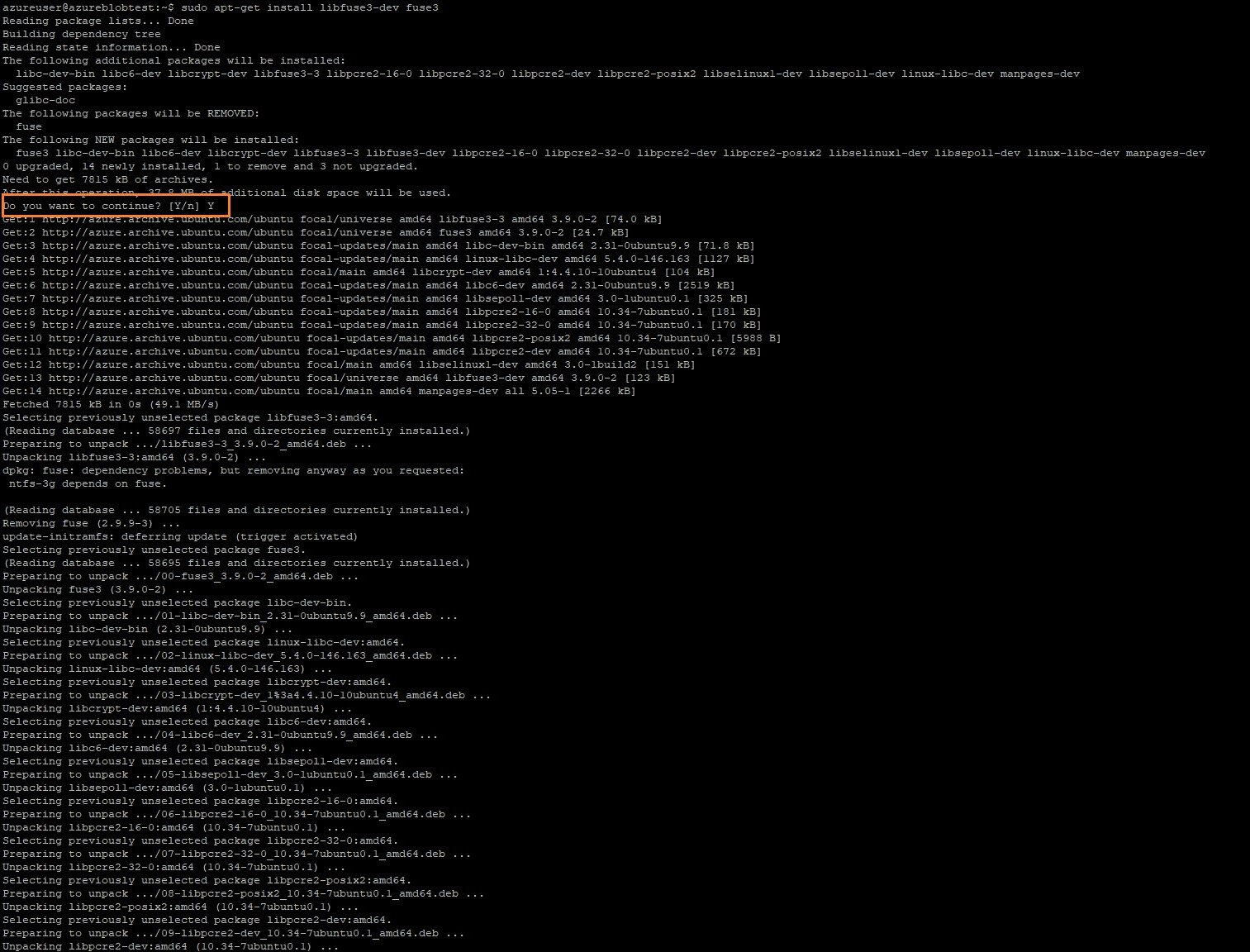

  1. Run the following commands to configure the Linux package repository for Microsoft products in the Ubuntu machine and install BlobFuse:
    wget https://packages.microsoft.com/config/ubuntu/20.04/packages-microsoft-prod.debsudo dpkg -i packages-microsoft-prod.debsudo apt-get updatesudo apt-get install libfuse3-dev fuse3
    Note: If prompted during the process to complete the installation and configuration, confirm by typing in “Y”.

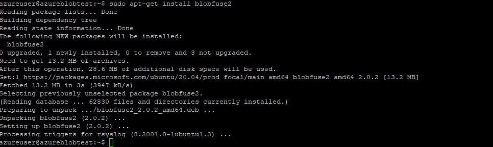

  • Install Blobfuse by running the following command:
    sudo  apt-get install blobfuse2

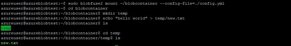

  • Mount the blob container to the folder created in step 4 using the following command:
    sudo blobfuse2 mount ~/blobcontainer --config-file=./config.yaml
  • Browse to the folder where the blob is mounted, i.e., ~/blobcontainer, and create a new folder and files. You can browse, access, and modify the files as you would normally do in any Linux file system:
    cd ~/blobcontainermkdir tempecho "hello world" > temp/new.txt

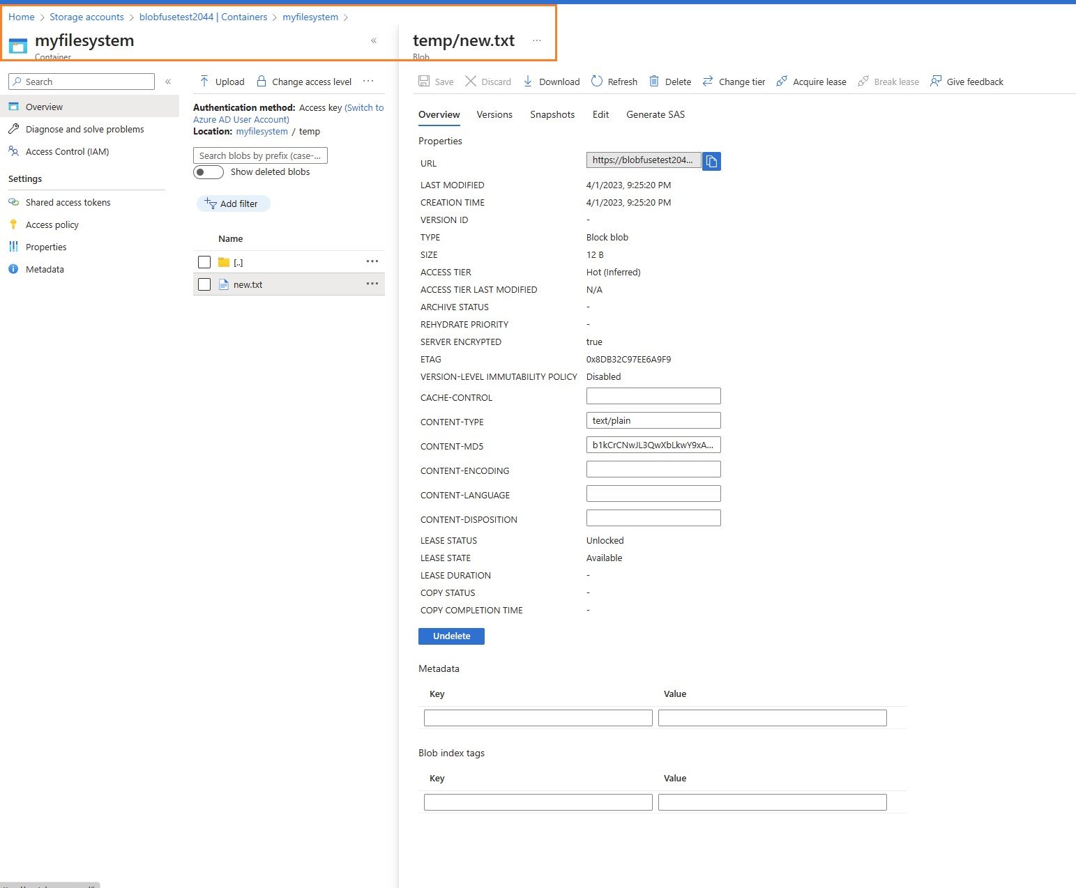

  • To confirm that the folder and file is created in the container that was mounted in the Linux machine, go to the Azure portal and access your storage account.
  • cvo 638 5
