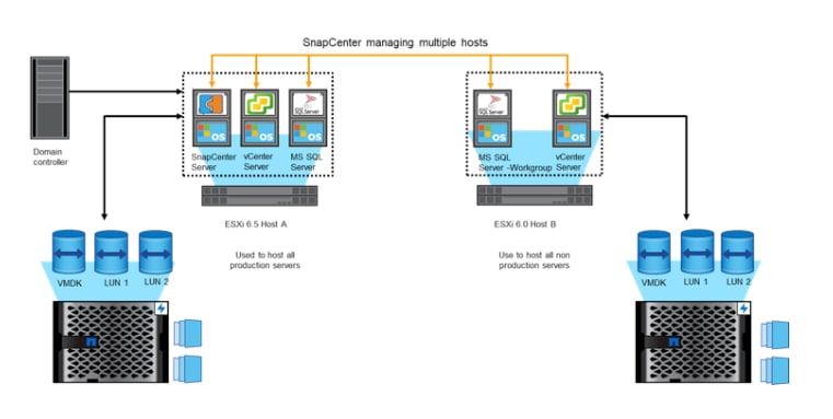

Let’s take an example with two separate ESXi hosts with the following setup:
  • Each host is managed by a separate vCenter Server. ESXi Host A consists of production VMs, and ESXi Host B consists of nonproduction and noncritical VMs.
  • Each ESXi server is connected to a separate storage controller to host Virtual Machine Disk (VMDK) files.
  • Production servers are part of the domain controller, and nonproduction servers run in a workgroup environment.
In this example, you add vCenter Server host and push SnapCenter Plug-In for VMware vSphere to vCenter Server. You also add SQL Server hosts by pushing SnapCenter Plug-In for Microsoft SQL Server.
With those few steps, a single SnapCenter Server instance can manage data protection of your resources on VMs across different vCenter Server instances. It’s that easy.

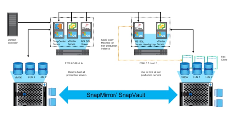

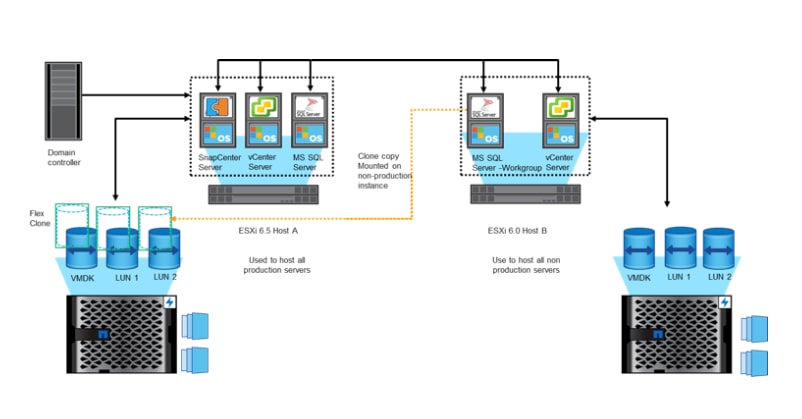

Following are two use cases that we tested. In case 1, cloning and restore are performed by using the NetApp Snapshot™ copy that is available on the primary controller. In case 2, a NetApp SnapMirror® or SnapVault® Snapshot copy on the secondary controller is used.
Case 1: Clone and restore a database by using the Snapshot copy on the primary controller.
Case 2: Clone and restore a database by using a SnapMirror or SnapVault Snapshot copy on the secondary controller.Both of our test scenarios succeeded and were supported. In our setup, the vCenter Server version varied. On Host A, we used vCenter Server 6.7, and on Host B, we used vCenter Server 6.5. The test was conducted with limited considerations, so it is a best practice to test the scenario before you implement it in a production instance.
